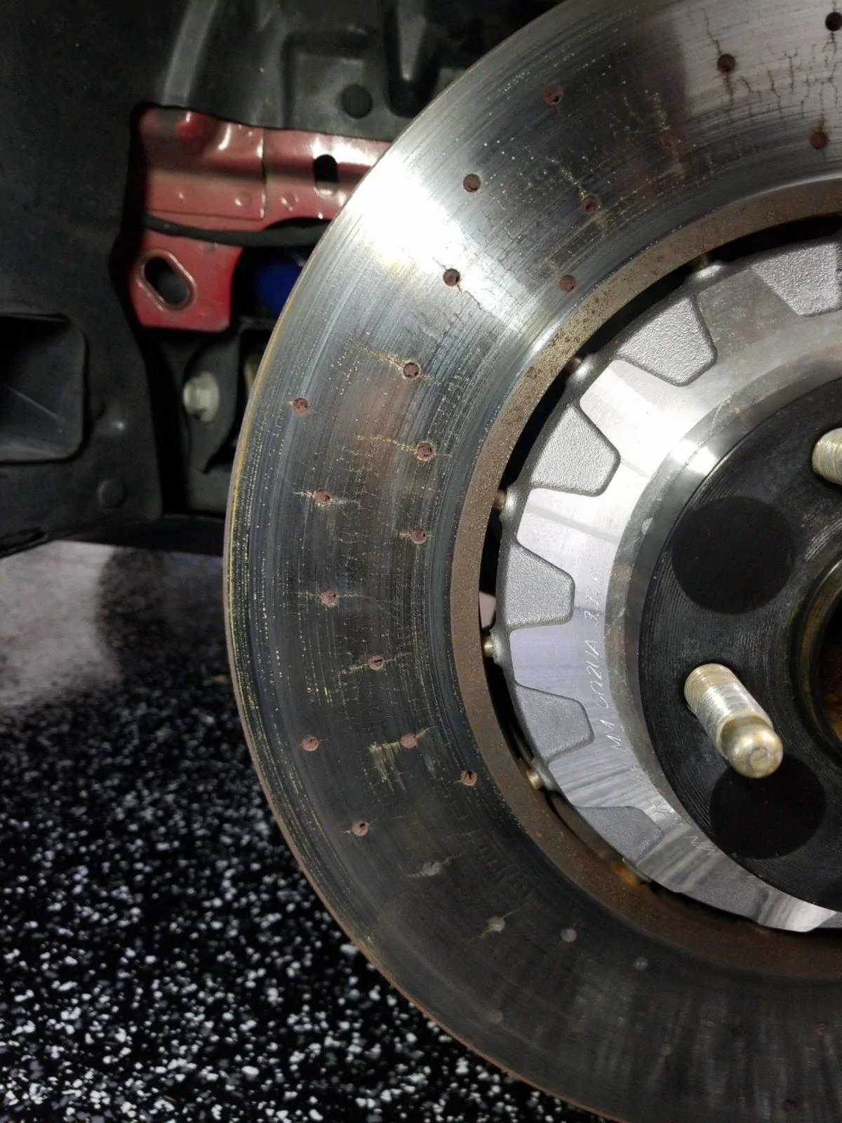

It should be on the rotor hat (measured in MM I believe). But unless you have an insane amount of street miles (north of 60K I'd guess), cracks will happen before they're EOL based on thickness. How're the cracks? If the cracks are connecting the drilled holes, time to change.
Here are mine for example, They're very close to EOL.
