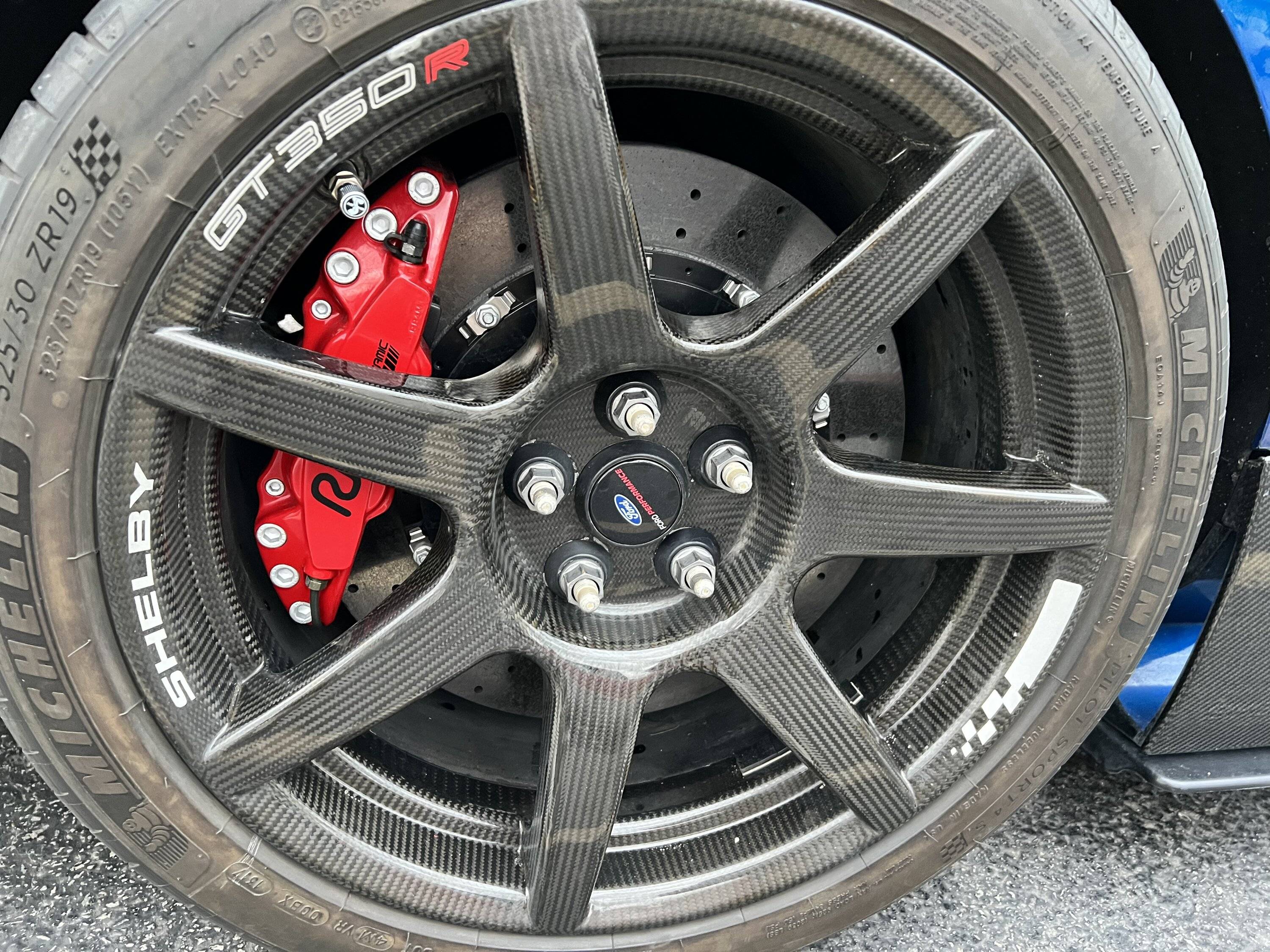

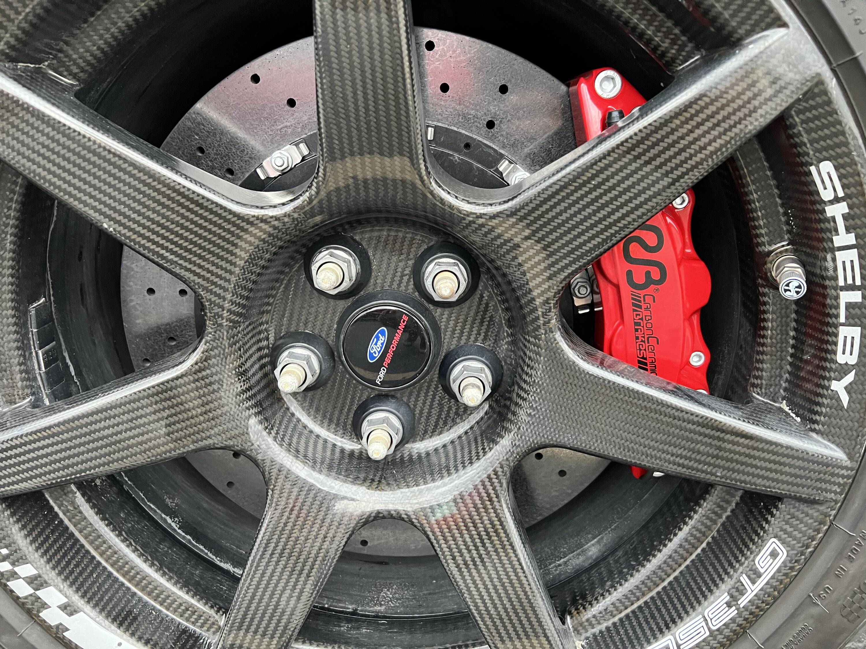

Installed - they fit thanks for the confidence - they didn’t send the banjo bolts so had to spend hours running around looking for one and then the second one - it’s a 10x1 met vs sae like fomoco - bedded and can’t wait to see how they power down from the 1/2 next weekend in Texas -
