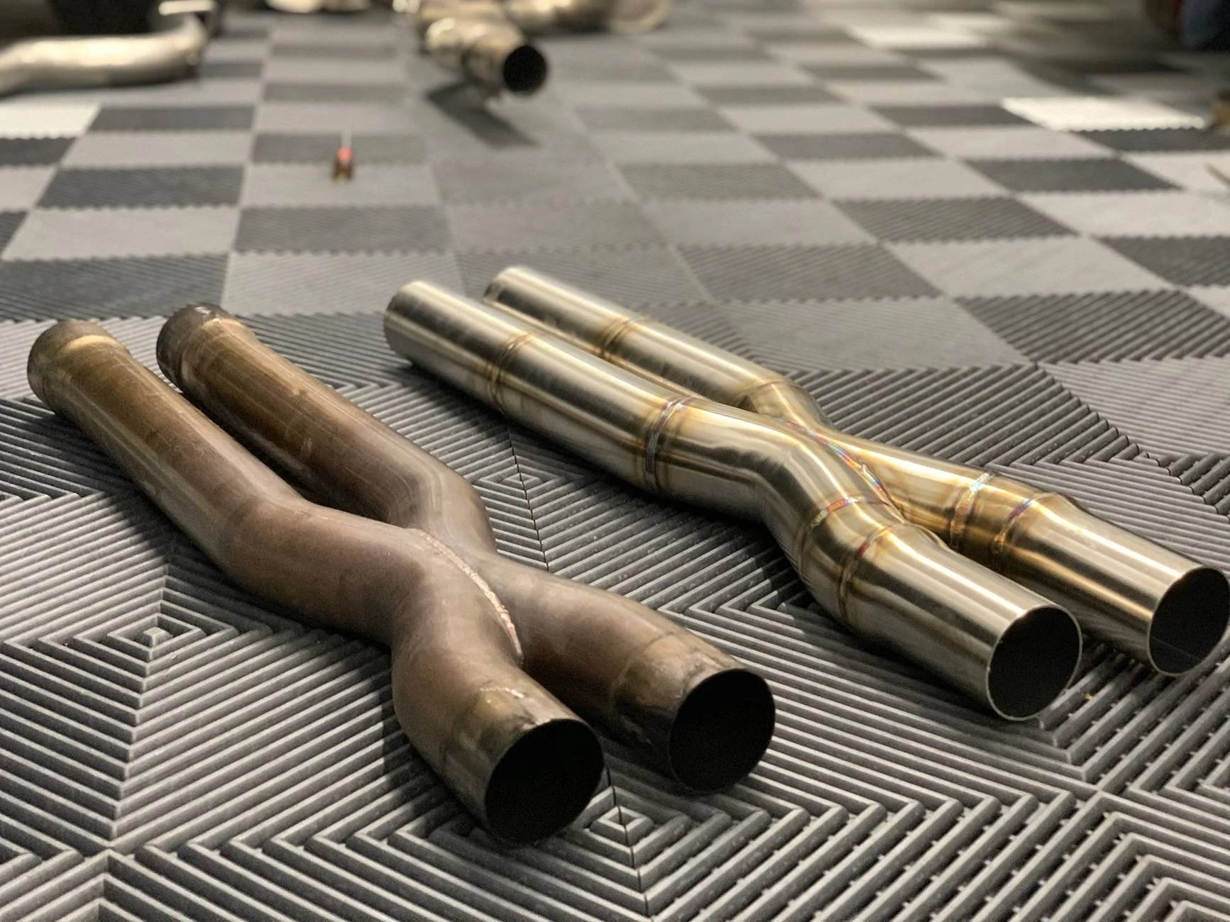

Correct, the factory True-X by design is restrictive and in my opinion is used for only two reasons;
1- Achieving a certain exhaust pitch
2- Sound attenuation
A Sweep-X or Size on Size H will flow a higher exhaust CFM vs. a True-X.

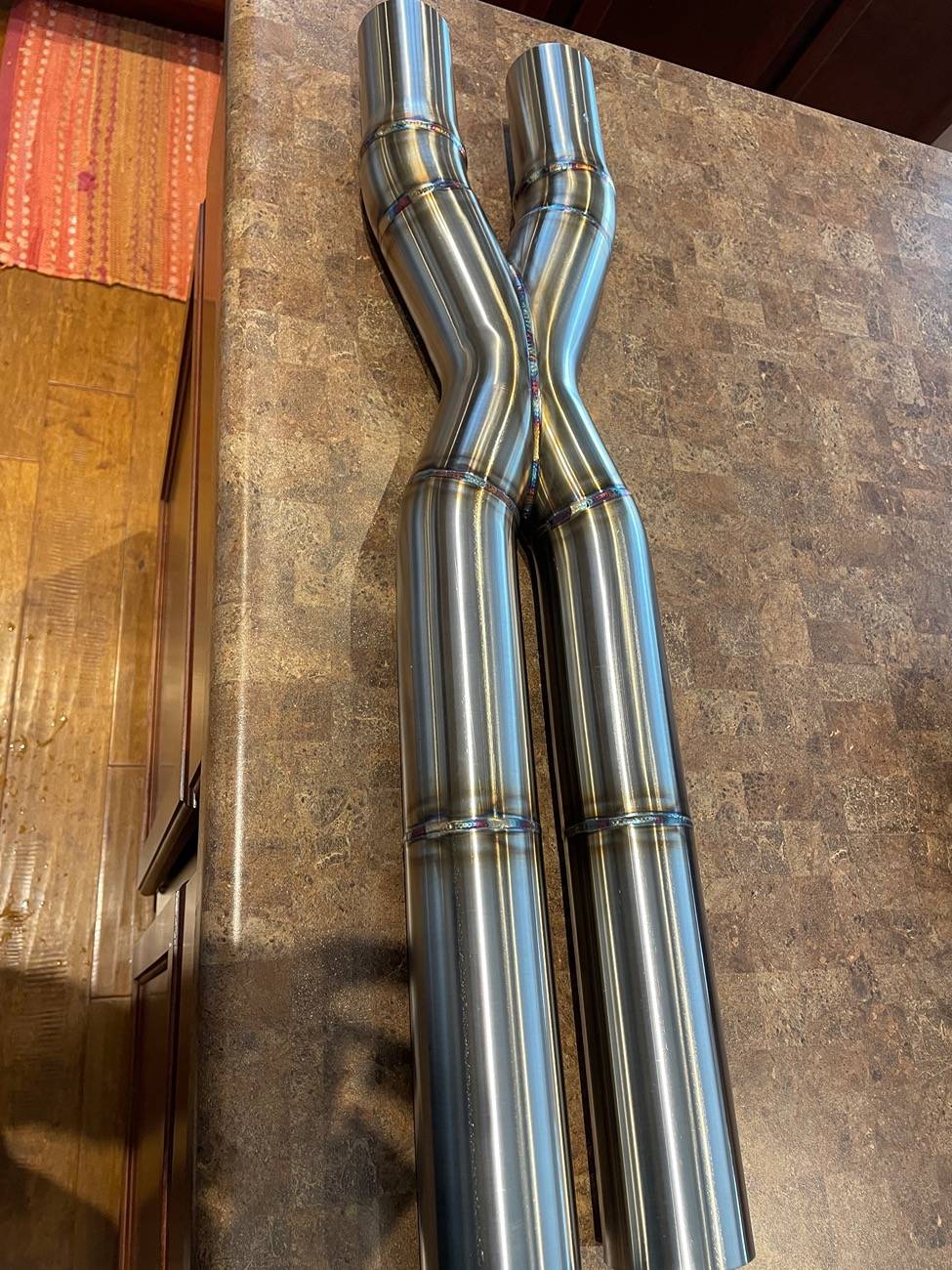

BLine, if they’ll still make one for you. Soo dang gorgeous, I didn’t want to put it on the car. (That’s the complete garbage Borla X I was replacing)
