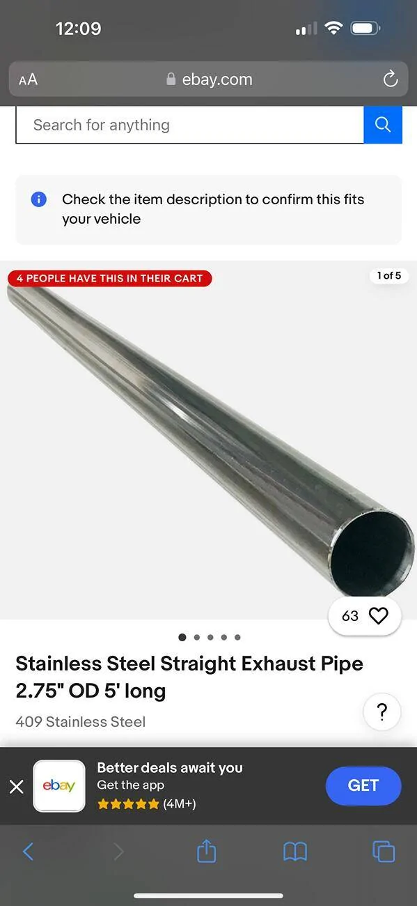

It looks like buying 2.75” 409 stainless pipe to replace the resonantors should get me closest to the R sound. Sound right to you guys?

Thats the route I’d like to take. Im an idiot when it comes to this stuff. Would this pipe work? Any exhaust clips?

Pipe will confuse most, you’re dealing with tubing. There is a huge difference between the two types.
Always reference Tube as the material. In your case 70mm/2.75” tube which is the actual outside diameter of the material. Stick to using .065” or .049” wall thickness which translates into 16 gauge or 18 gauge when using gauge as thickness.

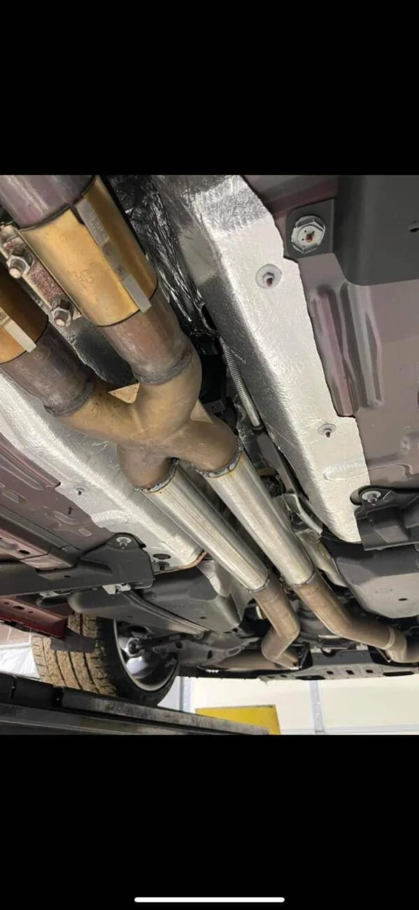

The two X pipes I posted are made specifically for the GT350, so they’re the correct outside diameter (the GT X pipes are 2.5” so don’t buy GT resonator deletes). One is 304 stainless and the other is 409. Easy cut and clamp, they can be welded on as well. Cost is pretty reasonable and most shops should be willing to install them. Some shops make their own as well, just verify what grade of stainless they use as well as what gauge.
