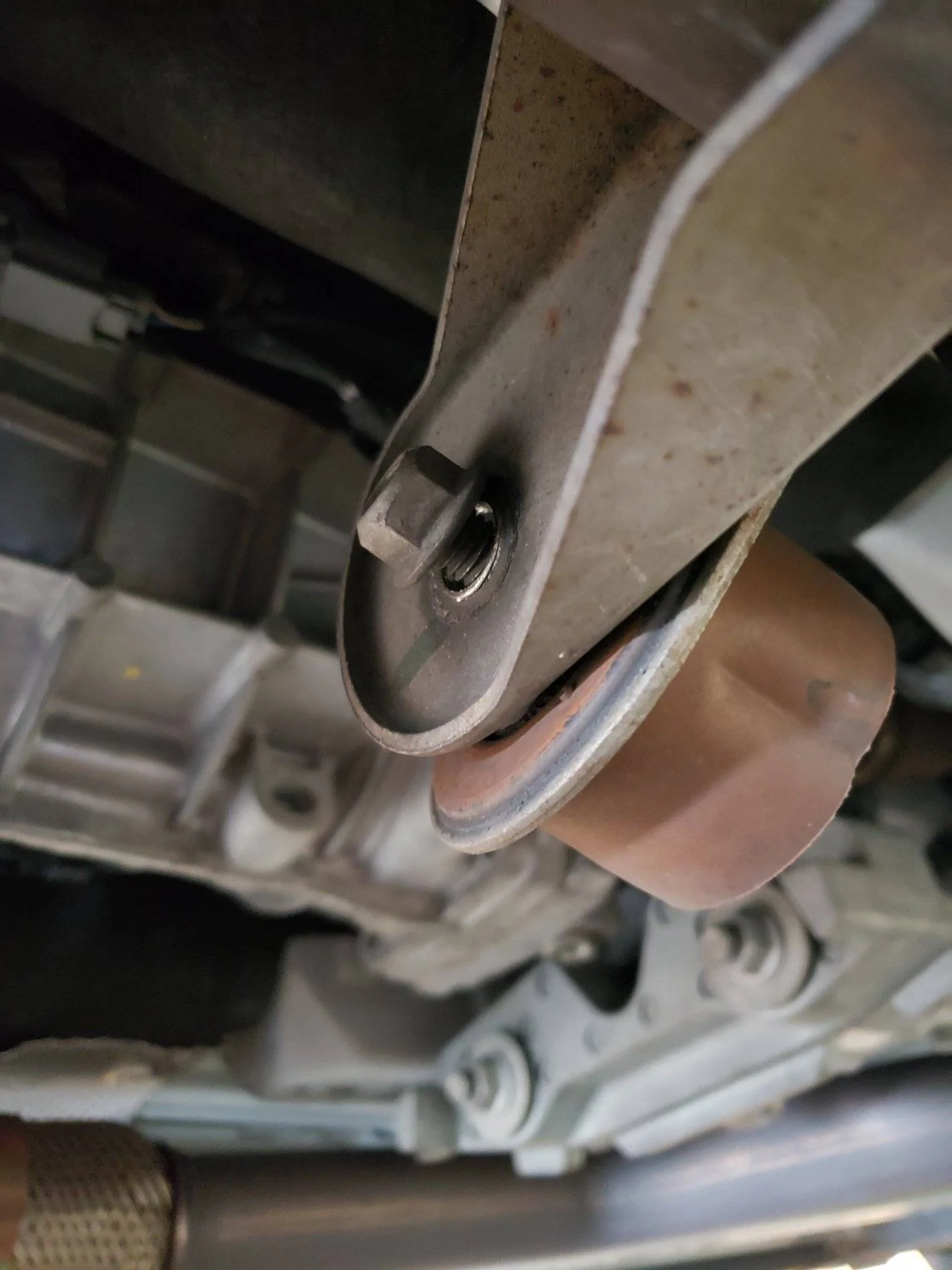

Got under the car while up at my parents place in Blue Ridge & found the problem in a few seconds. It was the loose counter weight on the catalytic converter assembly. At Autozone now picking up a couple supplies and should have confirmation shortly.
Btw... does anyone know the torque spec for this bolt? View attachment 502954 View attachment 502955
Dude!!! I was going to tell you to check that out but I couldn’t imagine with them swapping the exhaust that they didn’t catch that!
What a joke!

I’d take pictures of it, go back to dealer. No way in hell did they check that and not find it. I doubt they even looked under the car.

OP, I'm reading the service manual and the Catalytic Converter RH/LH only provide the below for torque specs:
1) clamp nuts.
Torque: 35 lb.ft (48 Nm)
That's all we get. Which in any of our cases, we'd have to put on our engineering hat on and decide how much torque do we safely think we could get by. I'd say 16-18 LB/FT since that's what the 2016 oil filter can handle (to your discretion). May be worth contacting Ford Performance and seeing if they can chime. I spent the last 30 minutes looking for the thread where I originally saw this problem to see if he had the torque specs for it but I couldn't find the thread.

Perhaps safety wire it. Take the nut off, get a 3/32 drill bit. Drill hole into nut then install and safety wire it. It won’t come loose again after that.
