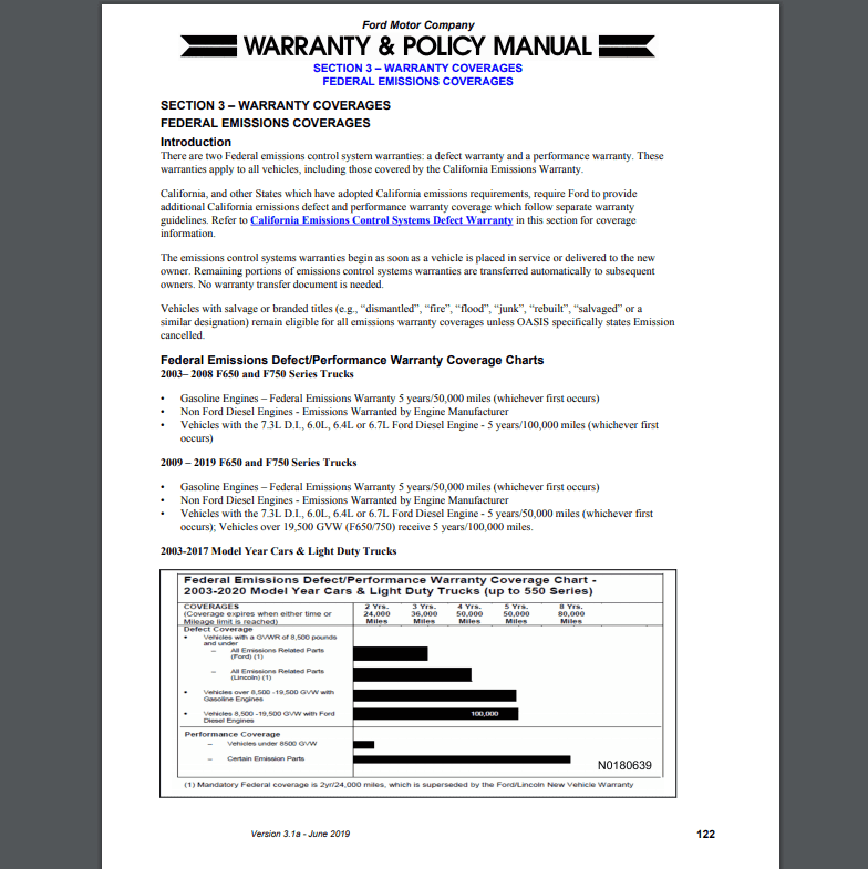

For those curious, here is your actual Emissions warranty. Got the car back today. Sun State Ford had it 2 weeks. I'm out $2 grand for the Ford Performance Borla catback. While it sounds great, it didn't fix shit. Car is still rattling away. Pissed off doesn't begin to describe I am about the situation. Is there not a garbage Ford Dealership in the metro Orlando area?
