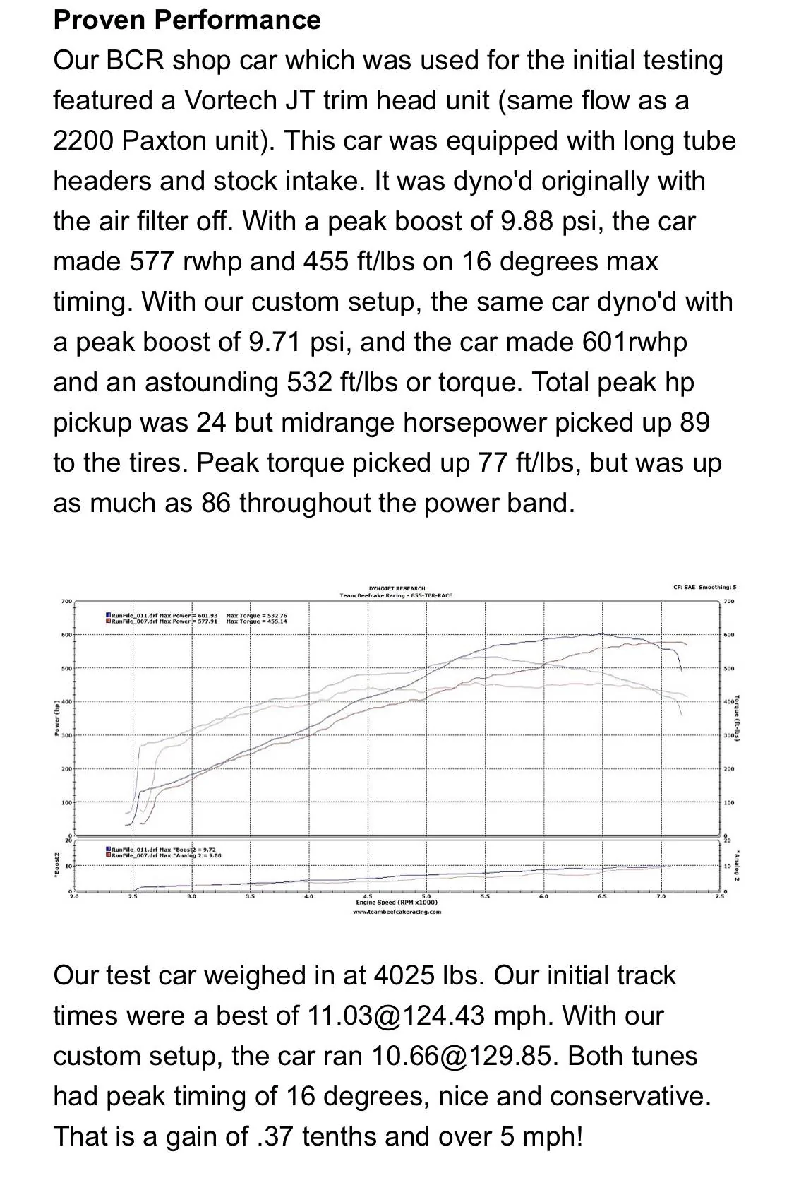

Seriously? A torque booster setup is not just a waistgate. You pulley down effectively changing the gear ratio. So if you are setup to run 20psi at redline. you will get to 10psi a lot sooner than if you are setup for 10psi at redline. This is what a torque booster setup is for. It will allow you to get to 10psi when you would have only been at around 6 normally. It is designed to make boost sooner. If you can make 10psi at 4000rpm and your opponent makes 6psi at 4000rpm. You don’t think you have a advantage?

that is the case. A TVS and Whipple make boost a lot sooner than a centrifugal. So they both make more power earlier in the rpms. That’s not theory it’s fact. But they are not as efficient in the higher rpms where a centrifugal really shines. So a TVS has the advantage off the line (if it hooks) over a centrifugal. So the centrifugal
Will play catch-up at first yes. but it will quickly even the odds

I’ll agree that’s probably the best option for 90% of centrifugal cars. I was just answering op question. And the only way I know of to get anything close to a tvs down low in the rpms with a centrifugal is to use a torque booster setup

While the concept does make sense, it does not necessarily translate into increased performance at the strip.
