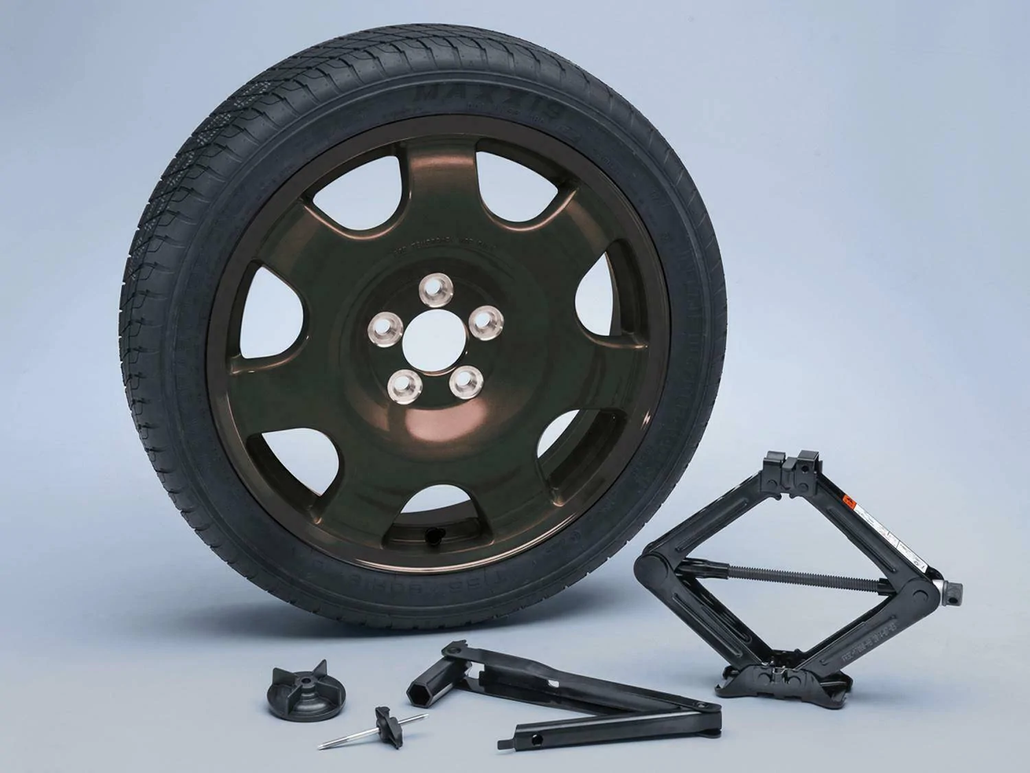

Instead of wasting money on that huge thing just buy a small impact driver. They are much more useful than that one-trick-pony Chinese jack. I've got a Dewalt 1/4" one that works great on the factory jack. Less expensive, takes up less space and an all around better option. I'm not 100% sure but it might even fit in the well under the spare.

Is the automotive authority kit the best or only option? Ordering it to Canada will be pricey.
It really is the only option if you have PP brakes and want a functional trunk.
I went the full size route, using a PP knockoff front wheel with a cheap Chinese eBay tire. Usable trunk be damned.
Yea, was thinking that too, but then I only really need it when I travel, when I also need the trunk. Guess I'll bite the bullet.

what about a 2020 mustang gt without pp1? is there a spare tire kit for it maybe cheaper?

There is a cheaper option to the AA spare. I used a spare wheel/tire assy from a 2015 Hyundai Equus. You do have to bore the center out to get it to fit. Other than that it fits our Mustangs with Brembo brakes just fine. My setup cost me $155.00 including the cost of getting a machine shop to enlarge the hub bore. The link below is to a write-up I did for mine.
