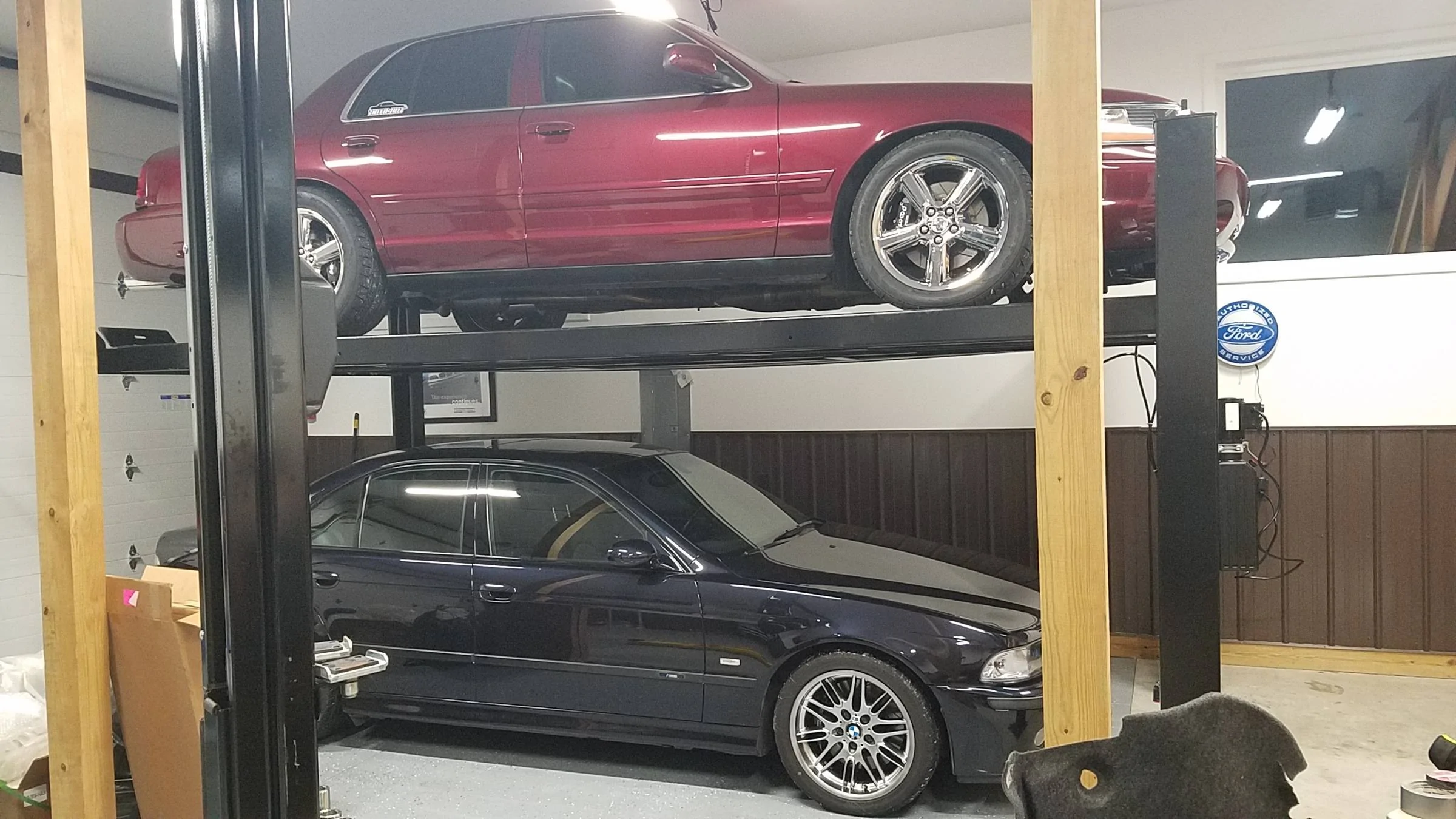

I think its around 98k miles, I haven't had it off the 4 post lift since 2020 but I'm getting it ready for Carlisle this summer. It has an eaton swap on the stock engine and a t-56 magnum, made 440 at the wheels IIRC. I have a MMR 5.0 sitting on an engine stand waiting to go in that I yanked from a marauder I parted out.

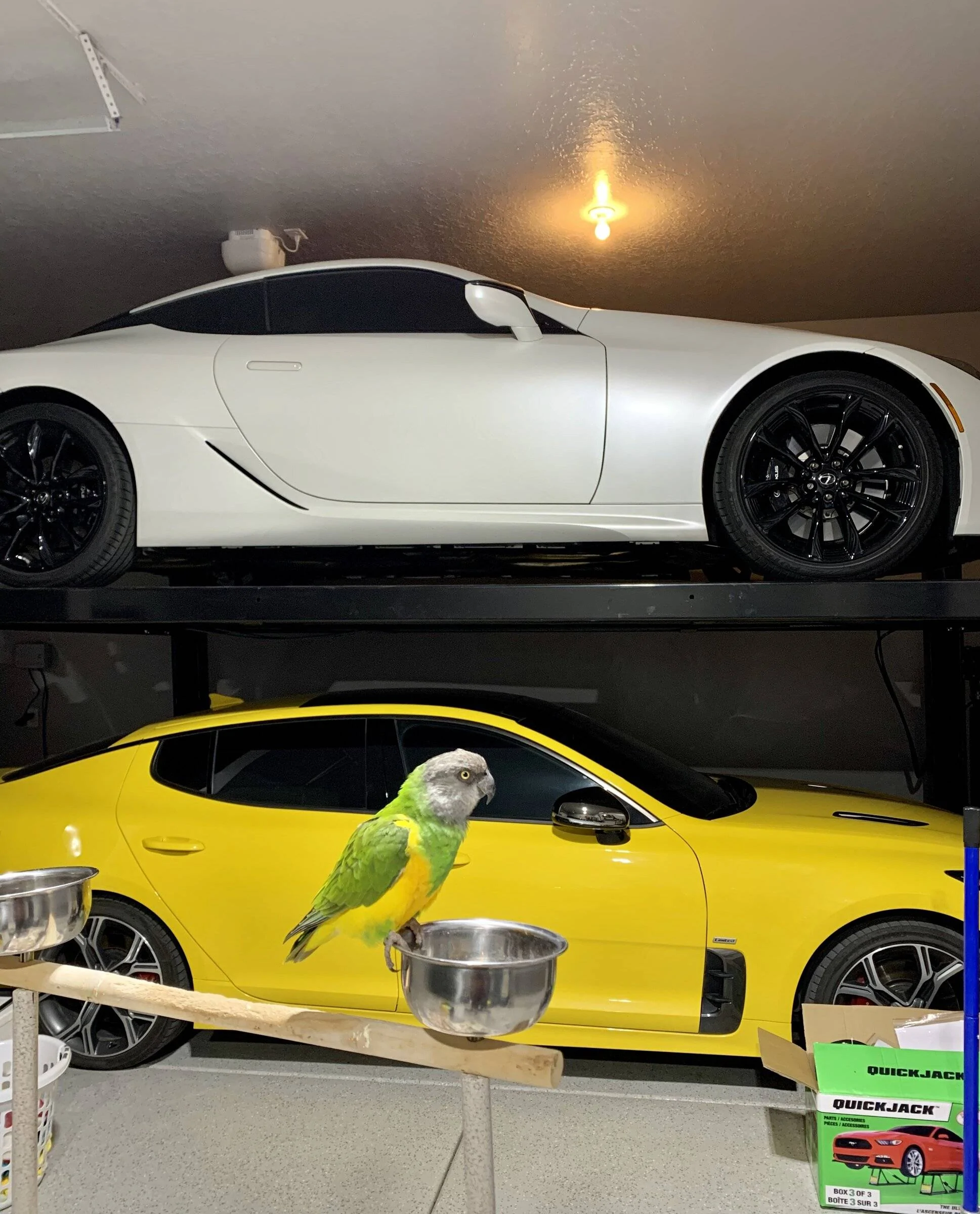

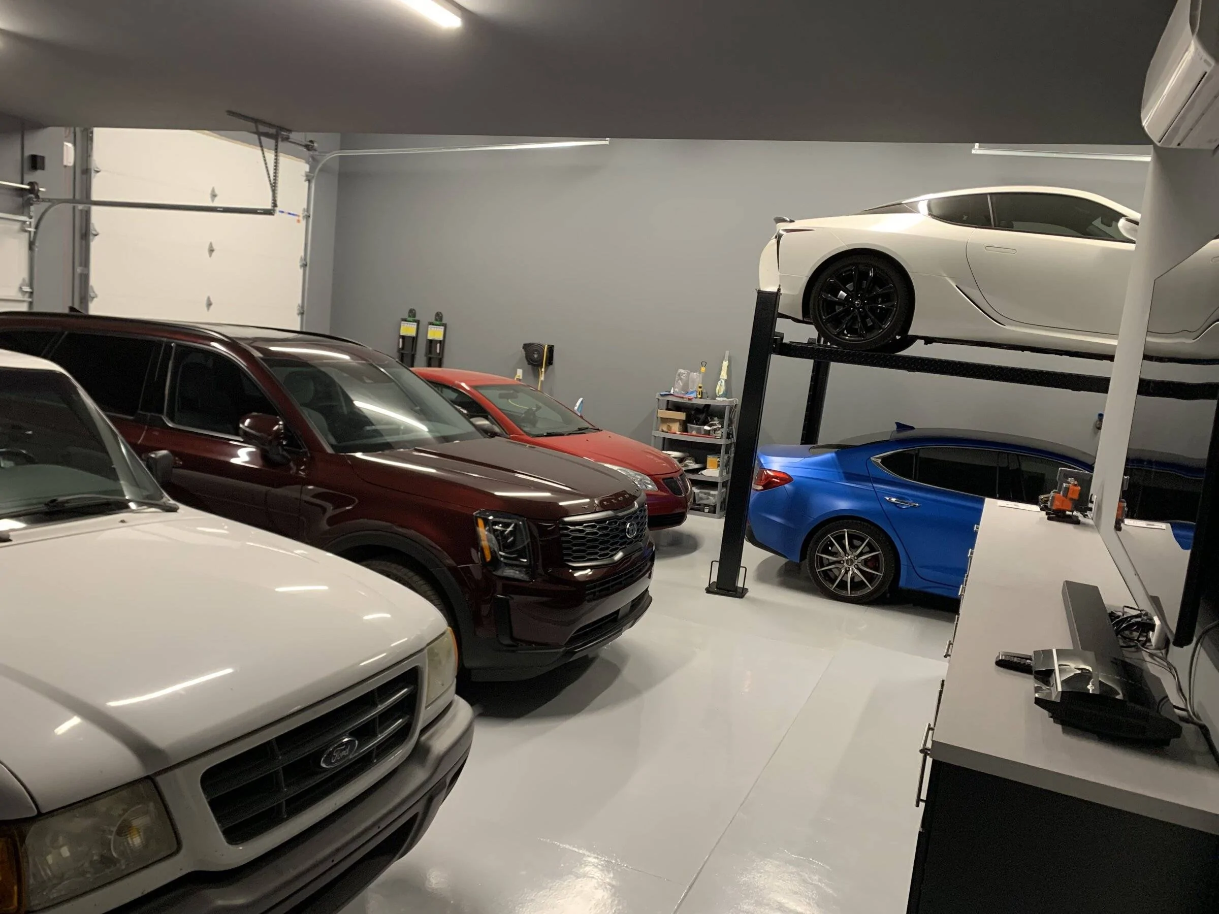

I had a Challenger lift at my last house and was able to stack two coupes/sedans pretty easily with a ceiling just under 12’ tall. I have a Champion lift now (that’s the only one I could locate during the worst of the COVID supply chain backup period) and got the oversized model because it’s in an RV garage now.

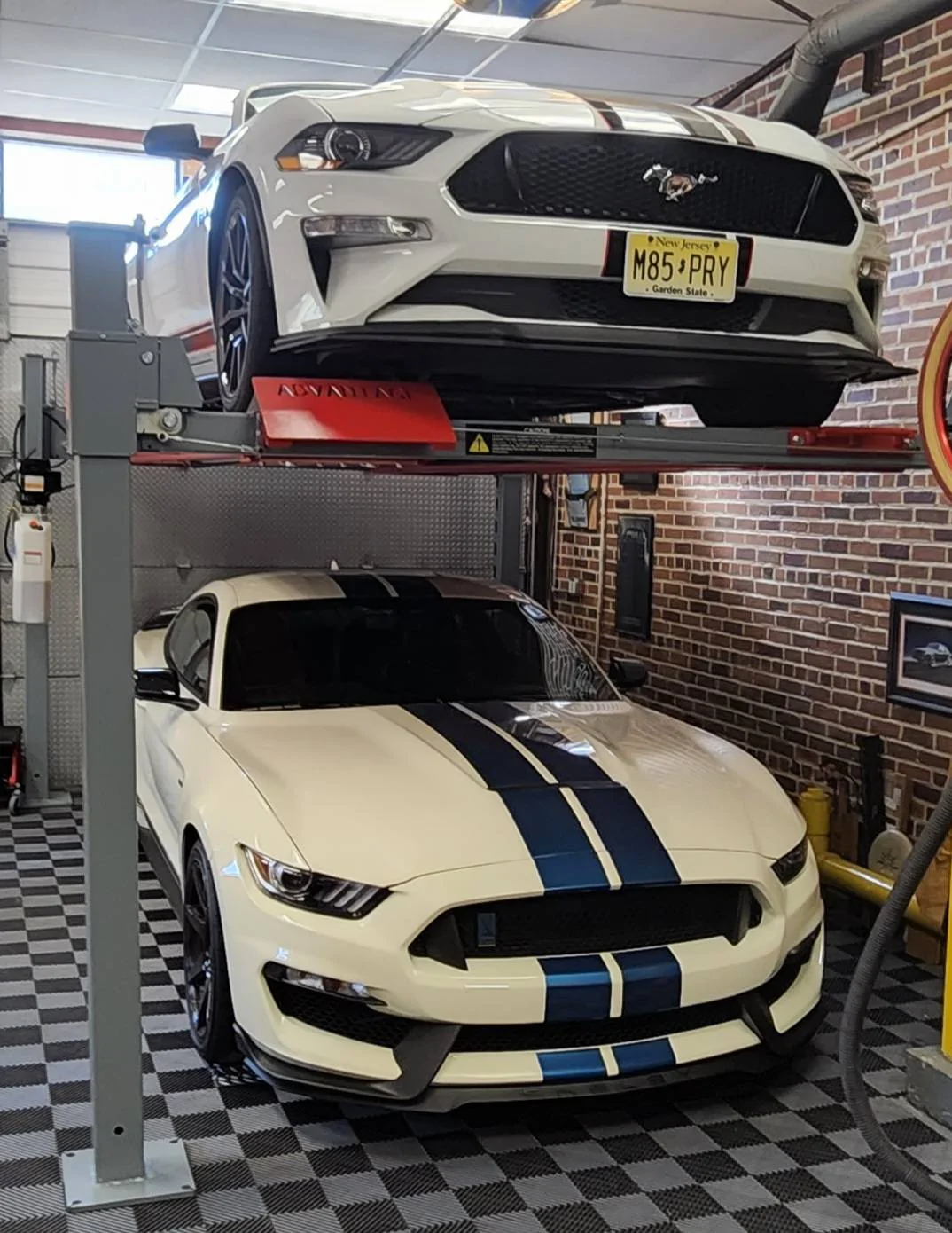

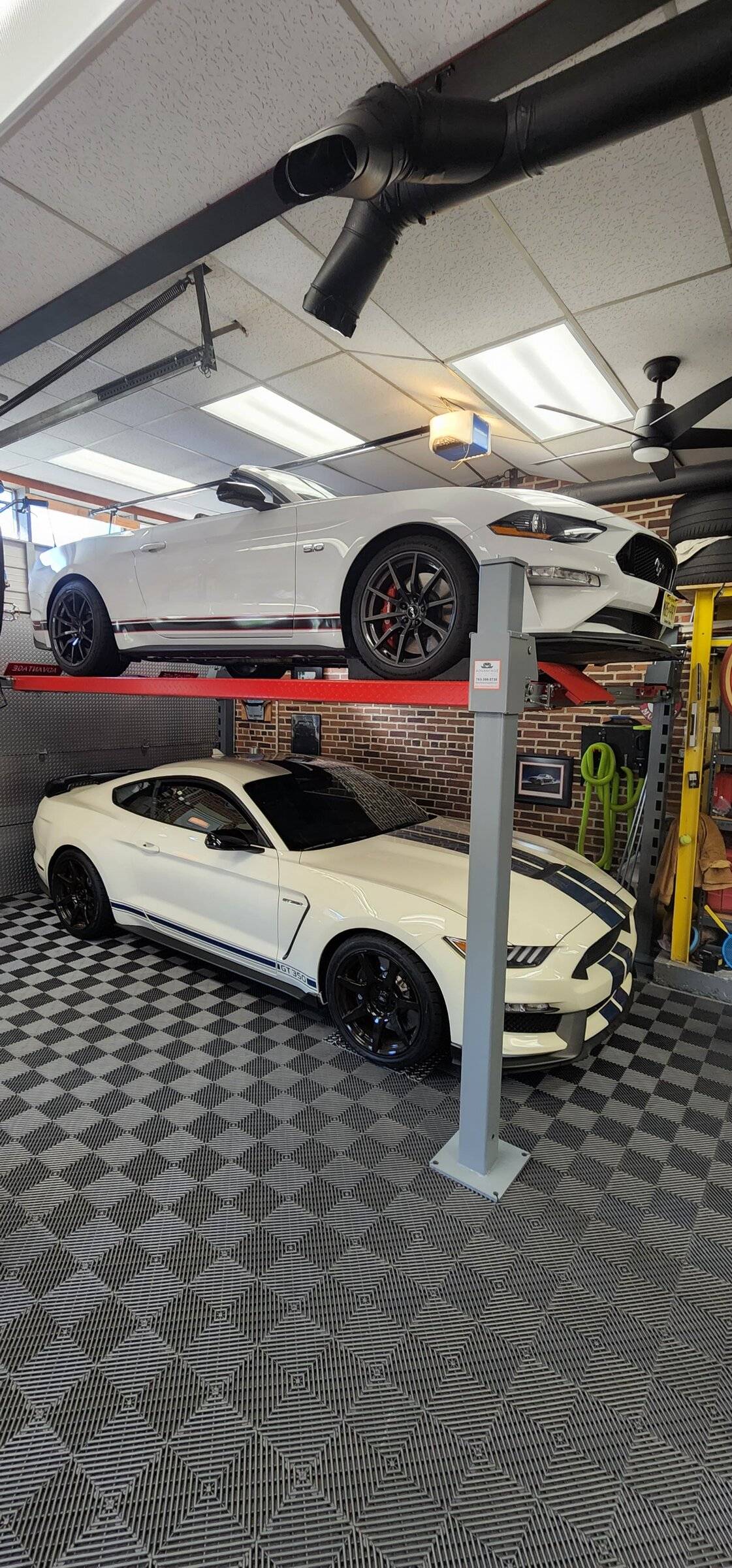

I took advice from @Inthehighdesert and @nmp1 on their lift choices. Ended up going with an Advantage Lift. It's great. Very sturdy. You can move it around if need be. Low ramps allow both a PP1 w the PP2 splitter and a gt350 up without problems. Sturdy, nice colorway, all good. High Dessert guy made a good point that a lot of the lifts are the similar so cost is a good consideration. Advantage Lifts are out of Pennsylvania. Bendpack is in California and distributors in midwest, so shipping and delivery time was also a factor.
