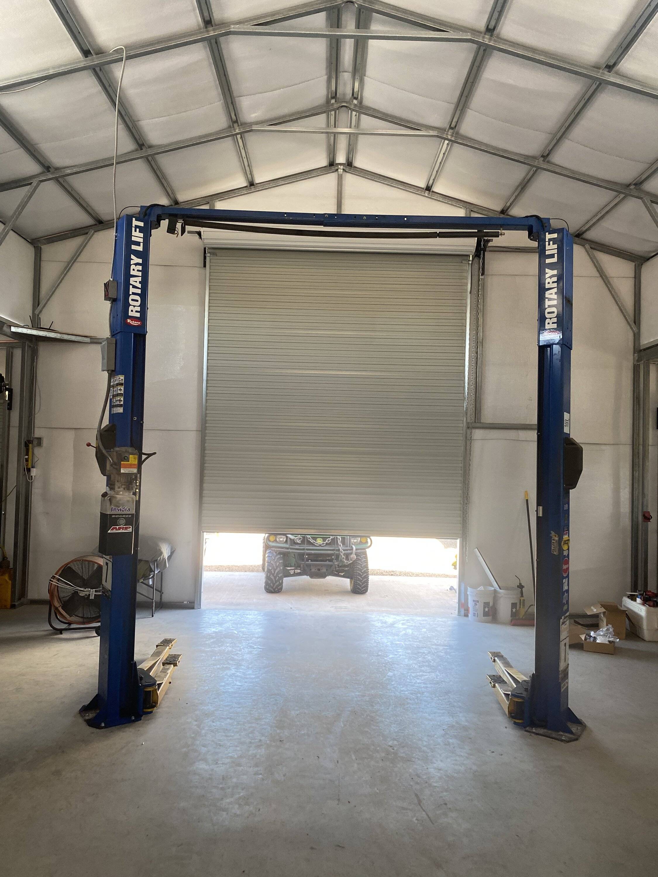

10k Rotary two post here…and a 9k Rotary for backup 😬

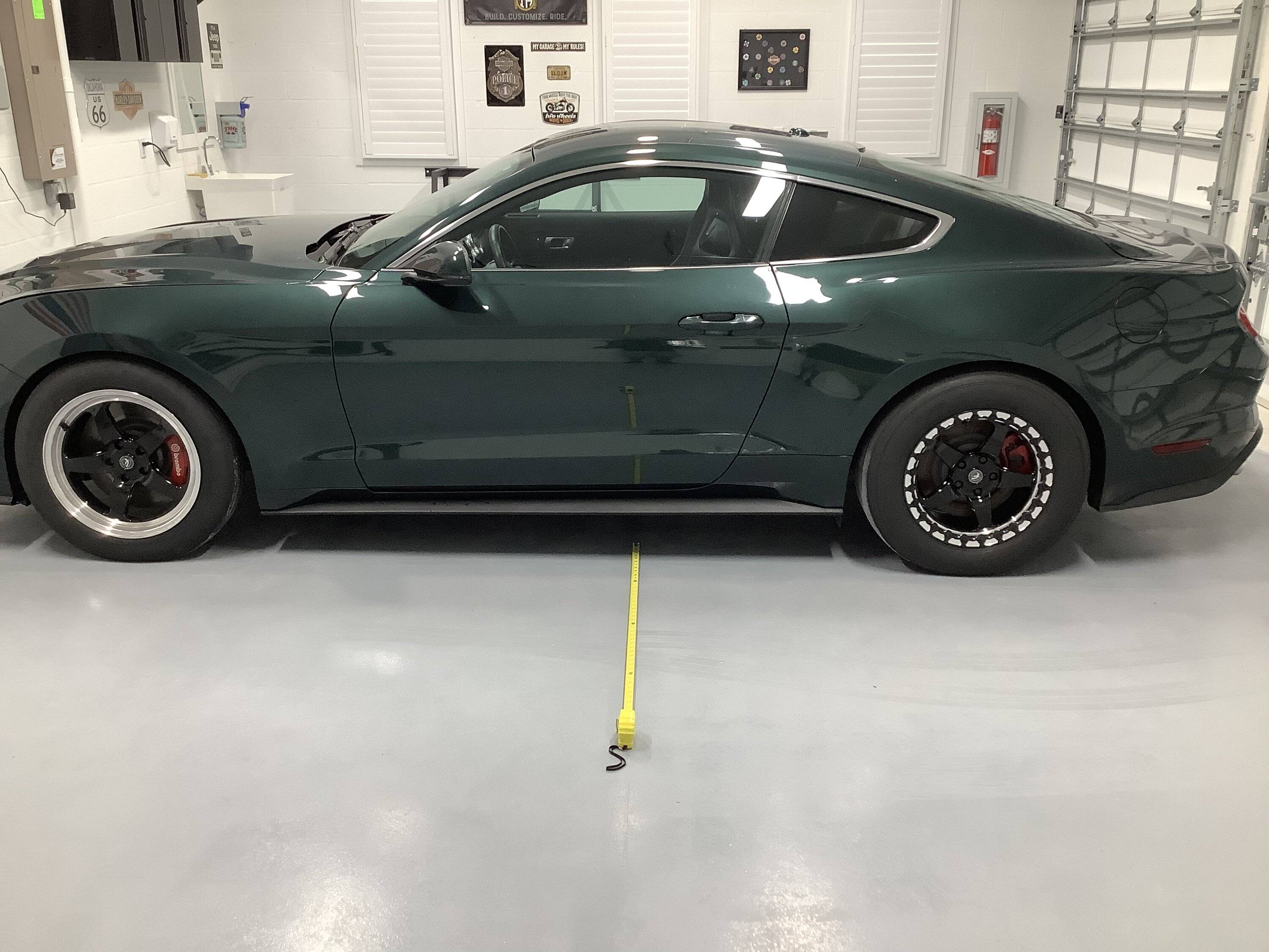

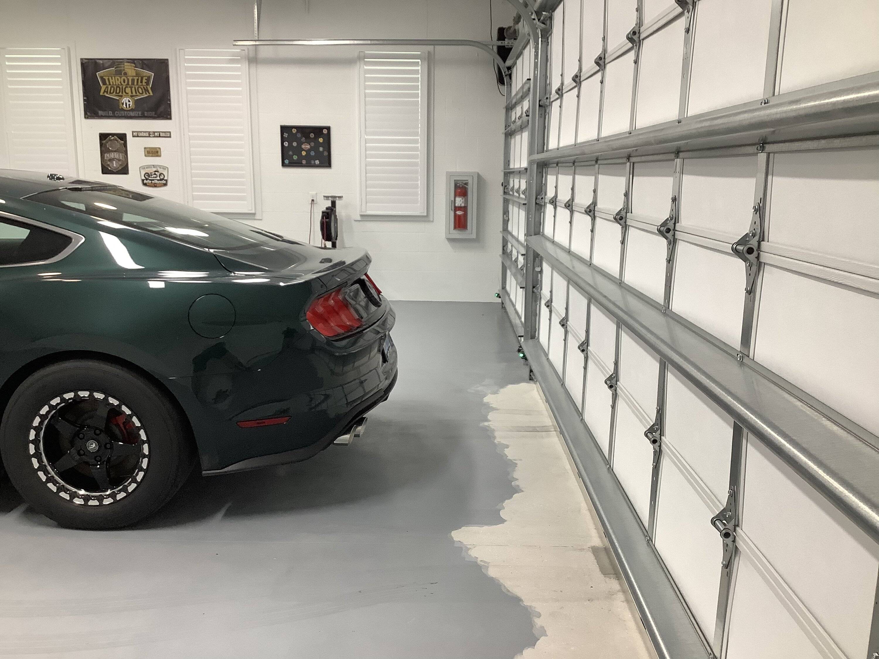

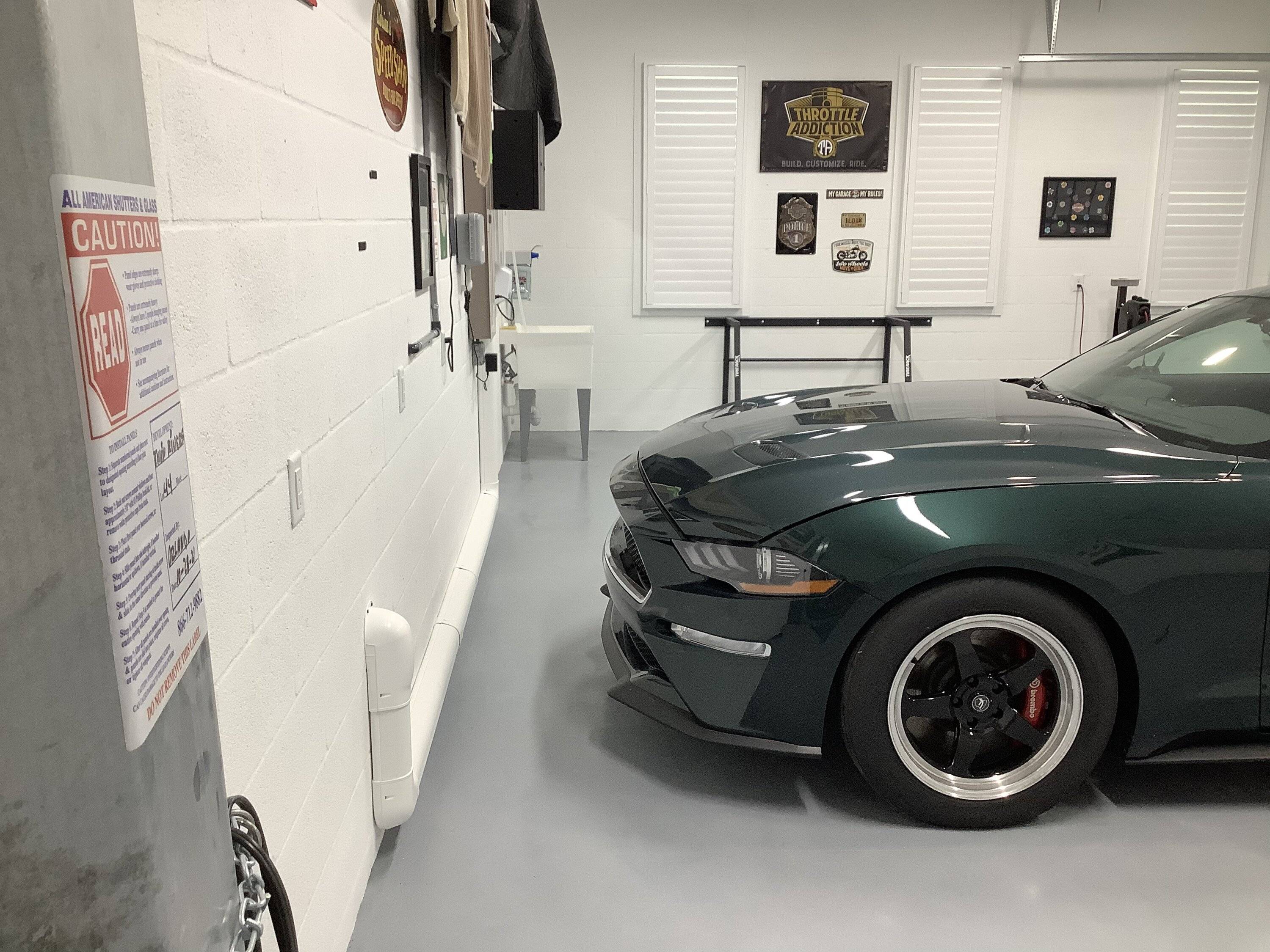

I found a lift at A local business called Champion Auto Lift in Sarasota, FL that I have scheduled to be delivered the week after next. It’s the TP10F-HD 2 post. I pulled the Bullitt into the garage last night to try and get an idea of where I will have to mount the towers. As you can see in the pics, the car is further forward than I would like for it to be, but this is probably what it’ll have to be though. The tape measure in the pic is laying right on top of a control joint that the masonry guys cut into the floor. Instructions on the lift say to stay 6 inches away from any cracks, expansion or control joints. In a perfect scenario, I would have the lift centered on the control joint. I’ll see what the expert opinion is of the Champion employees when they deliver it.
