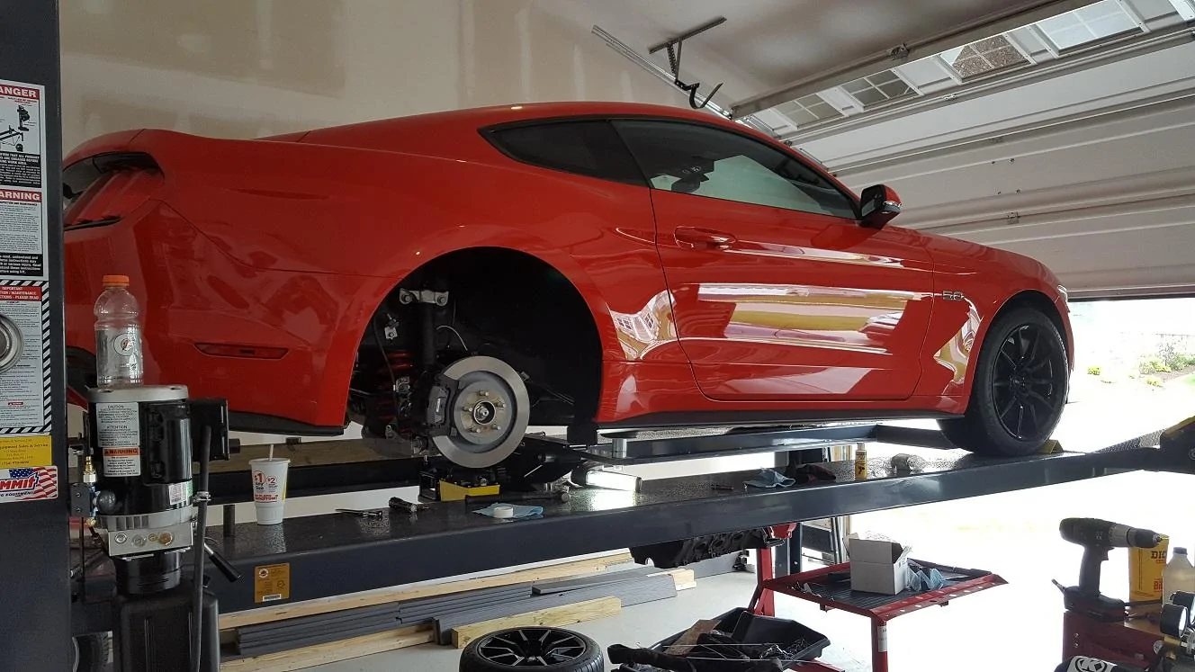

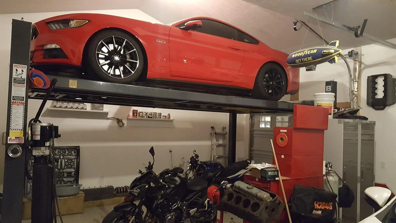

Just so you know they do make jacks to run between the rails on 4 post lifts. I love mine!

Of what you listed, with 8' ceilings, my vote would be Max Jax.
I <3 your garage. Including the block just sitting there waiting to be built. Well done! Oh how I wish I had a taller ceiling. Nice looking car. Yeah I did see the jack-on-the-lift, it is a great way to get the best of both worlds.
