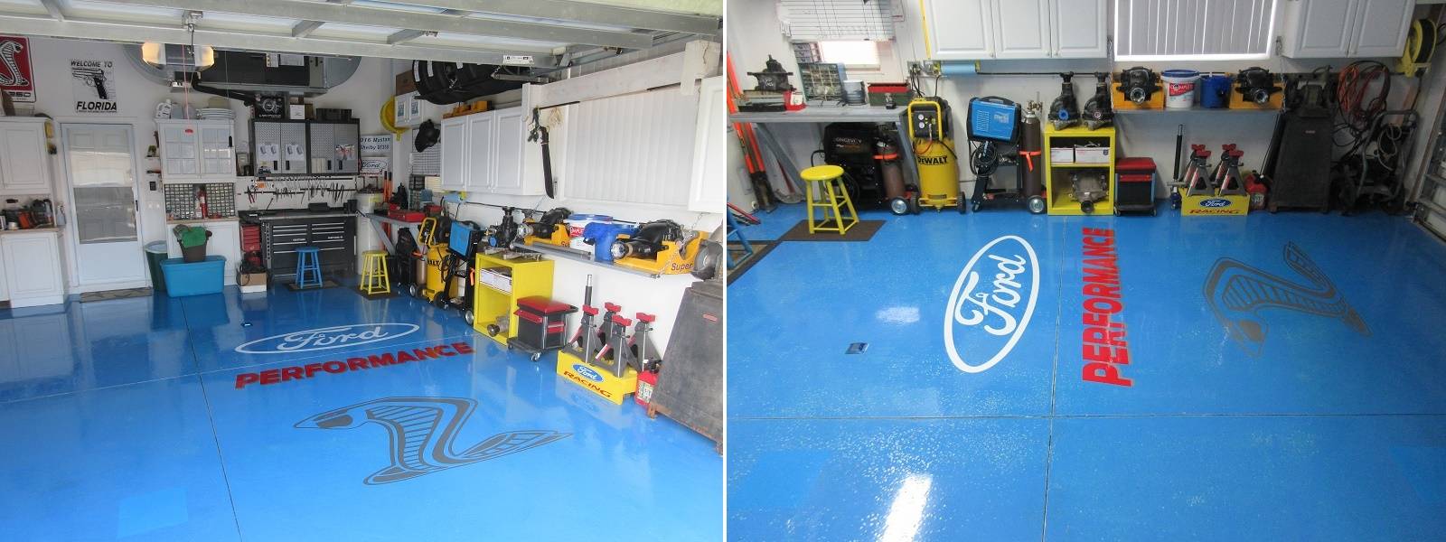

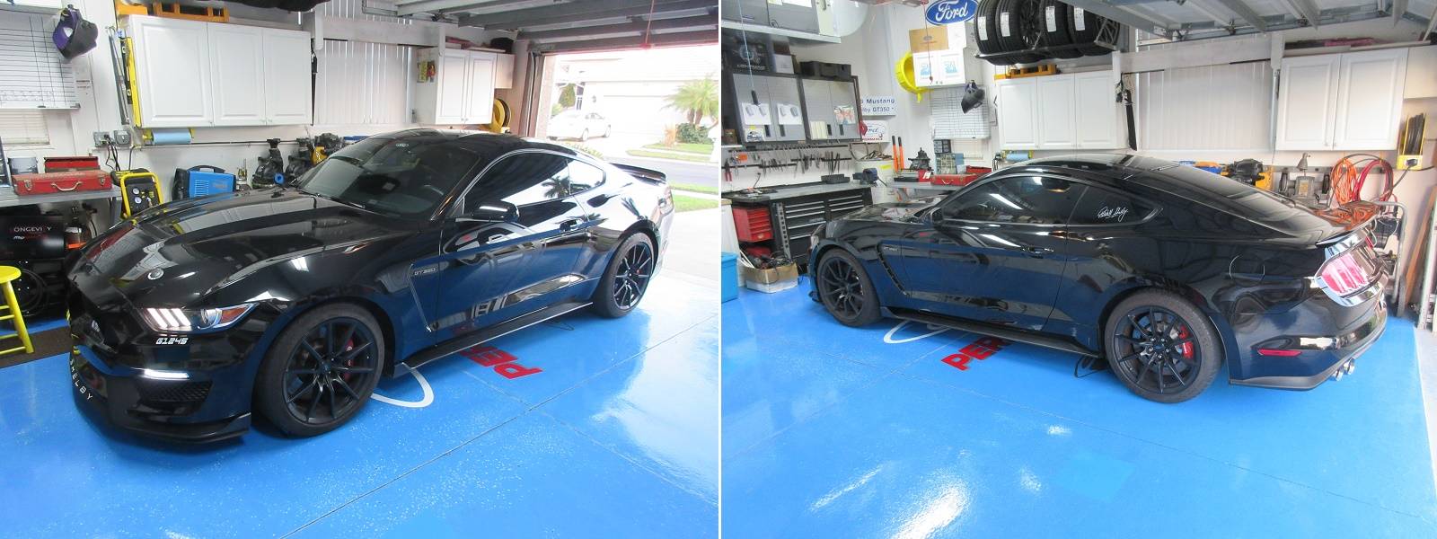

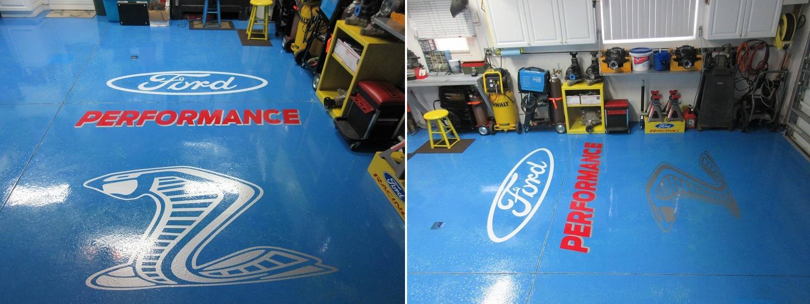

After recently refinishing my garage floor with a colored epoxy treatment (Ford Corporate Blue), I decided to experiment with some Garage Floor Graphics. Originally, I planned to put down these graphics after 12 hours after applying the colored coat of Epoxy and ending with a thick coat of clear on top of everything. After consideration, I changed from this permanent approach to a more temporary approach, (applying the vinyl without the clear top coat. The main reason I did it this way was that I would probably want to change the graphics after maybe 1-3 years, and it would be a lot easier to do this without grinding off the top clear coat of epoxy.
I added some traction compound crystals to my epoxy mix this time as previous experience with a wet epoxy floor was extremely slippery. I was very surprised that the vinyl graphics stuck so well to the epoxy finish. It literally looked like it was painted on and that is really how vinyl graphics are supposed to look.

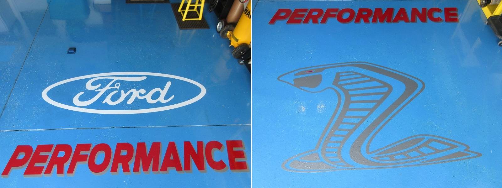

These particular graphic measurements are:
Ford Logo: 72”w x 23”h, PERFORMANCE: 83” w x 11”h, Cobra: 62”w x 38”h
How long is this going to look this good? Good question, I expect 1-3 years, as I am pretty particular about my garage floor and always wipe-up spills and debris.

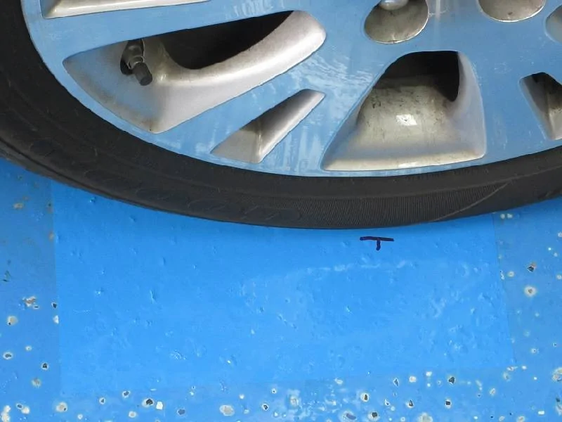

Are you worried about them coming up after being driven on?
I made some test squares out of intermediate 'Olympic-Blue' vinyl and tested driving/parking on these for 2 weeks. Not a problem...
Now if the wheels/tires are turned while sitting still on this vinyl, that would be a problem.
