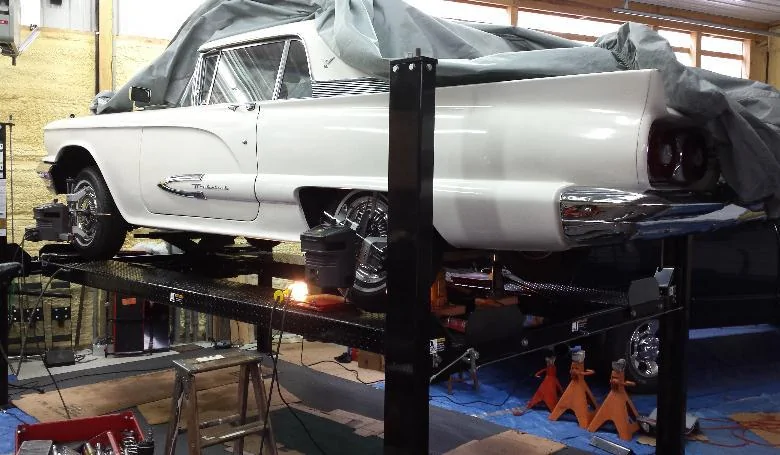

I used a Direct Lift 8000 lb 4 post (little more expensive since it is certified)
in a normal 8'ish garage in my old house. Yes, it didn't go up all the way, but still very
useful for working drivetrain, brakes, even under dash/door panels as you don't have to
bend over nearly as much (or at all). Towers are more of a mid lift, but even now (moved and
built 3200 sq ft pole barn), it goes up plenty high enough.
As mentioned you can get a cross jack and these cheaper lifts come with a jacking plate
( I use jacking plate on rear, cross jack front if I need entire car lifted up) and casters to move it around.
No need to bolt it down, and I've had 6000 lb built up fullsize broncos on it.
Some things it's really nice for that you can't do on a 2 post or anything that jacks on the frame
are final tighten suspension bushings, align exhaust systems, jack control arms off the runways
(with car up in the air), wheel alignments (even home jobs). I bought a used hunter alignment
system that works great with it.
