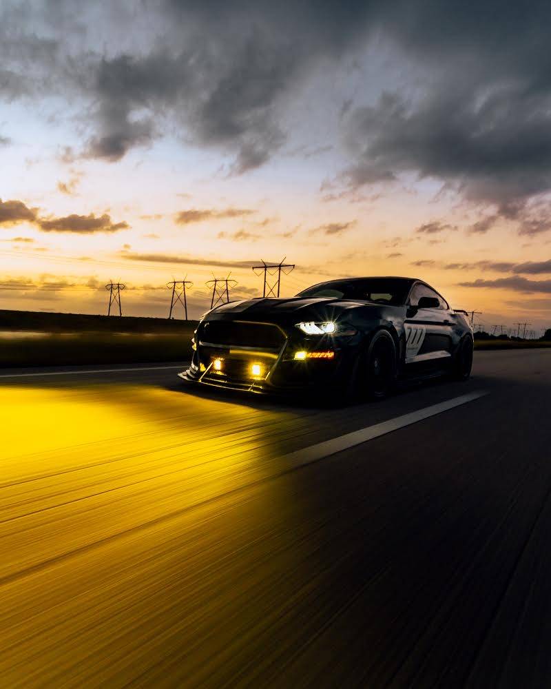

@murick - The solutions for your 2 hurdles that have been done on the pictures I've shared are as follows:
1) Positioning, height adjustment and attachment - the guys from the workshop that installed them have made the necessary measurement and have cut the back of the oval openings on an angle that matches the height of the low beams. So, you have to adjust by the low beams height.
Then they've glued them in place. This makes the lights kind of impossible to change / replace, but obviously no one is considering replacement as these are LED, hence not that much prone to burn / get replaced.
2) Controlling the DLR/outer rim was bound to the autolight and there's a switch to change color between orange and white. So, turning off autolights / DLR turns off the rim light.
For high and low beams there were dedicated switches installed under the steering wheel (on the plastic cover on the bottom side of the steering wheel console). So these are pretty hidden and still easy to access if you want to turn the lights ON/OFF. The guys told me that they couldn't figure it out how to control it using the car light controls, but I guess they didn't want to go too much into investigating the options. To be honest, I am not 100% sure whether the ON/OFF button was for turning on low beams only, and swithcing low/high was done by the car... and I'm not sure I can verify the setup anymore.

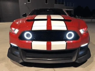

I have asked Oracle if this type can be made to fit in our cars. Once they reply, I will let you guys know. I also told them if they needed any additional information from the car I would provide it.
These were installed by Gus Gomez in an old thread here.
I purchased this from Oracle. Can be cut to size and flex. Just a bunch of LEDs on a flexible strip inside a silicone type tube. Feel like they should be half the price and are not as bright as I expected. But this is what I plan to install as they form to shape nicely and I will probably just run them from the parking lights.
Thanks for the post, I did not see anywhere on the site about the lumens, so I figured they were more of a decoration than an actual light.
