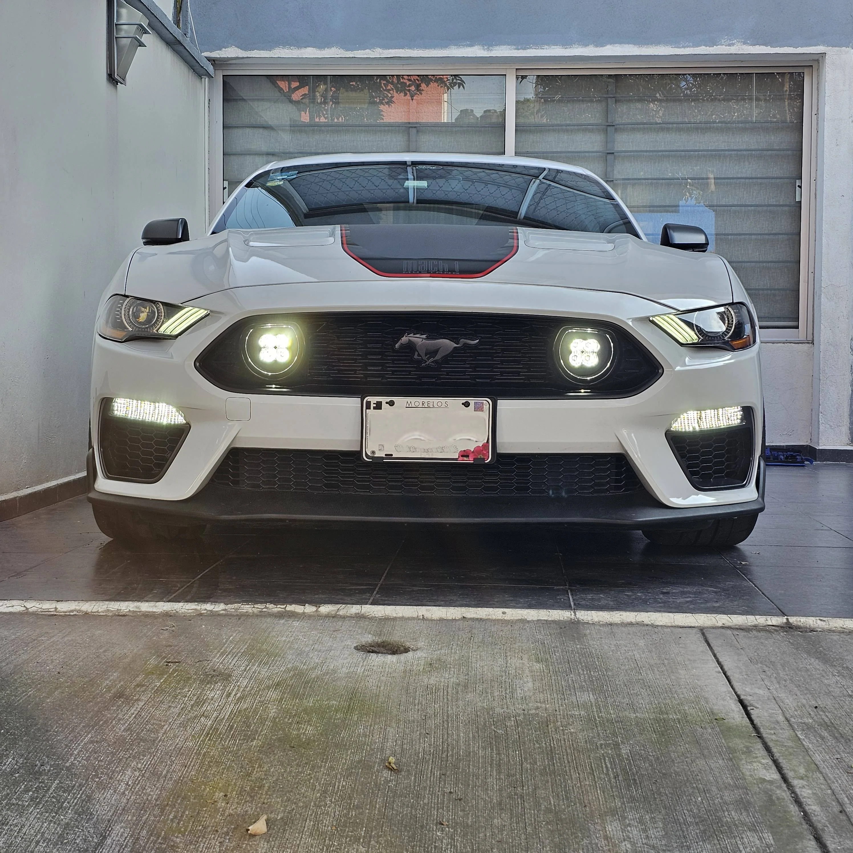

For the turn signal with fog light option, you can make it to work, based on my personal investigation and conclusion.
Starting with the fact that the 2015 - 2017 GT housing as well as GT350 and GT500 sidemarker assembly, are the same as Mach1, the parts needed are
Starkey kit
https://www.starkey-products.com/mustang-fog-light-wiring-switch-fits-ecoboost-2018-2019
Emailed them and got confirmation that this should work for Mach 1
Shelby Performance Parts 2015-2017 Shelby Brake Duct and Fog Lamp Kit - 17BDKIT
https://www.lethalperformance.com/s...elby-brake-duct-and-fog-lamp-kit-17bdkit.html
(Brake ducts are not going to be used for M1- Maybe shelbyperformanceparts can sell the led assembly only)
And the step by step video to install everything is the same as GT350 from CJ pony parts channel
No need to cut/slide any wire, a plug and play option.
I was looking to do it myself, but is out of my budget for fog light project for my Mach1
Am leaning to Diode Dynamics SS3 option as I investigated that perform amazingly well and those lights have tons of application in the offroad world, with tons of, brackets, options for swapping lens, clear to yellow, fog light to driving lights, spot to wide pattern and so on.
Am not going to be able to work in my car till late may 23, due workload and traveling.
I will publish more info when ready

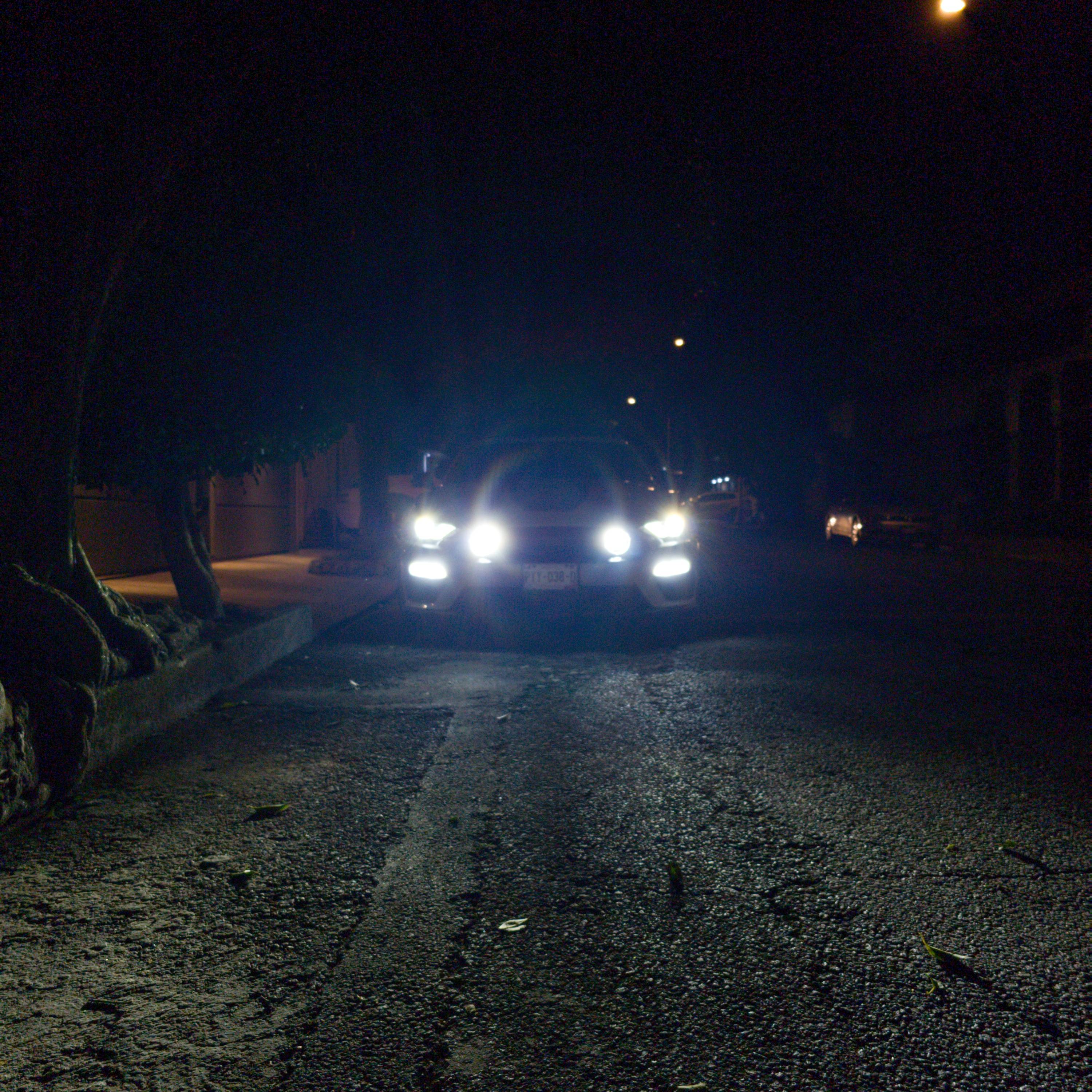

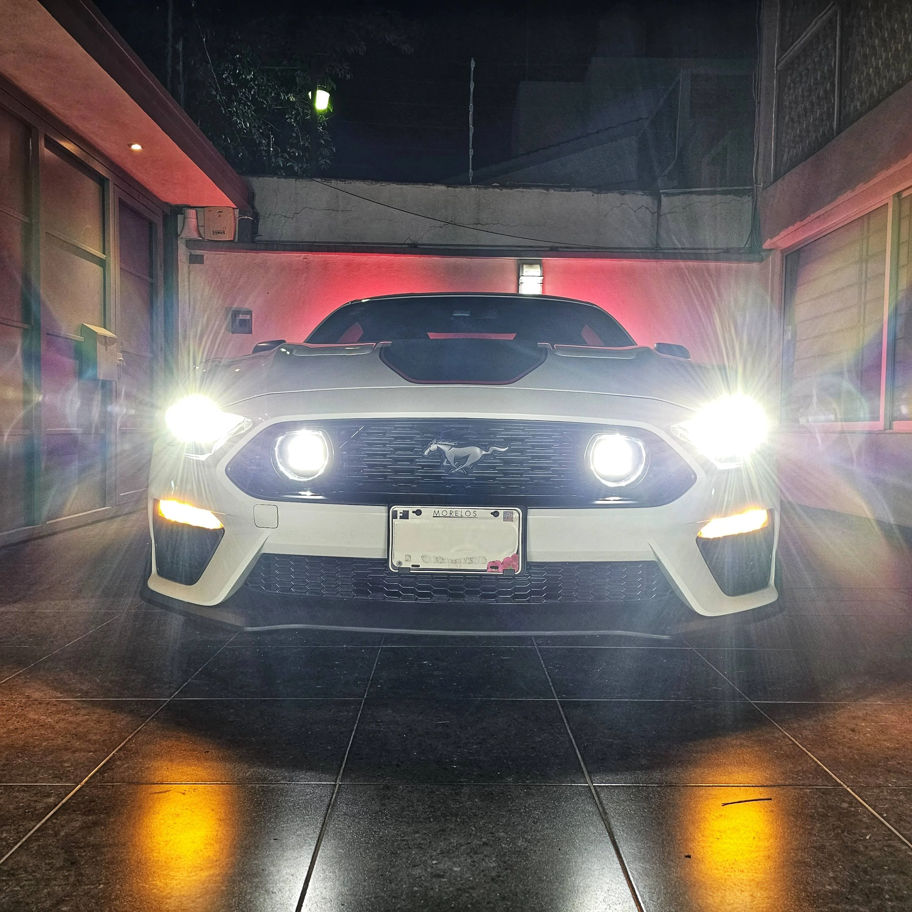

Took me some time to investigate, buy, wait, and finally install all the parts and the final result is awesome IMO
Looks great on, let’s see a pic of them during the day.
By the way community
I want to share the list of parts, as I could not get all the ones mentioned on my first post. LIST is as follow in case anyone would like to replicate my 22 Mach 1 Setup:
Diode Dynamics Sequential LED Turn Signals for
2015-2017 Ford Mustang (pair)
(USDM) Originally I was looking for the Shelby option, but could not find it. But zero regrets with DD option. Resistors required (About to order them from DD)
Diode Dynamics DRL Harness Optional for Ford
Mustang Sequential LED Turn
Signal (pair)
Diode Dynamics Deutsch DT 2-Pin Adapter Wires
(pair)
Tripleseven GTE Fog Lights custom request to include Diode Dynamics SS3 Pro SAE Driving, instead of the sport low series version as the package typically includes. If asked they can sell you the Max version instead, which is expensier.
Starkey Products Mustang Fog Light Wiring & Switch Kit - Fits V6
2018 Mustang GT OEM Switch with fog light
The steps followed. Are exactly the same as the ones shared by CJ Pony Parts for GT350 Fog Light video on YT.
Conclusion: I wasn't looking for a budget option, I was looking for the seamless installation, as Plug & Play as possible with quality parts. Took me more than I wanted to, but at the end made all the parts to perfectly work so far.
Hope this can help someone
As side note the GT3 S650 also uses a very similar fog lights (not completely filling the whole opening) and looks very motorsport to my eyes and really love it on my Mach 1, in case someone is hesitating about it.
Looks great. I cant believe there is no aftermarket kit yet.
I could be wrong, but I have not seen fog lights pockets for 2024s Mustangs, maybe we are not so bad after all , at least we can put something and looks "oem-ish"
