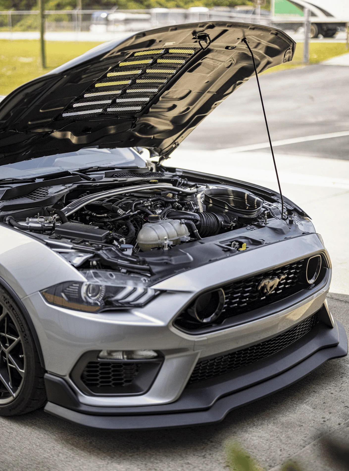

Do they line up with the radiator support like this? This Anderson Composites one looks a lot more flat than the Vicrez.
Not that exact spot. It’s close but the issue I’m having is I get them to line up but the latch is at such an angle that it won’t engage with the pin, so I need to angle the pin…
Good to know. I'm going to try and tackle this with a shop and see how to angle it.
