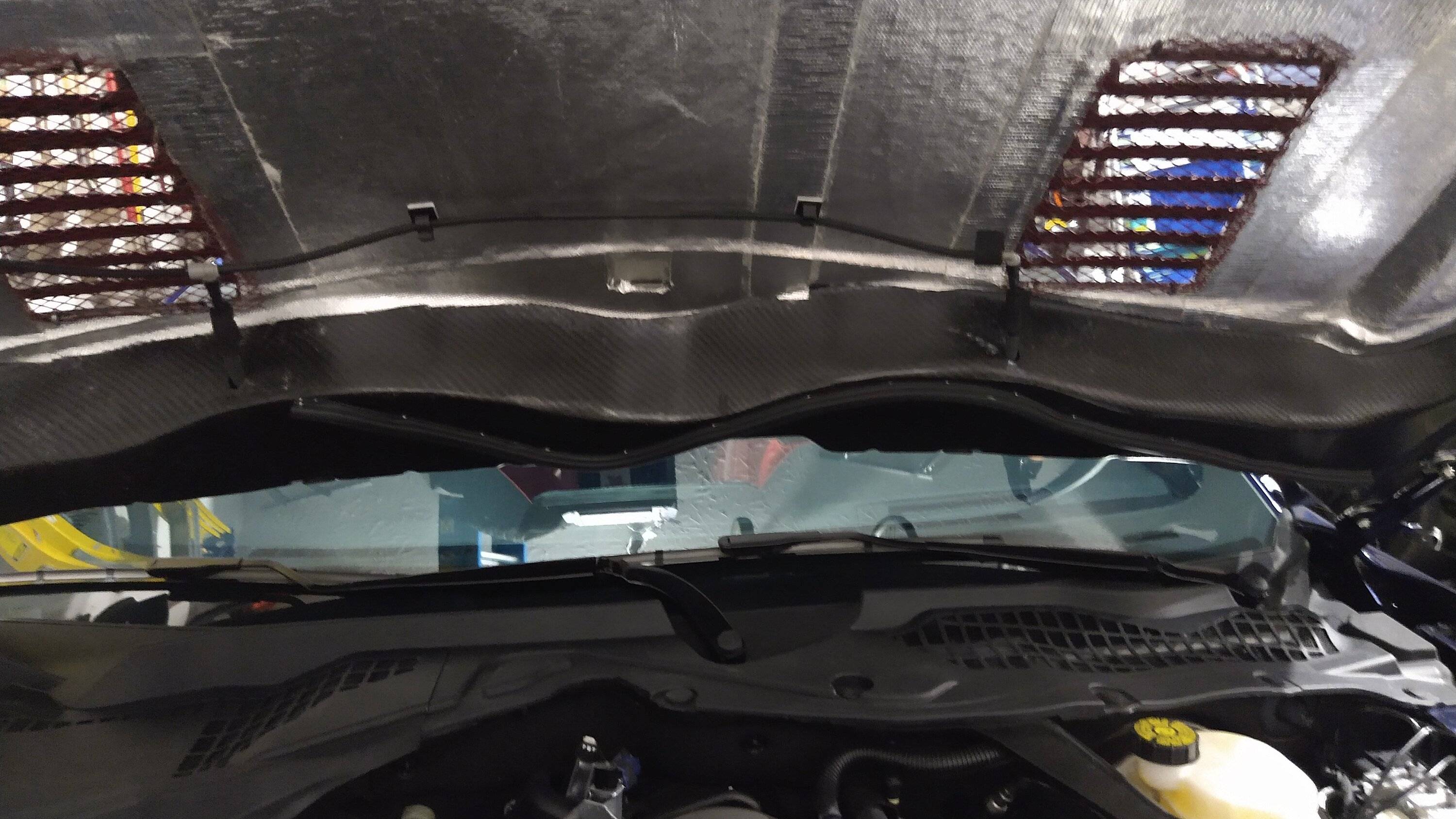

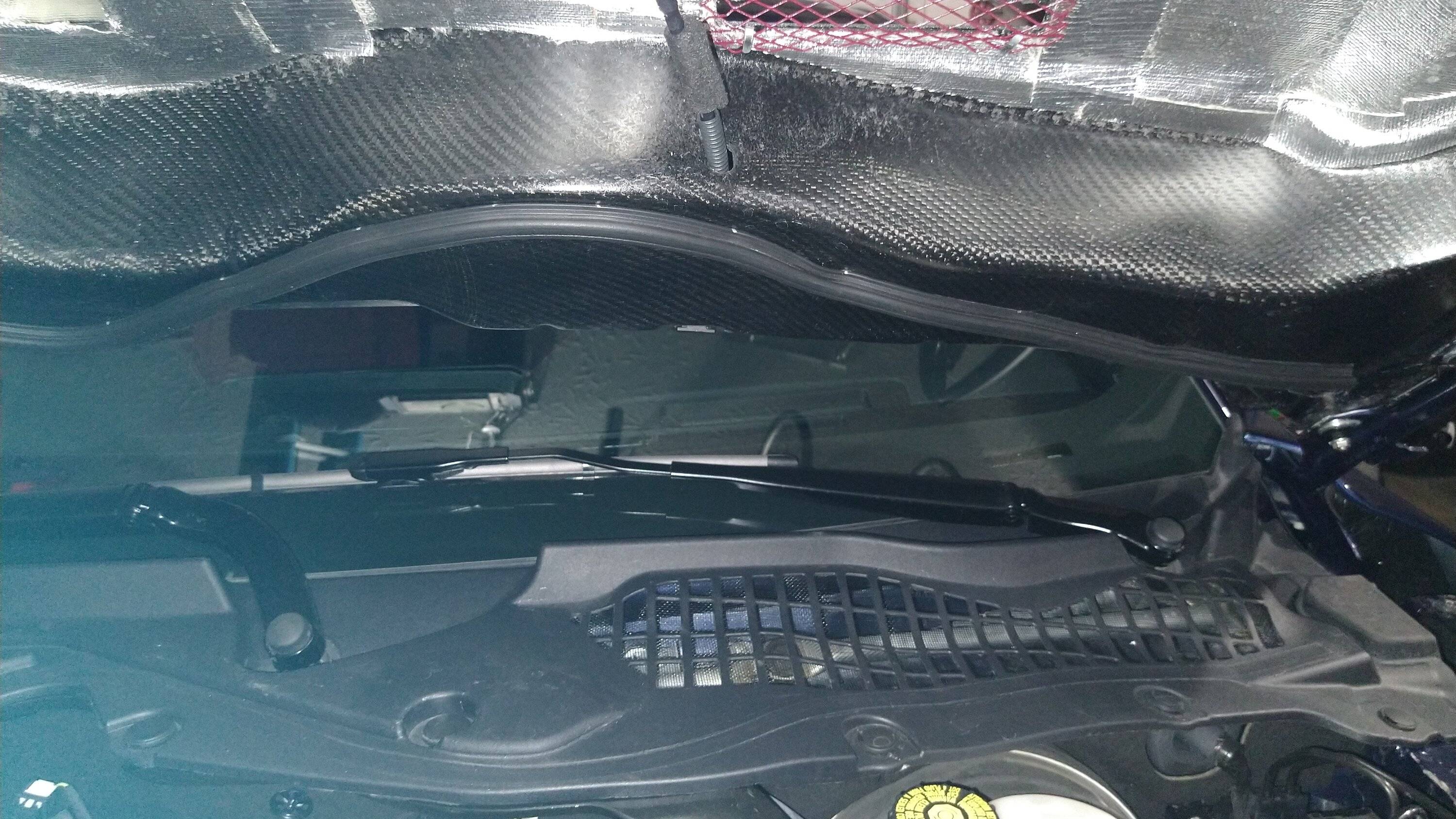

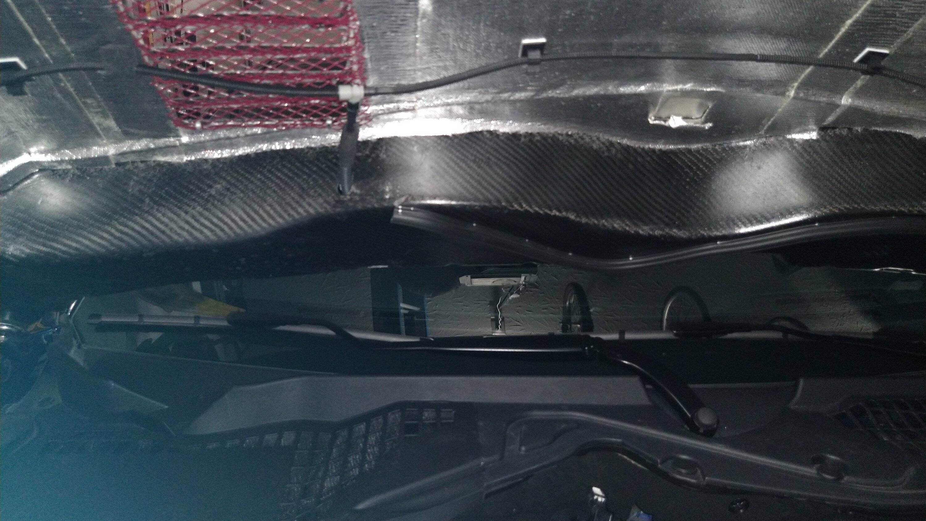

Did you reinstall the rubber rain seal which goes across the back of the underside of the hood and contacts the wiper shroud? That applies pressure and stabilizes the rear part of the hood

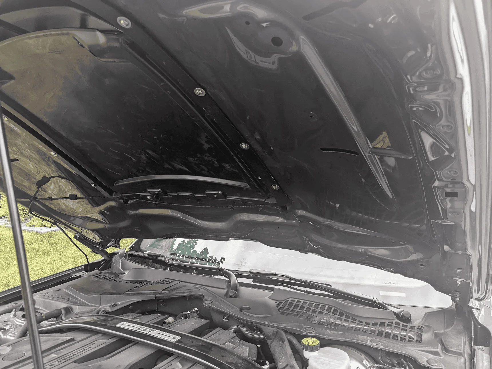

Got pics of what this looks like? My stock hood is coming back to my place tomorrow so I can look to see if it's on the car already or on the stock hood.
Yes, the rain seal will have to be taken off old OEM Hood. Mark the location of the rain seal mount push pins on the new hood for the rain seal installation. Good luck

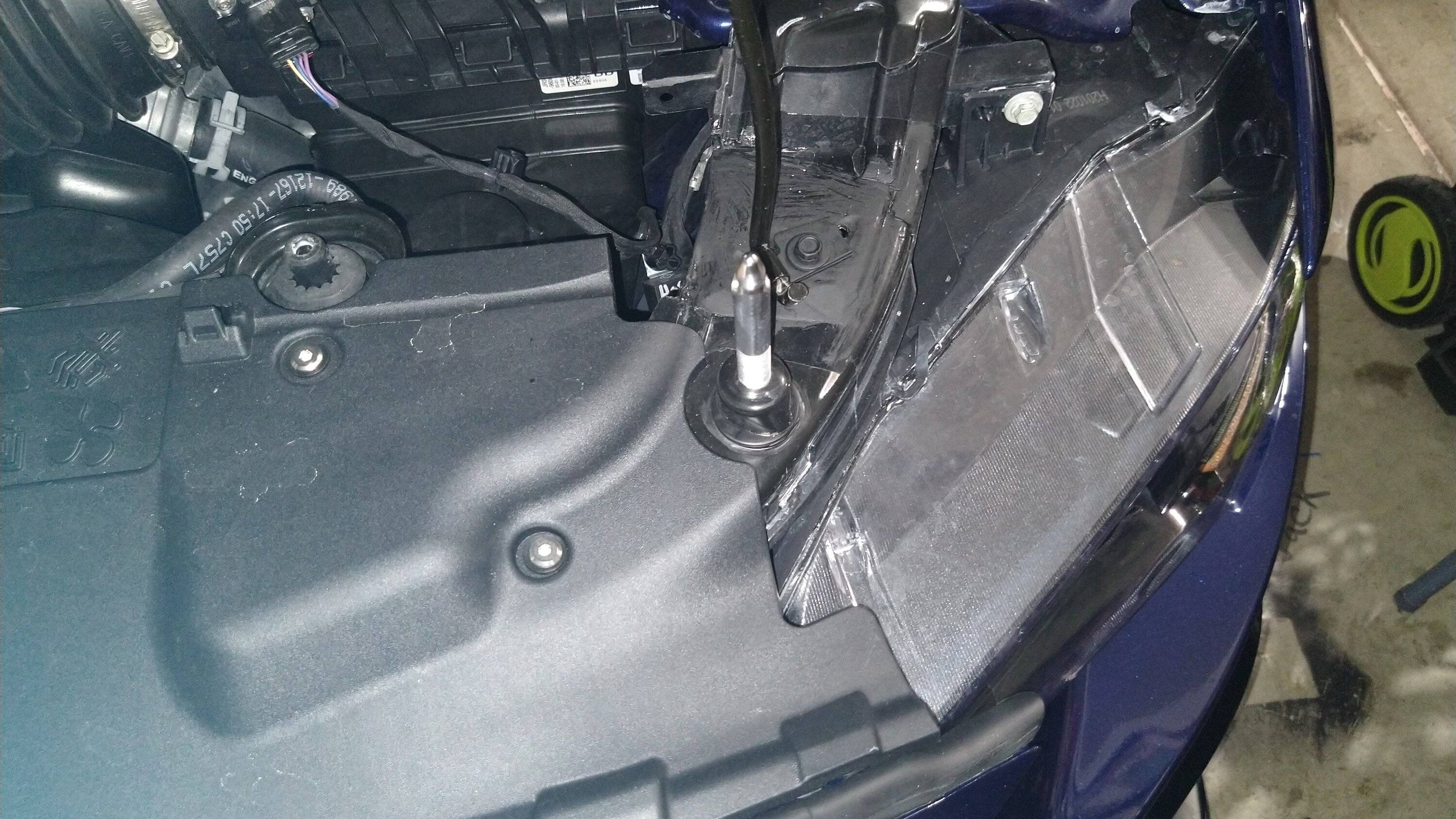

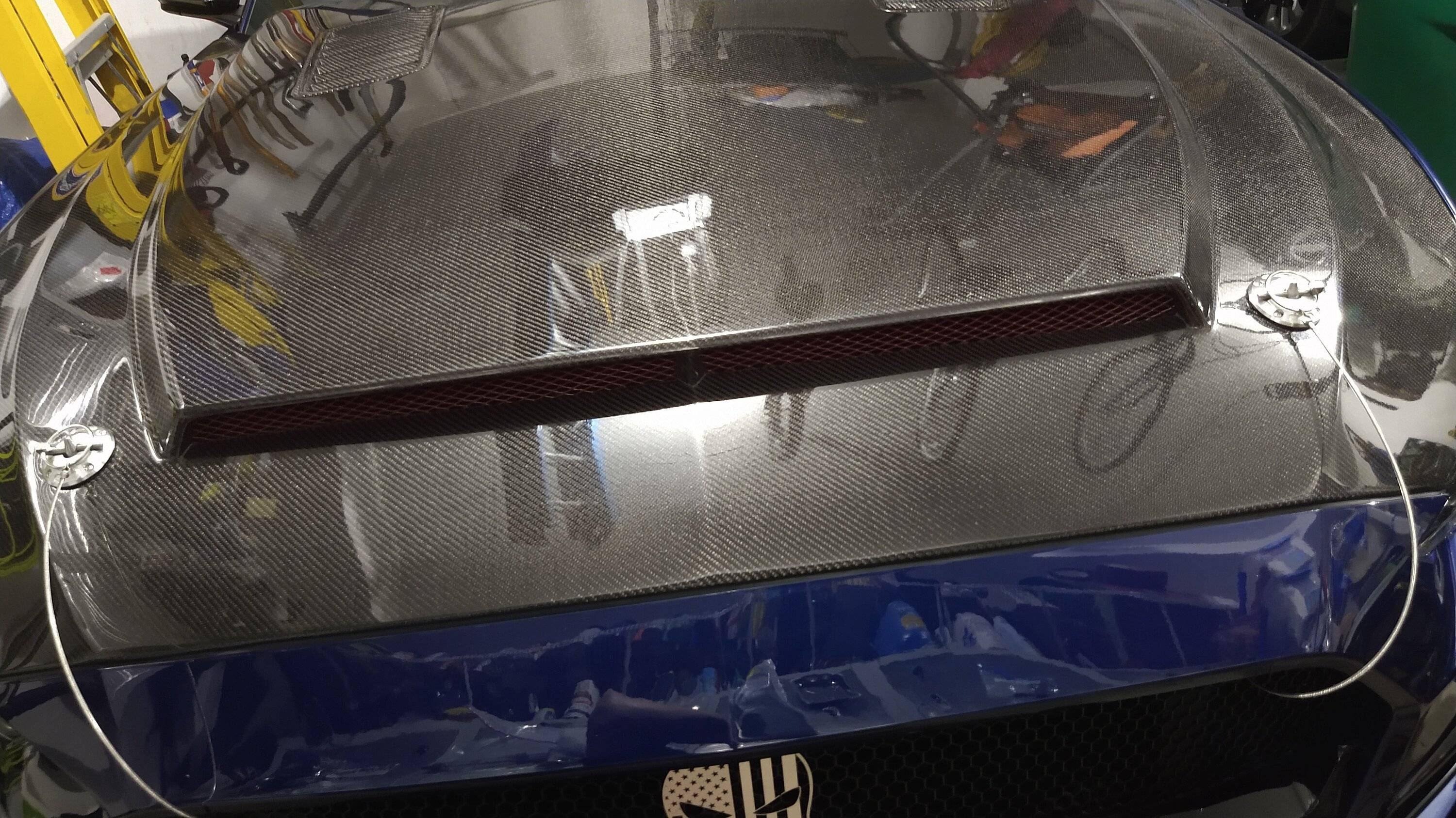

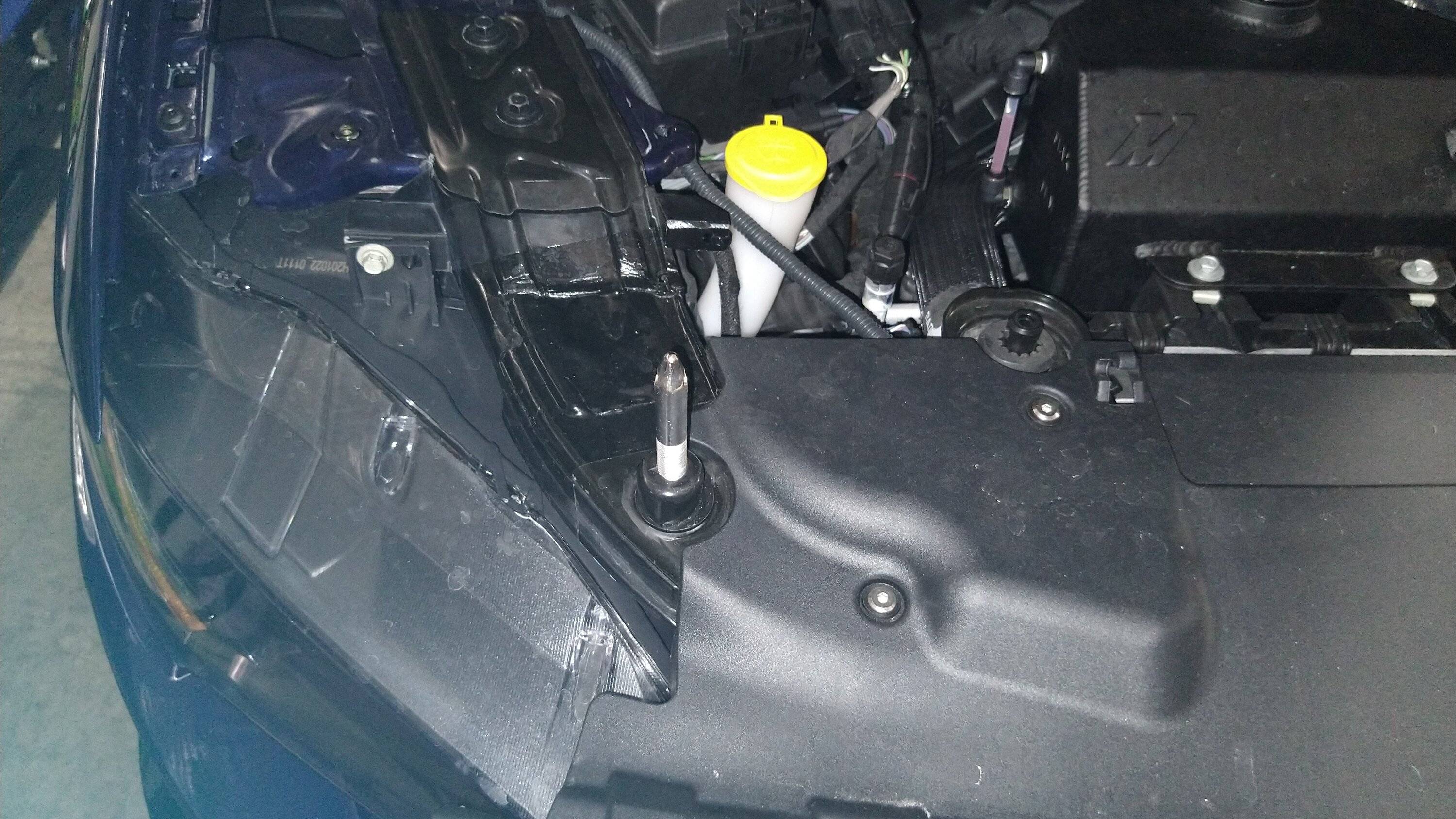

I went with Drake Hood pins, the angle doesn't affect the closing like on the quick latch set up. Plus I didn't like how much upward pressure was applied to the hood where the quick latch was mounted when I closed and locked the hood.
Thanks for mentioning the Drake Hood pins! I was looking for some classic ones with lanyards. The Quik-Latch Retro Style Hood pins are out of stock and $345. Steeda has the Drake ones for $109.

I had the Quick Latch ones on my last Hood and never liked them. When closing, They put allot of upward force on the top side thin metal hood bowing it up each time I closed. The Drakes really look nice, very well made. Much easier to close and latch. Plus they are so much easier to adjust the downward pressure on the hood latch plates.
Good Luck
I don't see the rubber thingy. Guess I'll have to see the stock hood which arrived today and has been stowed away in my basement in the event I have ever have to go back tstock.
