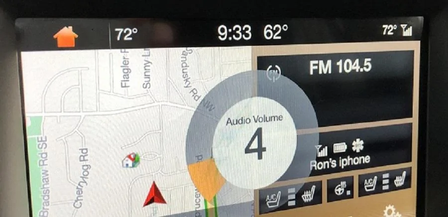

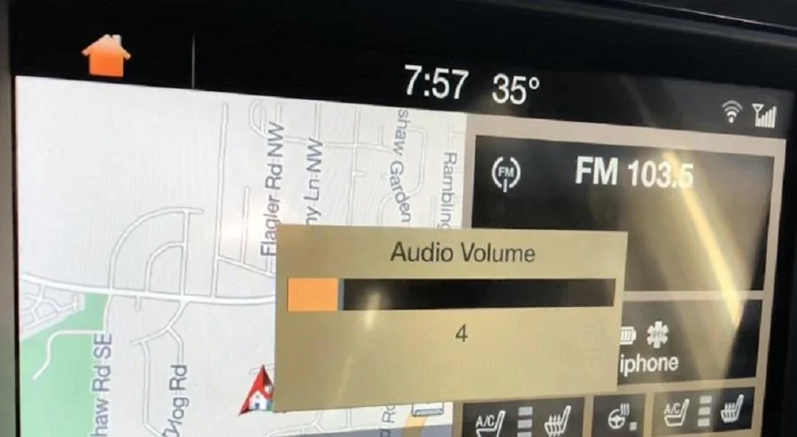

Spreadsheet (on page 1) updated with the following:
Updated format of spreadsheet - looking for feedback. Is this new format easy to ready? Are you able to understand what each change does? Do you understand which digit needs changed to affect the change? Any feedback is helpful.
Updated APIM line where change to Volume Indicator is located and what it does (I'll post a pic later today).
