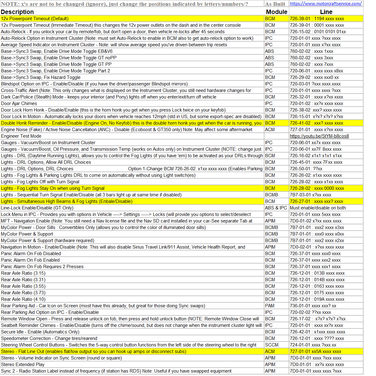

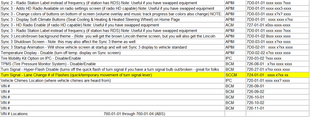

I could only find ONE Mustang file on this forum (and a pretty bad one at that), which is attached below. FIND THAT CODE THERE! Yeah, not there, huh? The closest mention of that subject was on line 54 of the 2015-17 cars, but there's no code. Anyway, If you have a different spreadsheet, why didn't you post it too? B*tching and helping is fine with me, if you like to b*tch. But just b*tching? Come on man.

Okay, okay....this forscan stuff is new to me as is the Mustang. So calm the fuck down. I was finally able to work on my options this weekend such as the double horn honk disable, simultaneous fog light and turn signal enable, startup animation is now Ford, simultaneous high beams and fog light enabled. I printed a list starting with 726-01-01 and ended 726-74-02. Obviously, I didn't go far enough.
