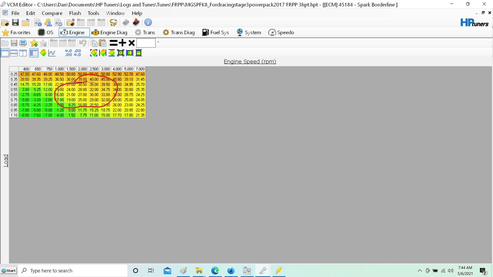

What total timing are they commanding ?
I don't remember but i had to reduce part throttle timing in the light to mid range load areas due to it showing knock on the logs.

That's a bunch of timing for pump gas.

My opinion is that the tune is not necessarily bad. It just works for some set of cars.
I have noticed that some forum members living in my very area (read - use same 91 I use) that do not have pinging and some including myself having pinging.
I attended hpde event where another guy had PP3 and his car did not ping.
What differs one set of cars from another I do not know. Ccould be MAF calibration that is slightly different, could be intake manifold air leak.
One guy at another forum had his car ping on 91 and 93. Then he installed breathers and the car was running just fine even on 91. I then installed breathers and my car did not seem to have any pinging. But gas smell inside was pretty obvious. I installed two sequential oil catch cans then - UPR followed by ford racing at passenger side and just one ford racing at drivers side. The car pinged.
I also swapped MAF and it seemed to help a lot, but after some period of time ping came back.
Finally U just removed pp2. At least one member in this forum highly suspected his engine damage was caused by pp2. He was tracking his car for long time ignoring pinging though.
I wonder if pp3 is a better option as it does not change much in rpms ehere pinging occurs. But I am not sure I want to invest more money in this especially as pp3 is not that easy DIY.
PP2 and PP3 use the exact same timing maps, I have not found a PP1 to compare If anyone has a read I sure would like to see it.

how about different red lines?
Don't know about red lines but the FRPP2 Auto shifts at 7200 RPM the FRPP 3 auto shifts at 7500.

Same or not the same, but pp3 changes almost nothing in low rpms where pinging occurs in my case and so who knows, maybe pp3 is not prone to pinging.

Bringing this one back up, I spoke to our local Ford Performance distributor here in Australia - his suggestion was use the procal to switch octane adjust off, then back on and do KAM reset. I did that and was shocked to find no pinging - then after some more engine start cycles it came back just the same as before.
They have sold hundreds of these kits all over the country and were a bit surprised I was having this issue on 98 RON top tier fuel (ethanol free).
Given we know the tune is commanding a ton of timing in the RPM range experiencing the pinging - would be worth trying a set of spark plugs one heat range colder to try and slightly reduce combustion chamber temps? I know they normally only recommend this for forced induction, but I'm curious if it would make any difference?

The plugs will help if it is pre-ignition.
What is the MON of your gas? Motor octane
I would try some octane booster, if it goes away you need better gas.
