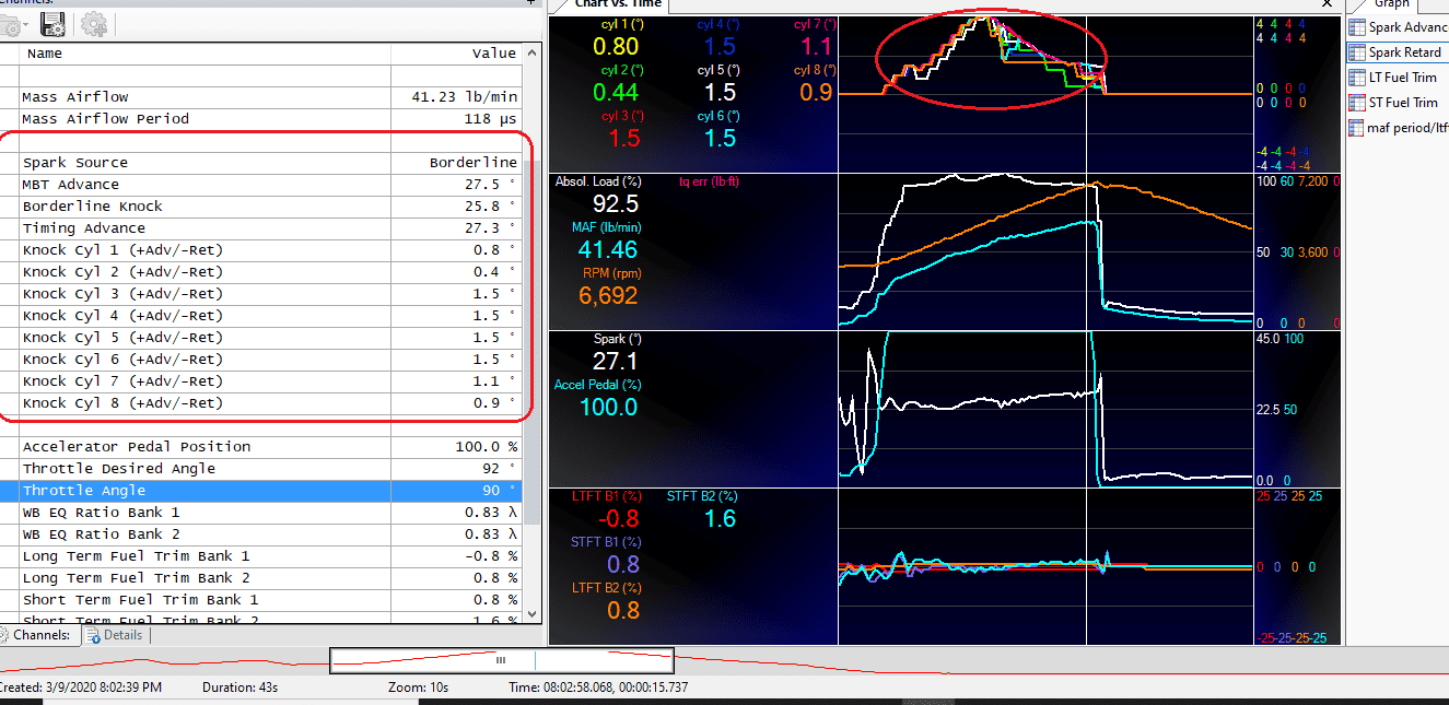

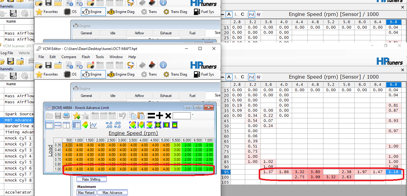

octane adjust and half tank of quick trip 93 on top of the prior costco and all is well from what im logging. will continue on this octane adjust feature for another tank then switch back to no adjust and see what happens. no more costco for now.
Hitting MBT which is like hitting the bullseye. At MBT for nearly the entire 3rd gear pull too. at this point e85 wouldnt benefit this tune one bit.
the knock sensors are nearly maxed out on their ability to add timing (good thing). mirrors what the tune allows very nicely. View attachment 444468 View attachment 444469
