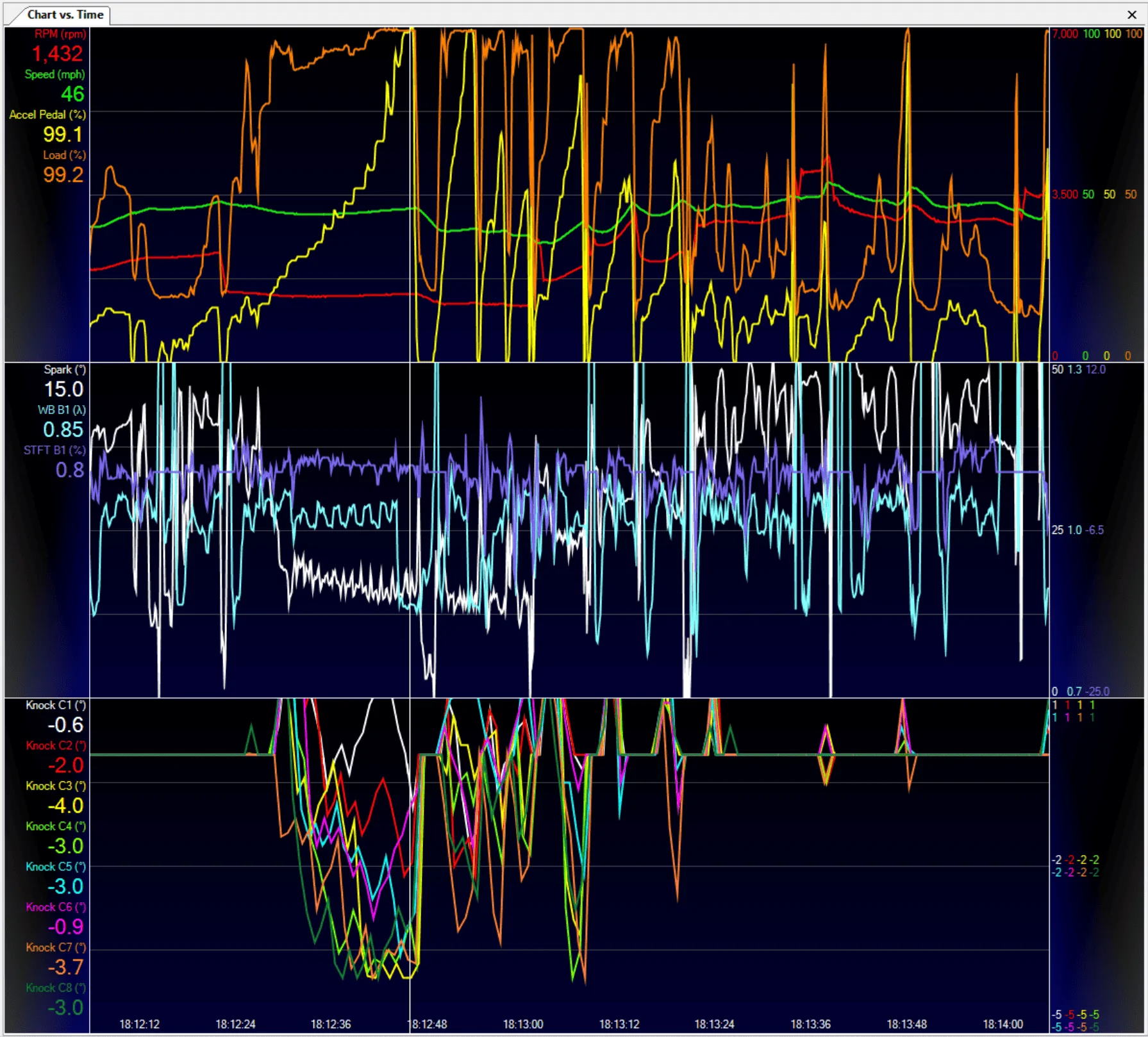

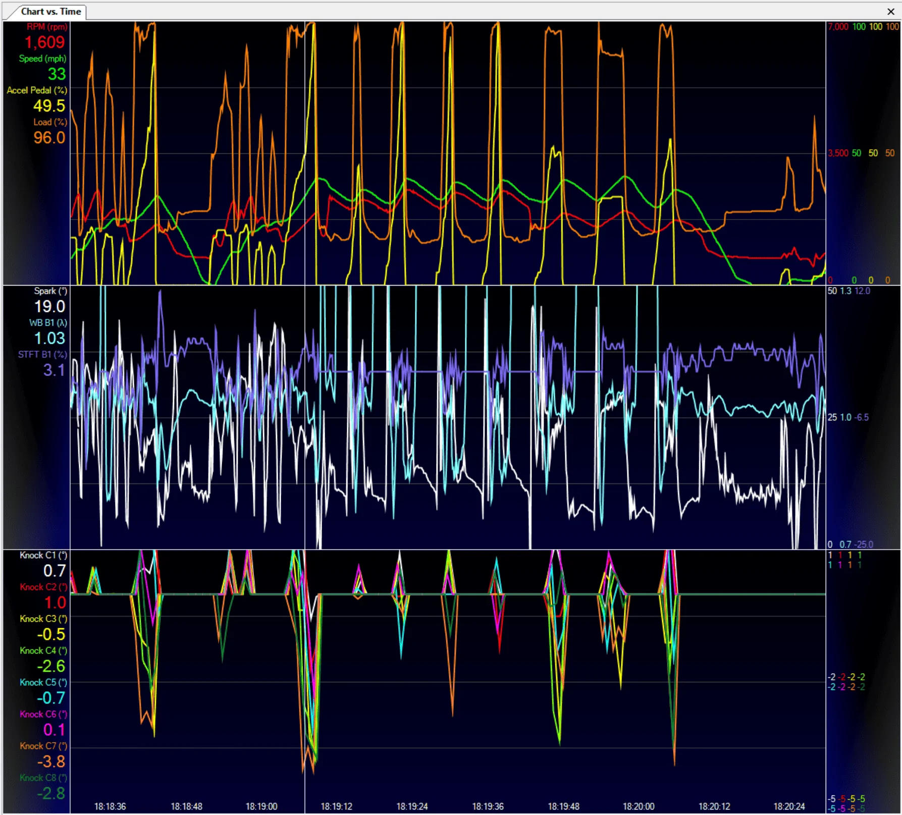

I didn't realize they were that close. It's amazing to me that they kept the tables basically the same, maybe they are relying on the learning to handle differences. This was my buddy's car when we tried it last summer. Ambient was 91F and IAT was 99F here. This was on CA91 octane. As you can see, we rolled into the throttle so as to not immediately jump to WOT fuelling, even though I picked this point where we were running at 0.85 lambda. This was after a KAM reset, but we had not driven it much, so if the ECU learns knock and stores it in the KAM, and if it takes a while to learn it, then it probably hadn't happened yet.
It's not an isolated event though, we were able to reproduce it anytime we wanted to:
I'm not positive why the ECU was trying to advance right when knock happened, it seems counter productive, but it's possible we were logging too many PIDs and the advance actually preceded the knock which we can't see here. By this time IAT was 108F and ambient cooled down to 88F. This was the same run, same fuel, etc... We have logs where we kept in the knock longer than these, well over a second or two, just trying to see if the ECU would pull enough timing - but it didn't. We only tried it once or twice though because we liked his pistons without "speed holes" in them.
Going WOT in 6th gear at 1400rpm might have something to do with it...

True, but absent a dyno to hit those load cells in a steady state situation, it was the best way to stay in the rev range/mapped cells long enough to get meaningful data. Doing it in shorter gears wouldn't give useful data.
My buddy partially bought it because he wanted more torque in 6th when on the freeway. Yeah he could downshift, but Ford's "40 lb-ft gain at 1500rpm" was something he was hoping to take advantage of.

The procal logging doesn't register the knock properly. Most likely because the ford performance tunes use knock per cylinder vs global. What it will show is correct total timing though. I have several logs across a few tanks of gas where I'm getting 26.5 to 27.5 degrees at 5500rpm and up and then a day or two later its down to 24.5 degrees.
Logging with hptuners shows the rest of the story though. Heavy part throttle usually 1 to 3 degrees knock retard on various cylinders. Wot also shows the same. Im on 93 octane pump. Logged across several tanks at different stations.
Nothing audible though like you guys are reporting. Im guessing 91 octane is knocking more than the max 4 degrees the sensors can pull and then you hear it audibly.
