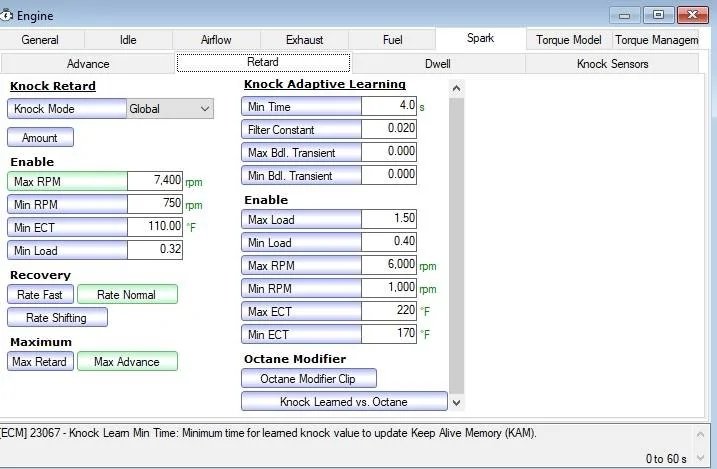

The adaptive octane learn takes time and repeated events for the ecu to store a set amount of KR for a given load/ rpm. Seems to be supported by what you guys are saying with a reflash as well (which i believe wipes the KAM where these things are usually stored). the process starts over again. see the attached photo, from a 2015 PP2 tune, adaptive knock settings are the same compared to a stock tune. but those are the parameters the ecu is working with.
i have not been able to compare the 2 versions of the ford pp2 tunes but plan to once i get to that point this upcoming year.

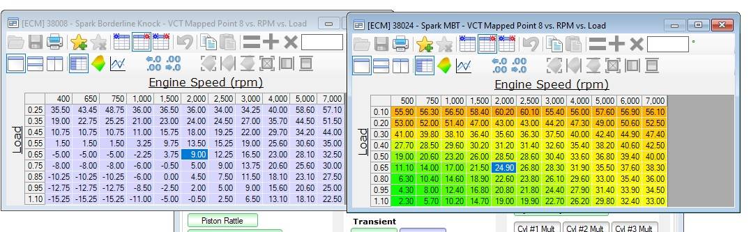

heres a random timing map from the PP2 tune, look at the highlighted cell on the left vs the right, the left table is a borderline spark table, as in borderline for knock given a known octane, in this case it should be 91 octane. this is higher load/low rpm area. you can see why these motors come alive or give the responsiveness they do with higher octane at low rpm ranges, (think e85). there is a lot of timing left to be had for MBT to be reached.
ideally you would want MBT to be the only region the engine is in for power output at all loads/rpm. its just not possible though.

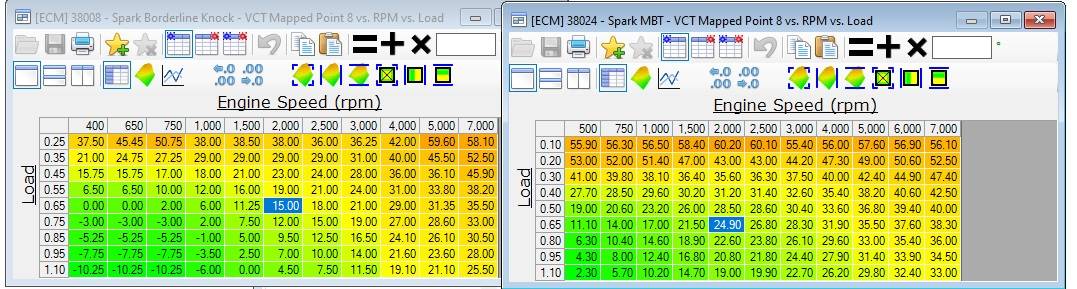

second photo is with a stock gt tune map on the left. even lower than the pp2 tune but i believe this is 87 octane optimization.
the best resolution as others have pointed out seems to be getting the motor more octane , how ever that may be. not a direct response to the OP post but at least you can see the nuts and bolts of what the pp2 is trying to do and why octane matters.
