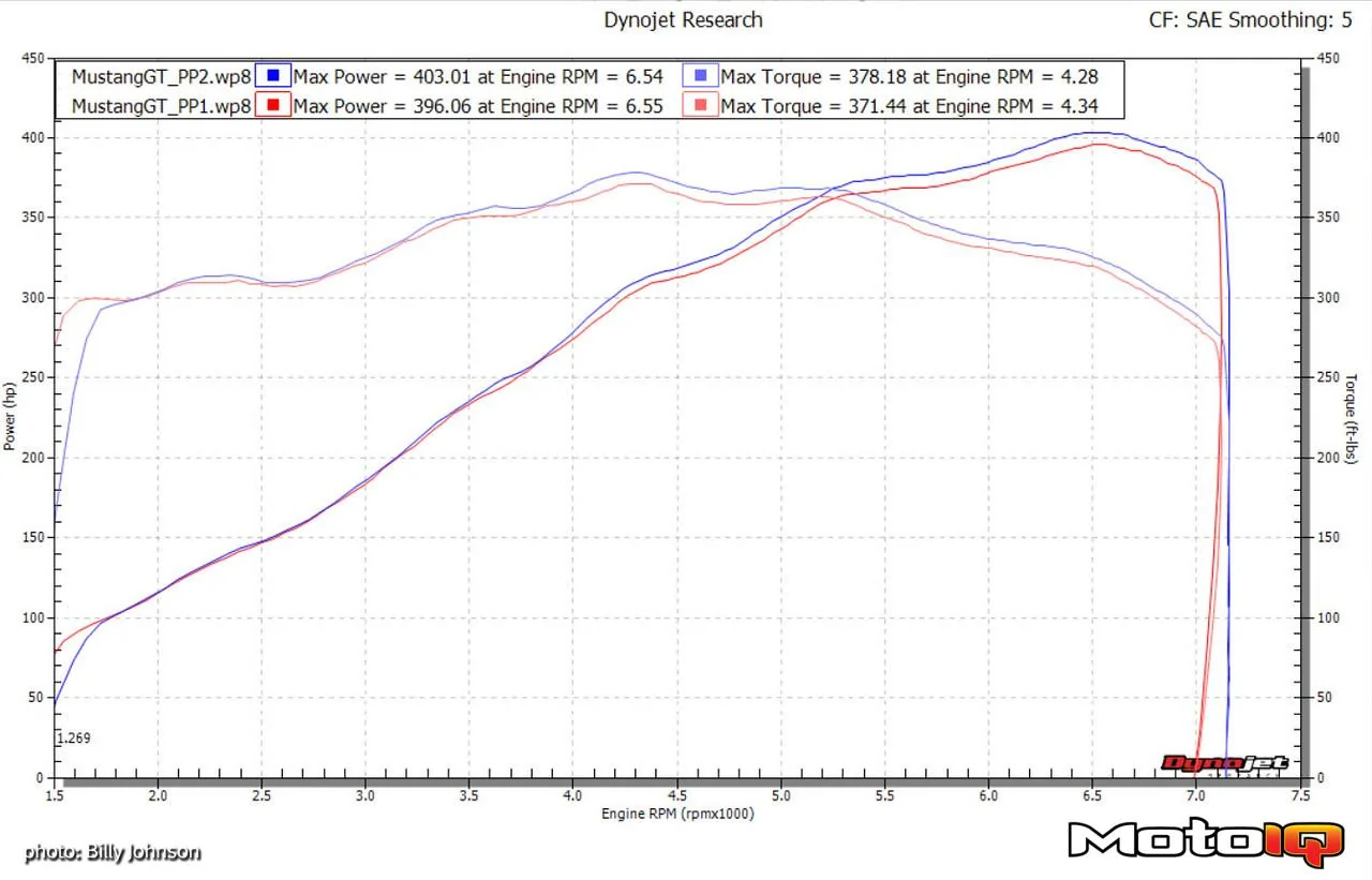

Here's a dyno of pp2 and pp1 as comparison. Your dyno curve does seem funky for sure. Since it was a mustang shop they should know what they were doing, but I there might be a small chance they forgot to properly disable traction control by pulling the plug or fuse and causing weird dyno results. Did they do that?

Well, I know I had a message about AdvanceTrak, and ABS when I got the car back that cleared itself' pretty quickly. They should know what they are doing- but i'm not sure. He seemed quite adamant it was pinging, and recommended I move back to stock. He was also able to get one clean run, but it took 3 attempts, so I'm pretty sure they did the dyno properly.
I did that today, and it is running much better, also the sound is gone..
I will definitely bring it up with Ford Performance, but I'm not going to install it again. If there's a chance it's a ping, I don't want to be damaging my motor..
That sounds like they didn't disable the ABS/STM/TCS...That would cause weird dyno curves

After hearing the rattle / ping, I got fed up and went to a local mustang shop. He popped it on the dyno and told me that there was too much timing below 5K rpm. I've attached the dyno sheet. He said it is not a rattle, but definitely pinging.

BTW that dyno graph shows an issue. It looks nothing like what it should on anything below 5,700 RPM. Torque is way down for even a stock car, especially in the mid-range right about 4k to 5k. You should see a double hump on the torque band.
Do you suppose...the calibration didn't' upload properly? What if your running the stock ECU calibration with the Power Pack 2 hardware...or is the flash didn't occur correctly and a few segments of EEPROM were left with the factory code.
Remember the Power Pack 2 calibration is a tweaked variant of the original ECU calibration. It's not a whole new architecture. That dyno indicates a problem. Do you by chance have a dyno of the car stock? You should get the done just to prove or disprove a mechanical issue.
If you get similar behavior then you should take it into the Ford Dealership as there's an issue even if it doesn't make noise stock, it may be running in a "limp mode" or reduced power mode. Maybe a bad cam phasor (the mid-lock cam phasors actually fail to mid-point, which is safe for operation to avoid damage but wouldn't obviously offer optimal performance).
