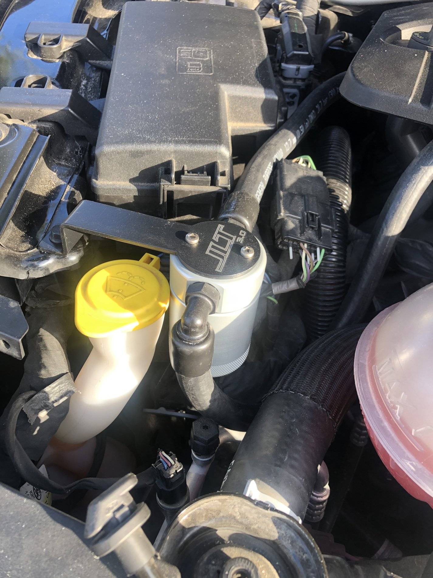

As suggested by others I'm now using the remote mounted JLT passenger side catch can. The only thing I don't like is that it's touching the windshield fluid reservoir.
Does anyone else have this installed? Did I do something wrong? Or is yours also pressed against the windshield washer fluid tank?
I'd keep an eye on it - UPR catch can in my previous car (not remote mounted which can make a difference due to proximity to the engine) was sitting on one of the hoses and started melting insulation until I put an insulating tape on it. I'll be checking periodically if this isn't happening here.

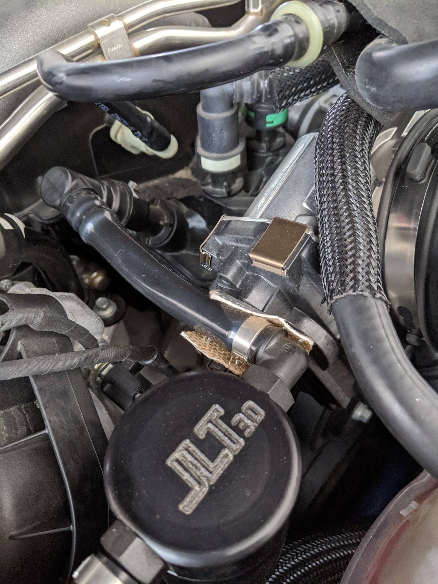

I have a JLT now which sits on top of the throttle body connector and just in case put the thermal insulating tape between them.
Thanks for the suggestion, luckily mine is only touching the little yellow cover lid thing and not the actual reservoir plastic, I'll keep an eye on it, I'm also gonna message JLT and ask them if I did something wrong because in their pictures the catch can is actually pretty separated from everything else.

I can't believe one spends some decent coin on a catch can and all you get is some nickel plated phillips head screws that'll rust? Wow JLT, just wow.

The catch can gets HOT too. Ask me how I know lol. I am going to check out the thermal tape, that would help by the throttle body connector. When I get my air inlet tube I'll sort all this out when I go back in there plus need to tape up the wiring I cut for the sensor to reach the air tube.

@kz I bought cool insulating tape from advance auto parts. Where did you tape? Thanks for help. That catch can is real close to sensor.
Just recieved air inlet part. Gonna put in later today most likely.

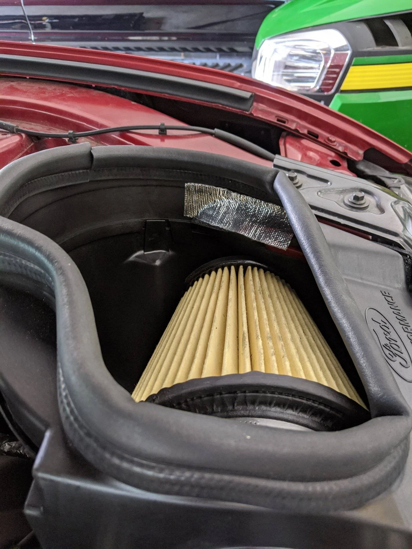

See below - I also taped side of the air box since there seemed to be a hole despite the foam seal.
It may be unnecessary but I'd like to think that replacing that harness would not be fun at all....
