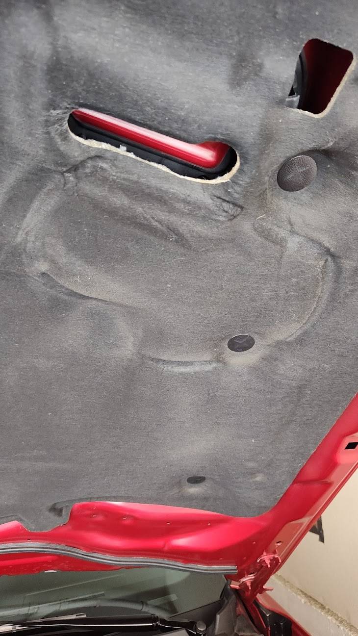

Look at my liner on how firmly the intake seals against the hoodliner.

Today on a 100 degree day, sitting at a light for only two cycles, my IAT got over 140F. We're talking a 35 degree increase in under two minutes. On top of that, when I went to take off, the car was running absolutely terrible like it was in limp mode. Maybe I could play with it to get it to seal better, but I'm doubtful. The stock box is MILES better for me. Sure, you can get to 140, but it takes 20+ minutes of sitting in a drive through, not two. In the same stoplight circumstance, the stock box might have gotten to 115, and that's being generous.
I'm annoyed. But going back to stock sucks :(

ice445... that's too bad i know my car will get 140 or so at the light but mine doesn't seal against the hood i have a Gt500 one and when I'm moving i only go up 5 or 6 degrees above out side temperature but i think it's has a lot better throttle response

Yeah, when you're moving it's great. But as soon as you stop, it climbs QUICK. I didn't mind until the car started running absolutely horrible. 93 would probably make it better, but I don't have access to that sadly. It's a shame because the car runs way better pretty much all the time otherwise.

Thats kind of weird...the CAI is the same box used for the Mach1 and the Bullitt. Those cars are tested in those weather conditions. My own car has hit 140deg F and I had no issues.

Technically its a bit different, the Mach 1 and Bullitt airbox is larger because the hood vent on that side is blanked off. But yes, it SHOULD be fine, but it's not lol. I mean it still drove, but you could tell anything resembling performance had left the building.
I suspect though that if you ran straight CA 91 with no race gas or ethanol included, you might see something similar.
