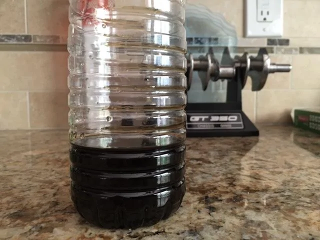

I had over 5oz of oil in my passenger side separator between oil changes, which was less than 2500 miles.
