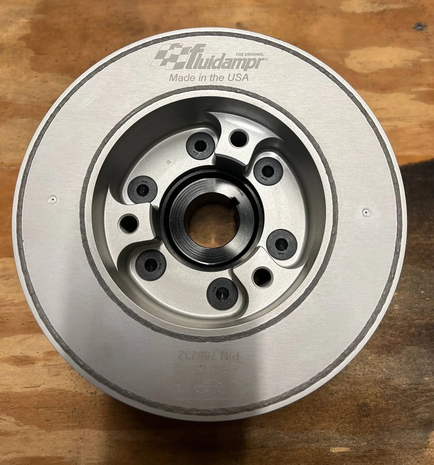

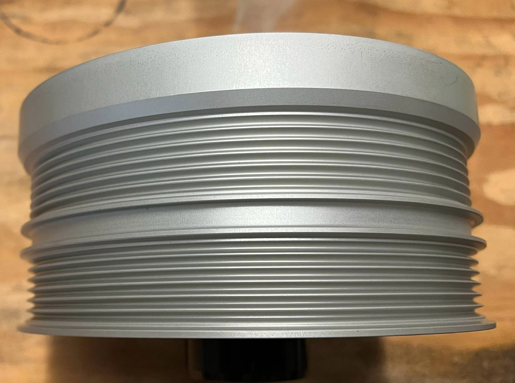

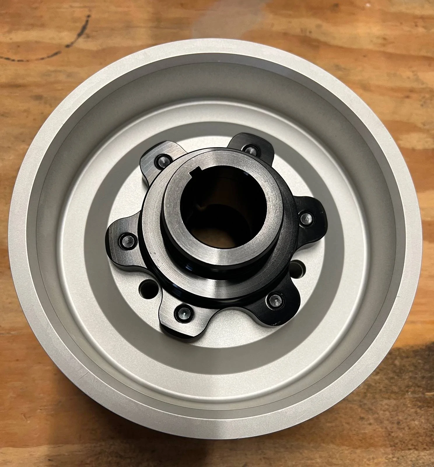

Got it today. 10.2 lbs on my $30 bathroom scale. Looks like a nice piece.

Looks like a really nice piece!
