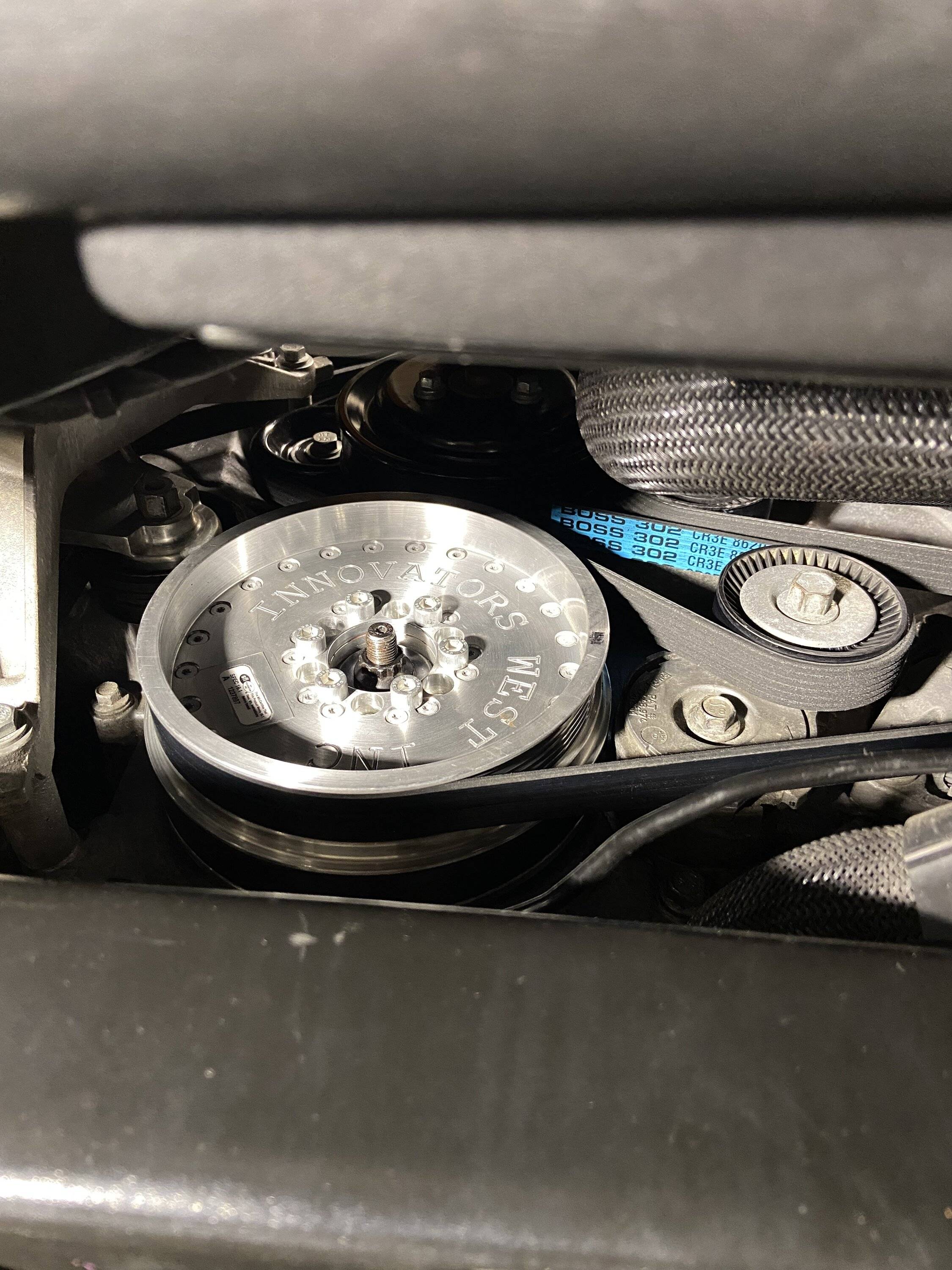

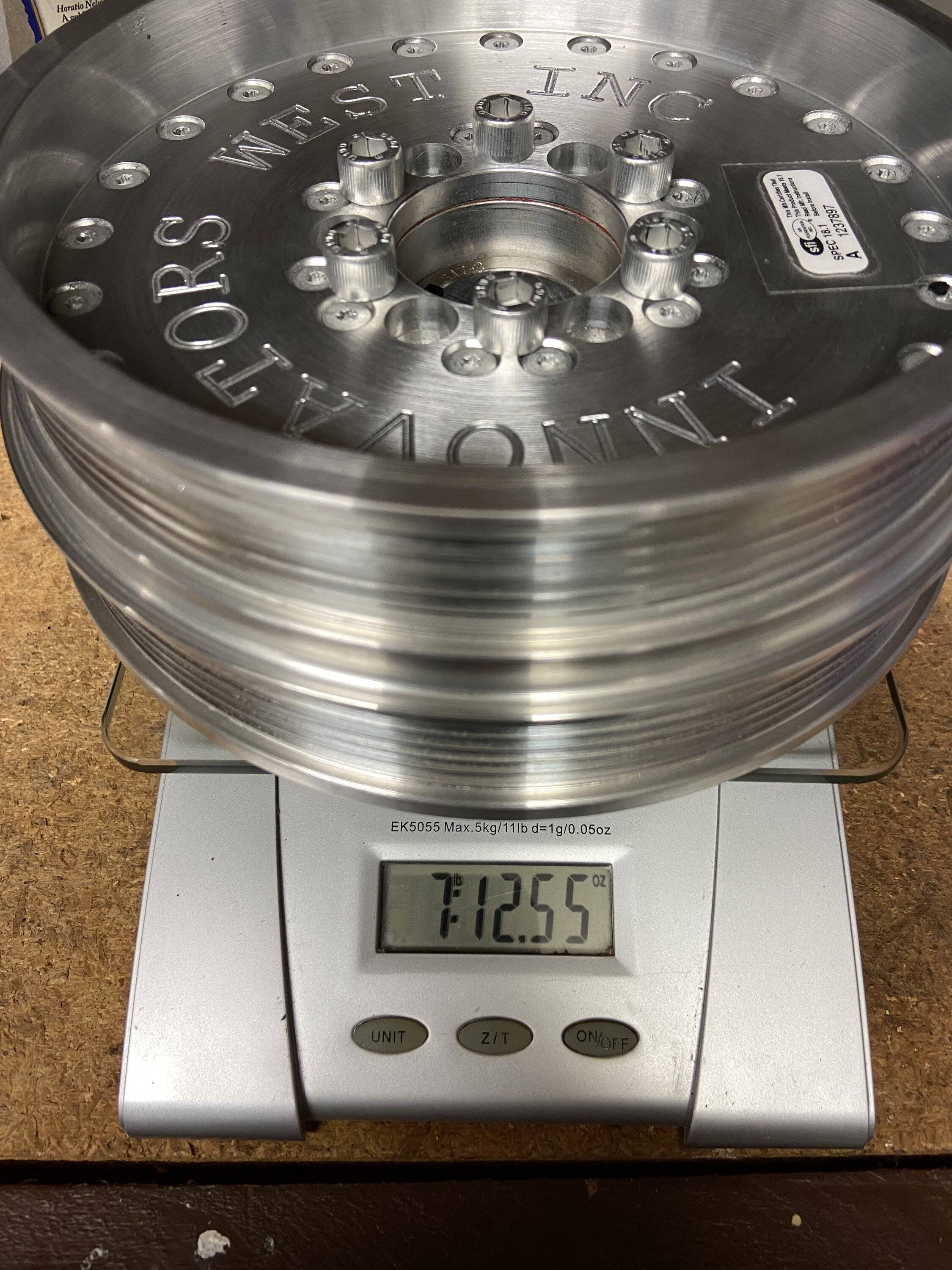

Just for completeness, Innovators West makes a nice balancer. Mine came in at 6.4lbs lighter than my stock balancer.
Cory S
Dec 10, 2019
3,355
3,751
Bradford, NH
Cory
2016 Mustang GT Premium
Beautiful pieces. Mine was exactly 4.2lbs lighter than stock.
