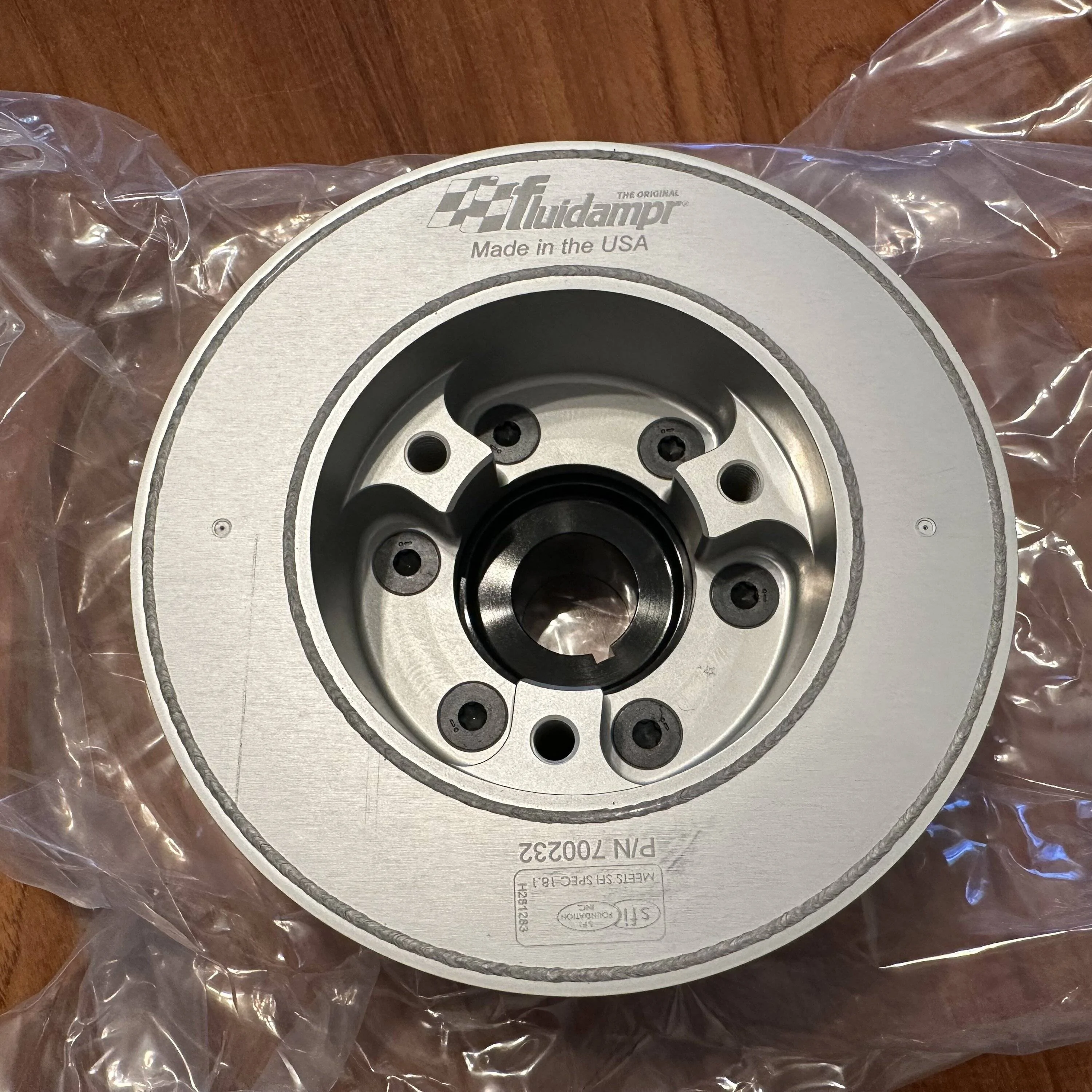

Direct from the fluidampr site
PART #700232
FitmentFord 5.0L Coyote Engine.
2011-2022 5.0L Mustang, F-150 & Crate Engines
Bore DiameterØ1.249"
Degree Marking RangeN/A
Degree MarkingsEngraved
Engine BalanceInternal
FinishPulley - Hard Coat Anodized
Adapter - Black Zinc Coated
KeywaySingle
Length3.90"
MaterialAluminum Pulley
Steel Adapter
Drive Belt TypeSerpentine
Pulley Grove Quantity6 rear, 6 front
Mounting Hardware IncludedNo
Outside Diameter7"
Safety RatingSFI 18.1
Weight / Rotating Weight9.9 lbs / 6.6 lbs

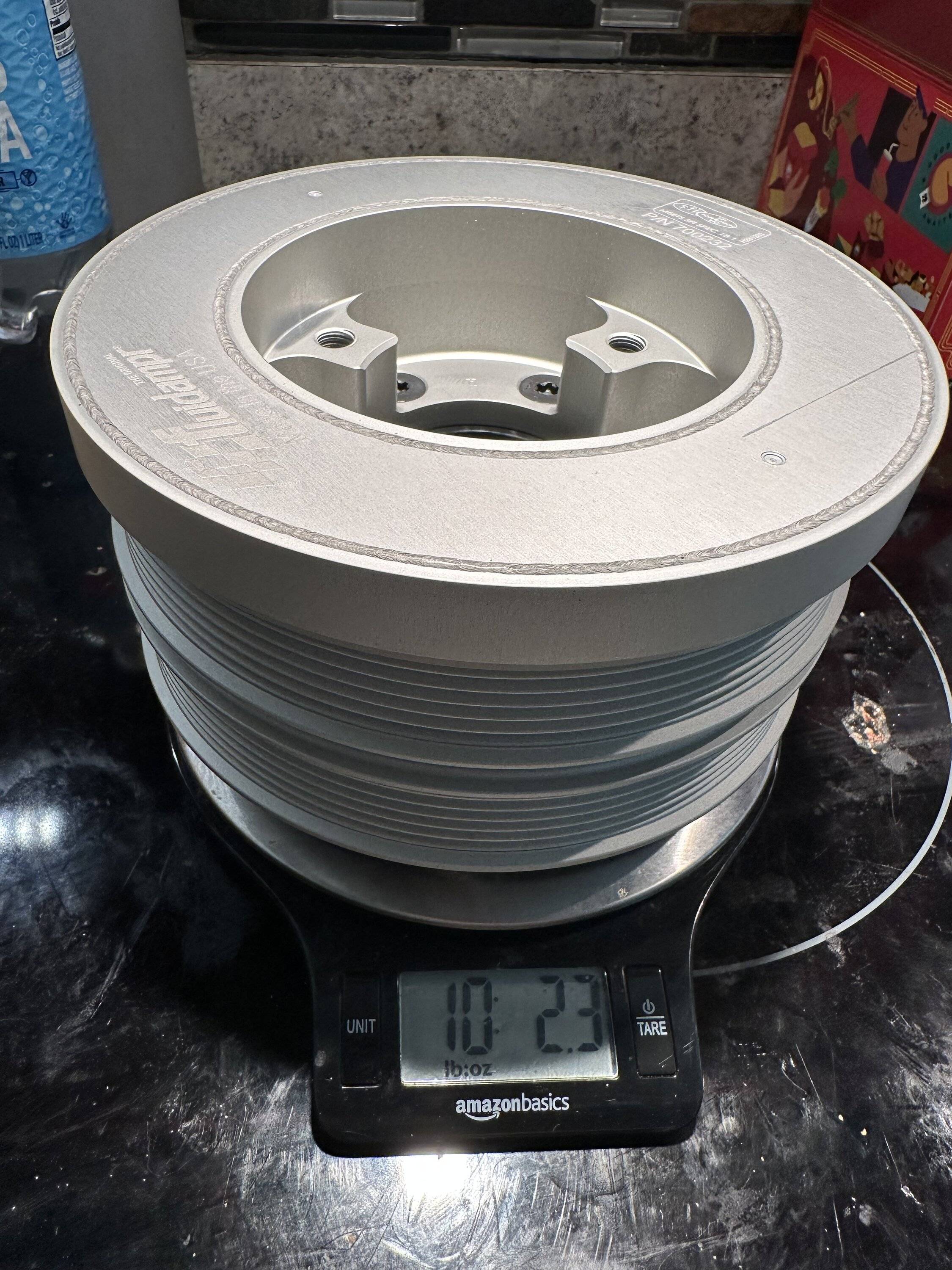

Weighs 10lbs 2.3oz according to my crappy kitchen scale. I got a “blem” unit with one scratch, direct from Fluidampr for less than $500 shipped.
That is a nice piece.
Would be nice to take some weight off the front of the crank. 18+ cars have this GIANT weight for a damper. IT's ridiculous.

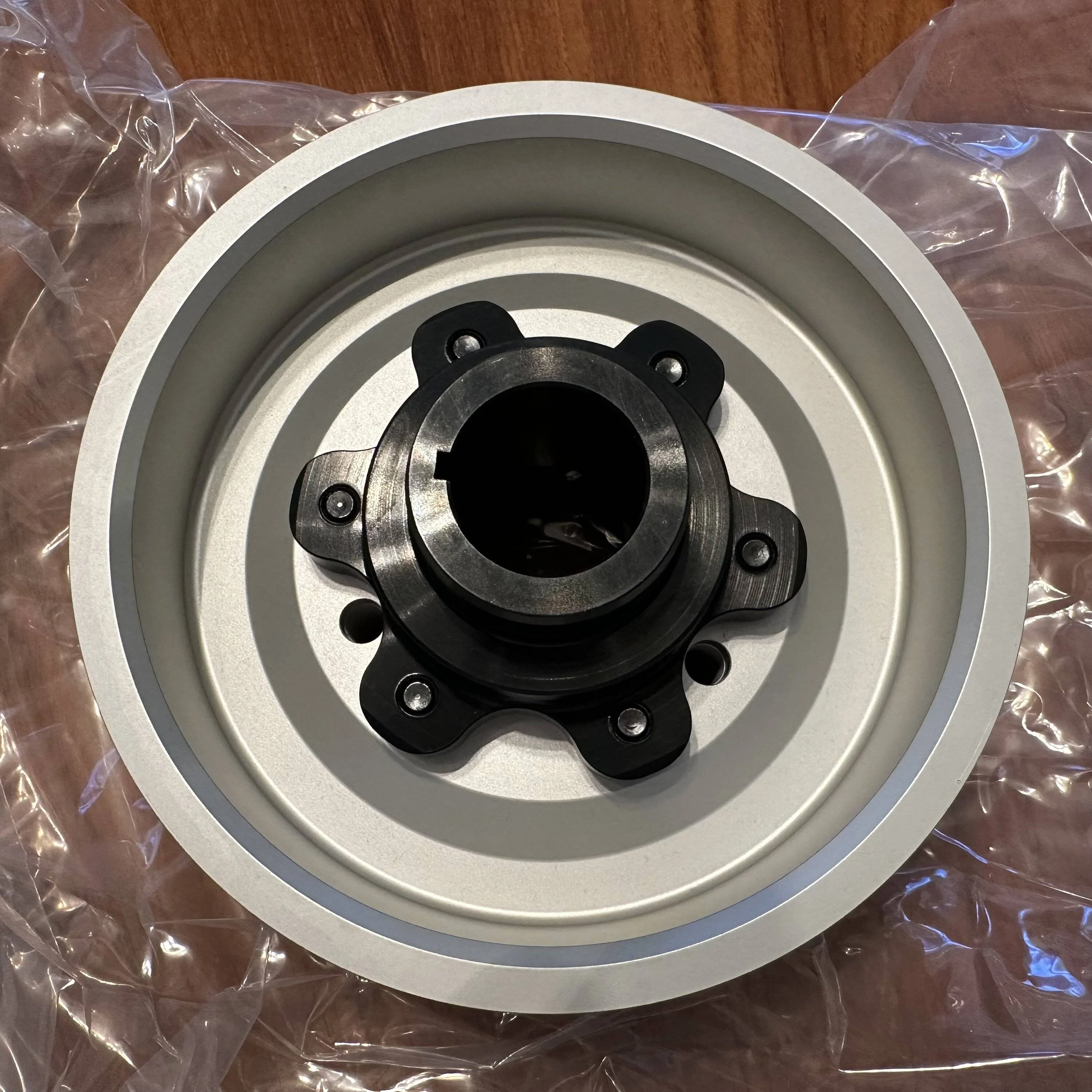

Thats a really nice looking unit! I am assuming its the oem diamter and number of ribs both front and rear?

Thats a really nice looking unit! I am assuming its the oem diameter and number of ribs both front and rear?
Supposed to be OE diameter and some of 1G/2G Coyotes had a 6/4 rib setup, and some were 6/6 rib - this one is 6/6 so it'll work for either.
