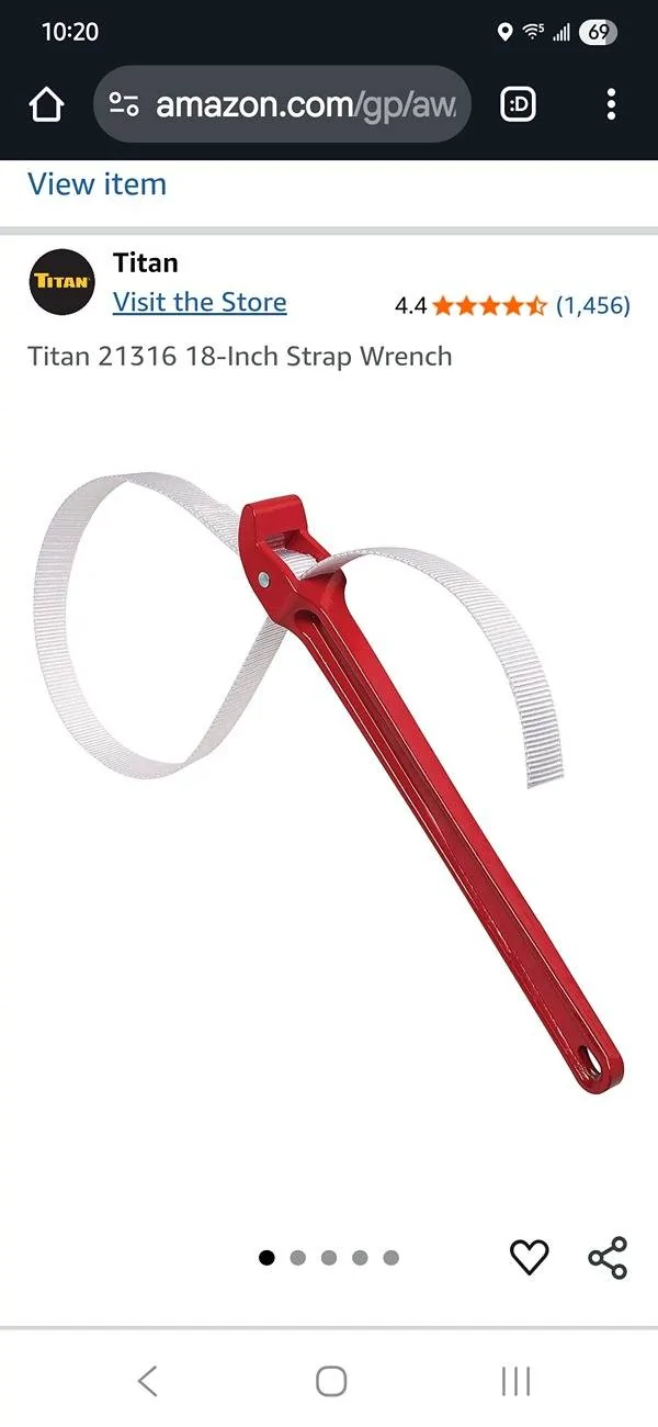

I used a 18" strap wrench which I slid a 1-1/2" steel pipe over the wrench handle for more leverage and had a friend hold while I torqued the nut with my 1/2" drive 25" handle torque wrench. Just make sure you used extreme pressure grease on the threads, washer and nut face as directed. I never use a impact wrench when installing crank bolts. Good luck
Jjmoberg
Aug 3, 2022
443
566
KC, MO
Jeremy
2022 Mach 1
Nice. Thanks! I will order that wrench and I have 2 packets of the ARP grease. One came with the Kinetic kit and one with the ARP bolt I ordered to get the washer.
