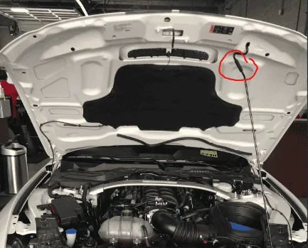

......Then I got the hood struts. And FML they are so nice. No longer burning my had between runs. Who woulda thunk it.
I 100% agree with the hood struts comment.
My GT350 must be super special. It has a fancy rubber thingy on the prop rod so I don't burn my hand when I use it. :cwl:
All jokes aside, I really like the jacking rails and I'm sure I would own hood struts if I ever saw some in person. :thumbsup:

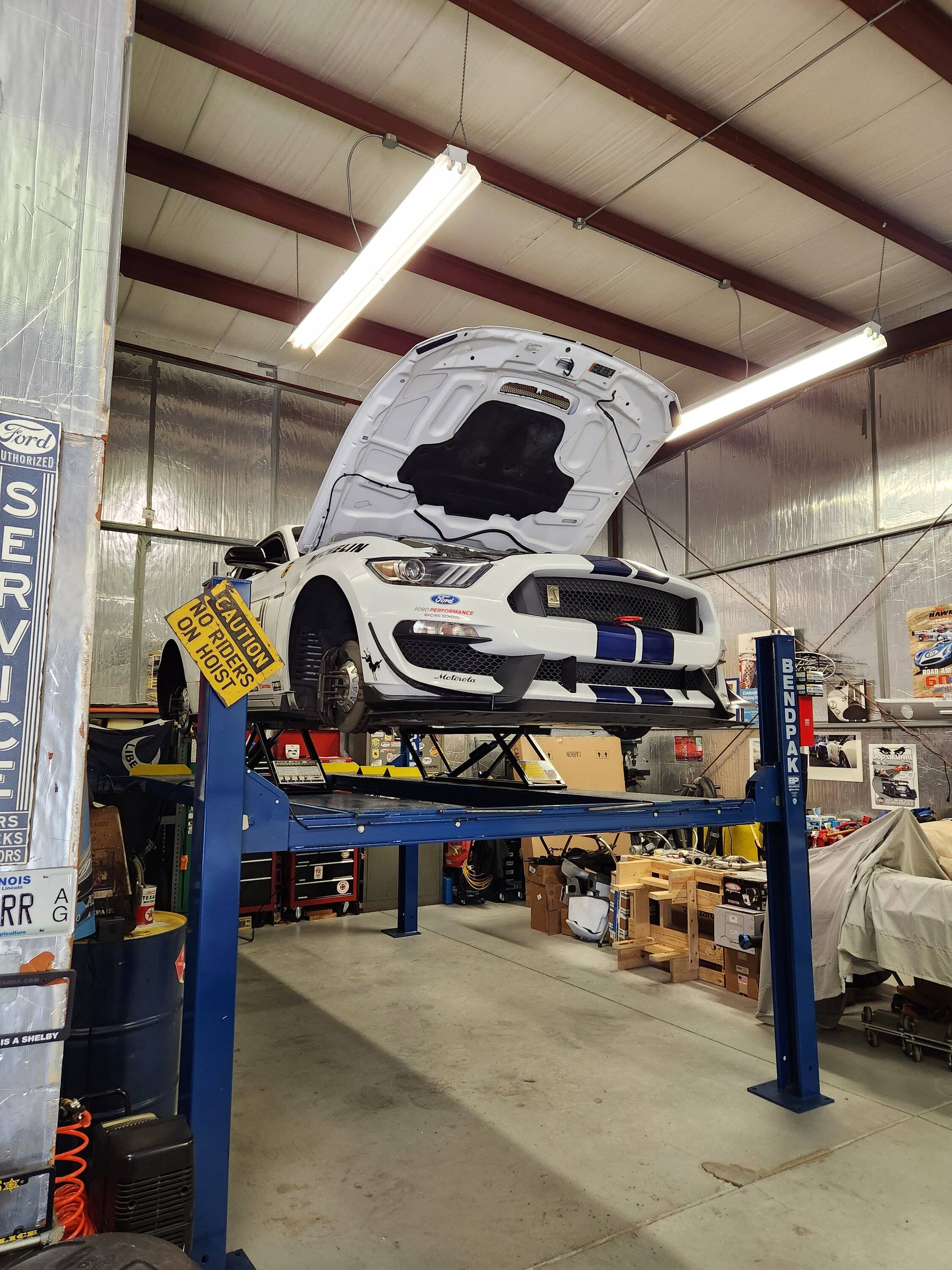

I have the Quickjacks, as well, and they are a great addition to a four-post lift. With both, I can work on the Mule on its suspension and also with the suspension at full droop.
I used to do this by using a combination of floor jacks and jack stands on the lift..... which was somewhat questionable from a safety standpoint.
When not in use, I just disconnect the Quickjacks from the pump and store them on the jack bridges in the middle of the lift so they are out of the way from an on-off perspective.
This pic is with the Quickjacks at just the half-way point.... they'll put the car 2' in the air.

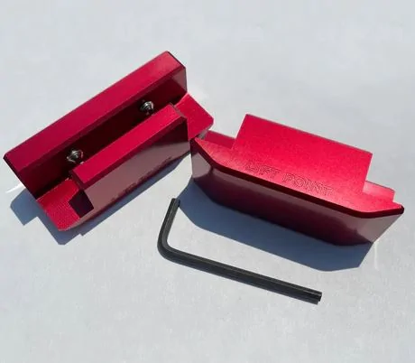

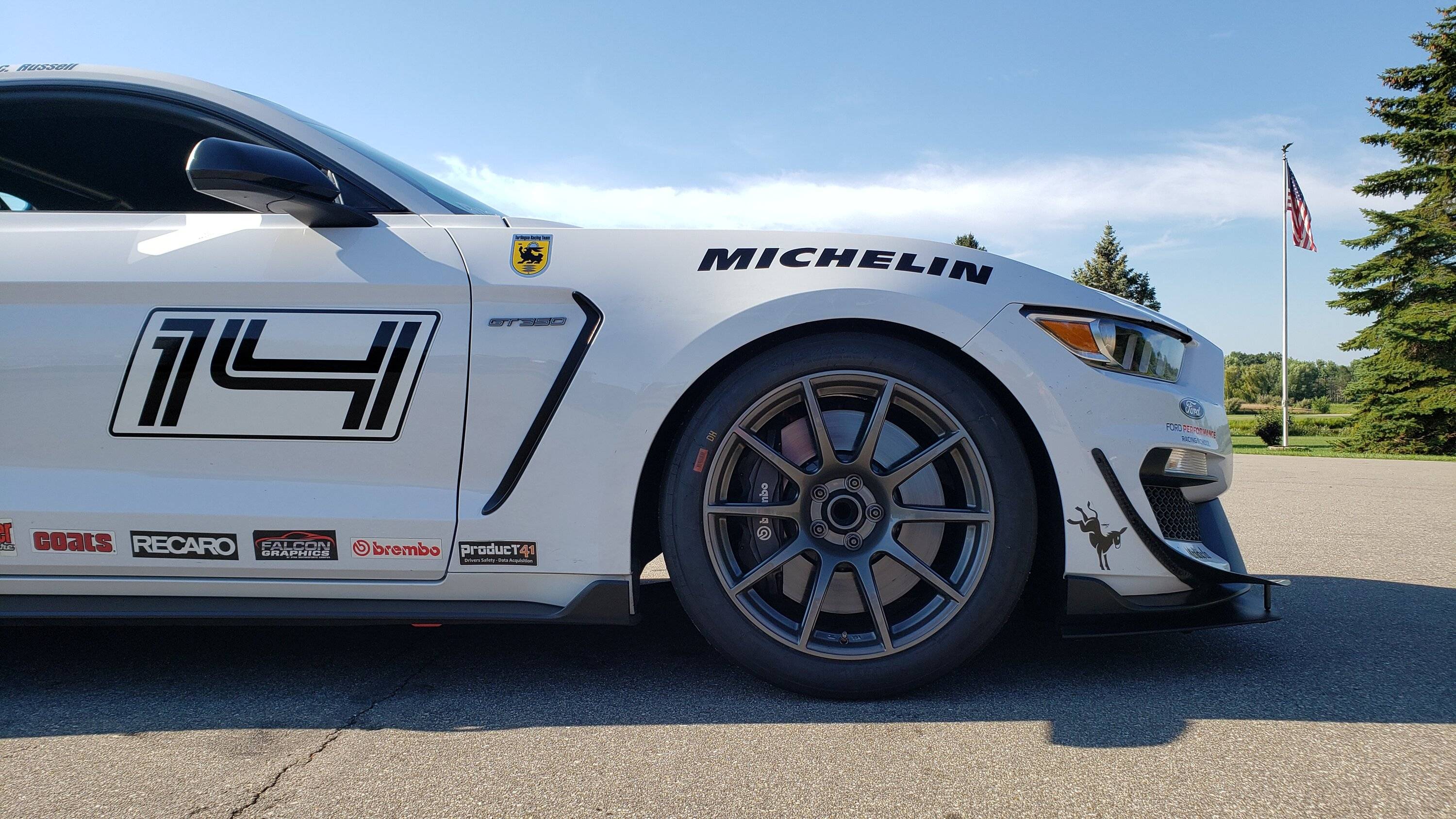

In this pic, below the Brembo sticker, you can see just a little bit of the red anodized ZL1 Add-Ons "Stealth Lift Pads" that I added to the pinch-welds at the factory lift points. The Quickjacks come with large rubber blocks that contact these lifting pads, making for a no-fuss operation.
Here's a pic of the lifting pads from the ZL1 page.....

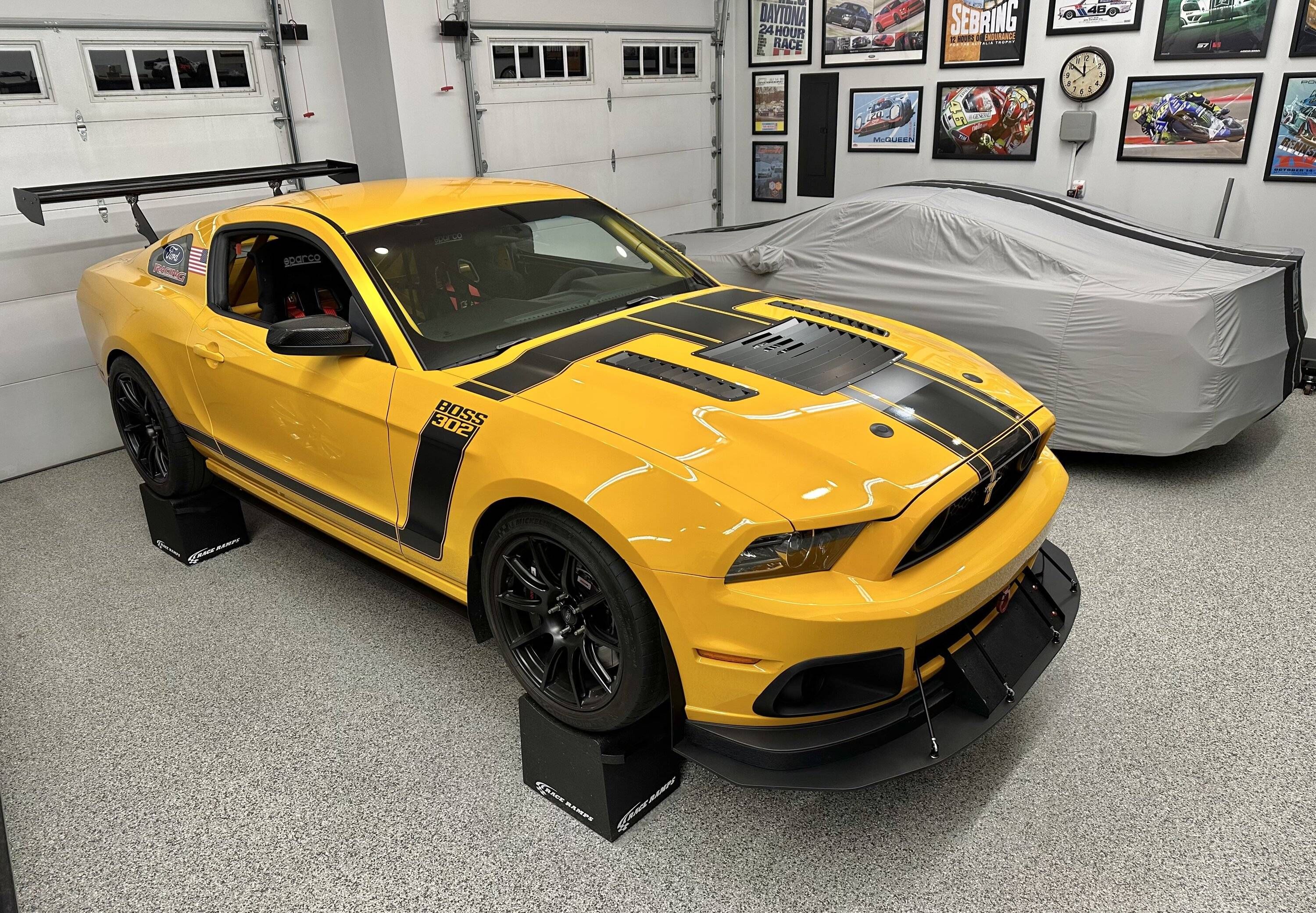

My preference is jacking rails on both the Boss and the GT350only because they spread the load out when I lift the entire side of the car with a high lift floor jack in the center. I do not think I would trust a pinch weld block in my case. This allows me to use Race Ramp blocks instead of jackstands which are in my way most of the time. When I need to work on one of the axles I just use a jackstand on that corner. I don't mind the dead weight when I could just lose 20 pounds...:cwl:
