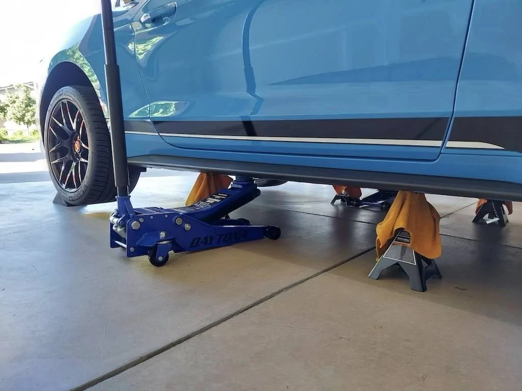

Whatever you decide, use a combination of jack and jack stand, to add an additional layer of safety. Wheel chocks can also be worthwhile.
In the photo below, the jacks are perpendicular to the car, to reduce the chance of movement. You can also see one of the wheel chocks. After the car was lifted and on stands, the jacks stayed, just resting under the car.
