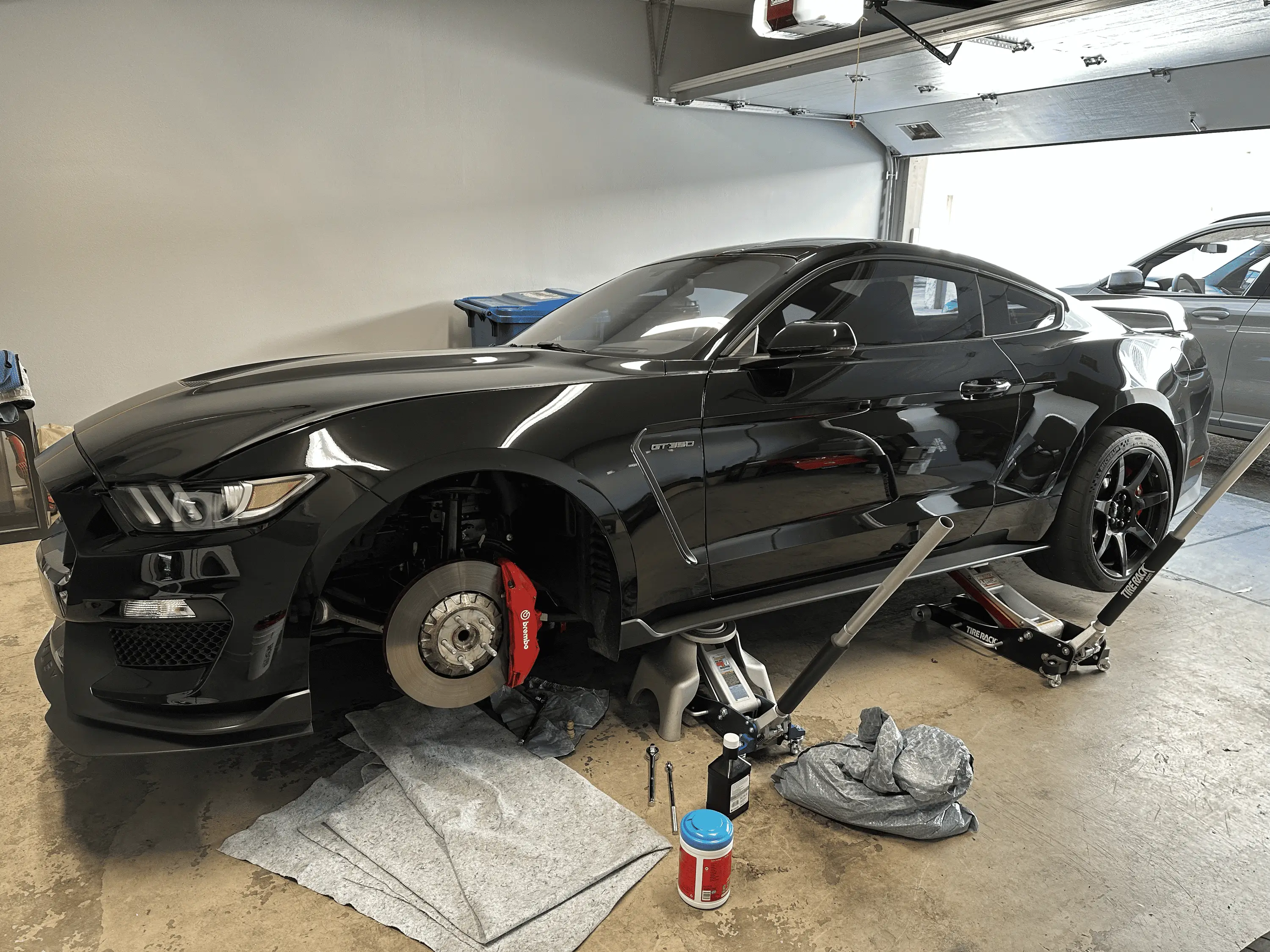

And that’s what I don’t understand about the need for jacking rails… I do the same thing with a $15 pinch weld jack adapter
The jacking rails allow me to place my jack under the middle of the door. Raise the car high enough to put two jack stands on the rail. Lower it onto them and then repeat the process on the other side. Car goes from on thr ground to all 4 wheels off the ground faster than you can roll out and set up a quick jack setup.

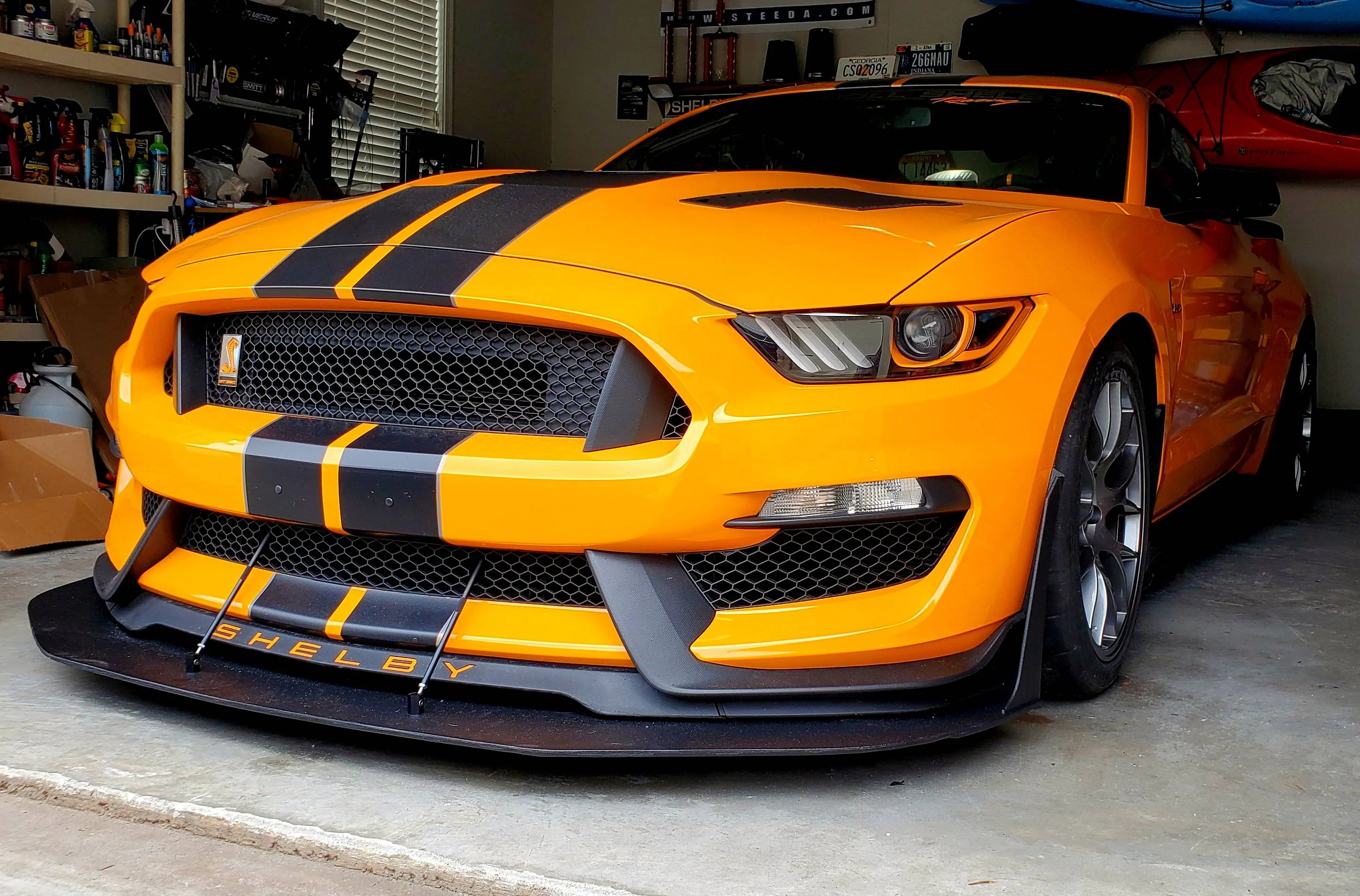

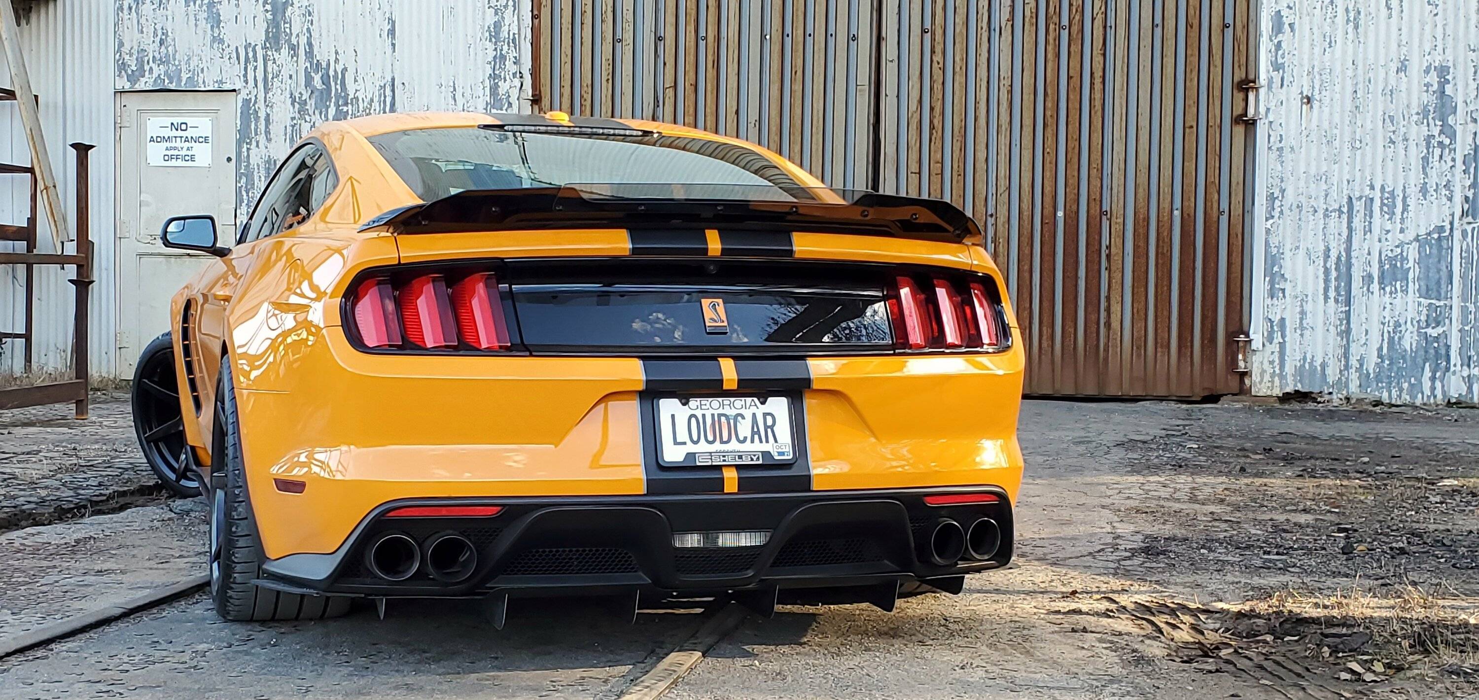

If you don't have a good surface this can absolutely be a risk. My floorjack rolls smoothly on my floor allowing the car to pivot on the jackstands while the jack moves as opposed to having the jack stationary and the car moving.
I also have no way of getting to any good jack point from the front of the car to lift it up from the front/center. I'd also hit all of my aero on the ground as soon as the car took on any angle due to the front splitter and rear diffuser.
