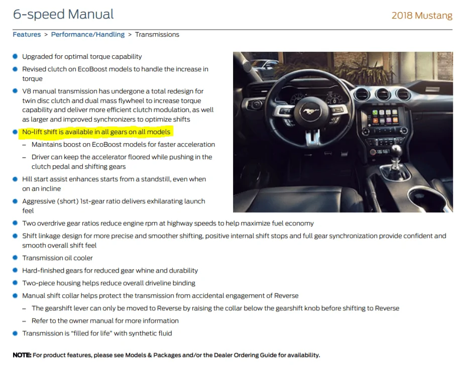

The NLS feature is on all 2018+ manual transmissions. Nothing special about the Mach 1 or Bullitt.
WRONG
2019+ got Rev matching, even though 2018 was supposed to, it never got it.
NLS was in the 2018 paperwork but was NEVER actually added to the car, including the Bullitt, until the Mach1. The Mach1 is the ONLY v8 Mustang known to have NLS.
Not true unless there’s something special you have to do to enable it. I have a 2020 and I NLS it quit often and there is DEFINITELY no modulation from the computer between shifts, it bangs the rev limiter any time I NLS around 7k.
Can confirm this is NOT true. Benefit of doubt though, what's the procedure for making it work?

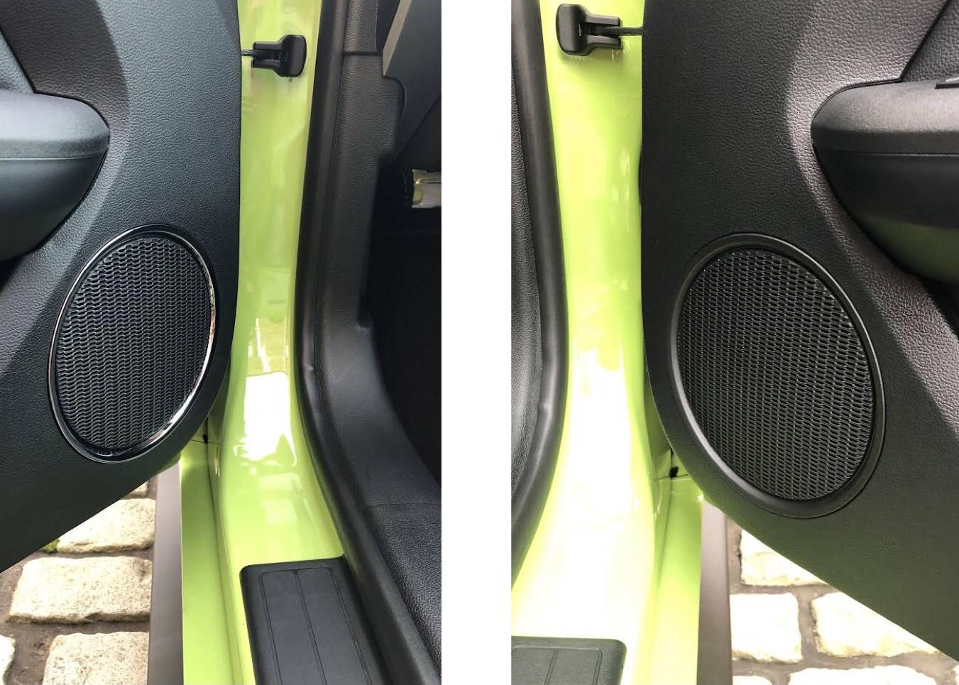

Hell, look at all the fuckups on the cars in general made on the US assembly line, Some people gets cars that aren't even fully painted. Lets not call out the Lazy AF US workers that let a car go through and NOT notice that only 1 seat is leather, or that the wheels may not even match or that bumpers are drooping. Nah. Totally cool to ignore that. It's not as fun to call out your own countries lazy AF workers.
Can we add miss matched door cards to your list ? :facepalm:

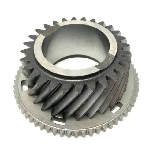

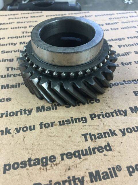

Here's a picture of 3rd gear in a M-22
Here's one from a MT82
One's 27 teeth - one 28 teeth.
