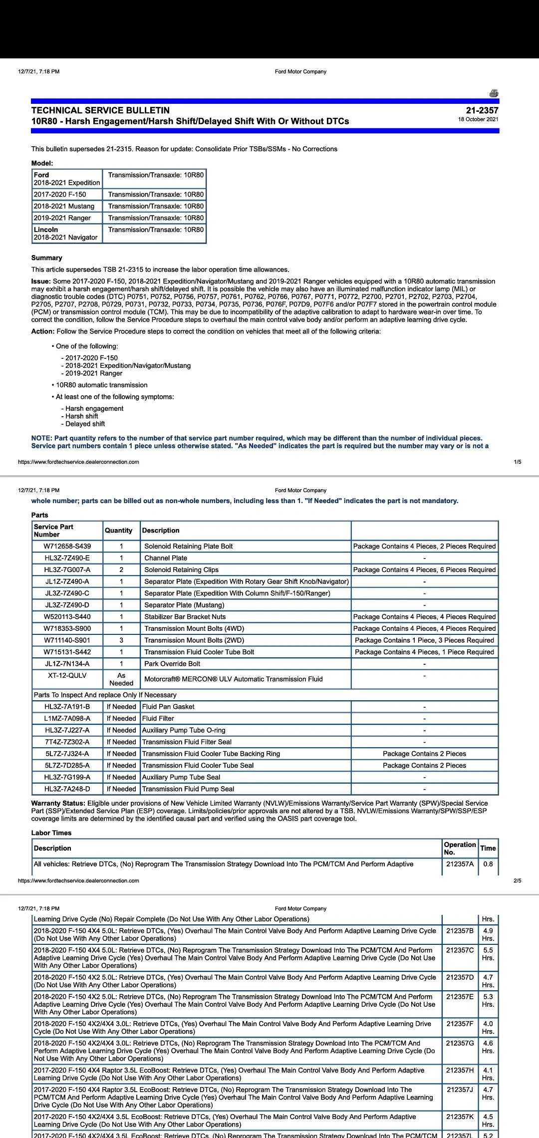

I'm not sure which cars it applies to but I think there is a recent TSB for replacing the valve body on transmissions that are having this issue. It is supposed to shift harder in sport but how much harder seems to be a matter of opinion. If you look towards the end of the 10r80 mega thread you should be able to find it. My car shifts very hard in sport ('19 GT) and I'm planning on taking it to the dealership once roads clear in MN...
