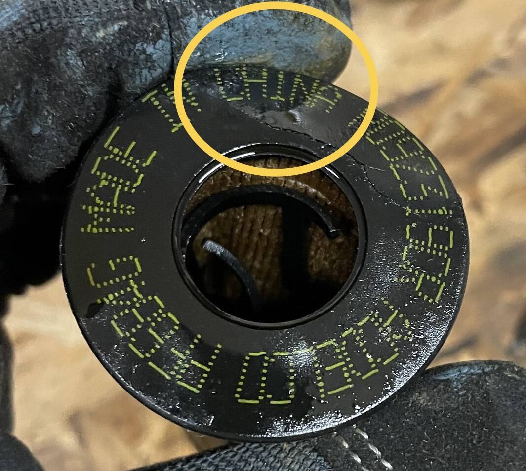

Fathouse made that claim once but only one pix of an improperly installed filter was provided. It was installed crooked and crushed by the housing.
I circled where the nipple was imbedded in the filter.
For the record, I don’t use any of those Motorcraft filters. I only use K&N in my cars.
BTW: If you order KR3Z-6A832-A filter housing, it comes with the one you are craving. I have a few of those in case I drop and crack another one. Might sell the filters separately on eBay. šŸ˜‰
I remember seeing them weigh in on another discussion somewhere with other photos. And there was a ton of fanciful speculation about this particular photo/instance. Bottom line is that when FH weighed in and said they'd observed it more than once, and combined with the fact that Ford themselves CHOSE to develop the 2087 spec with a supplier and then update the GT350 spec AWAY from the 2062A, I'd take all that as circumstantial evidence that there's more than just internet fear mongering ongoing. There was obviously something flawed with the 2062A that prompted Ford to go away from it to a MORE EXPENSIVE filter in the 2087. Now the question becomes, whatever drove that action, is it resolved with the 2087A. The fact that the 2087 is synthetic vs cellulose may have been enough to increase flow and reduce pressure delta with the same polymer frame. Who knows. But Ford wouldn't have changed the GT350 spec if wasn't an issue.
The real question to me is, did Ford due the original full durability/environmental, etc.. testing on the predator with the 2087, and if so, did they really do that much testing upon "updating" to the 2087A?
Would love to give Ford the benefit of the doubt, but I've had WAY too many premature failures on all kinds of crap on my new Fords, going back to around 2014. I attribute a lot of it to Ford cheapening up components, overall.
The 2087A plastic cage certainly looks thicker than the metal cage on 2087 (hence maybe it is stronger than it looks compared to 2087), but 2087 also has a metal mesh right inside metal cage, that 2087A does not. One other thing I notice is that 2062 has a much less robust plastic cage, vs the 2062A.
