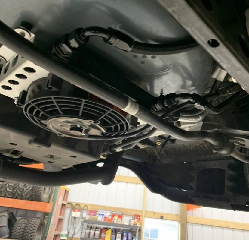

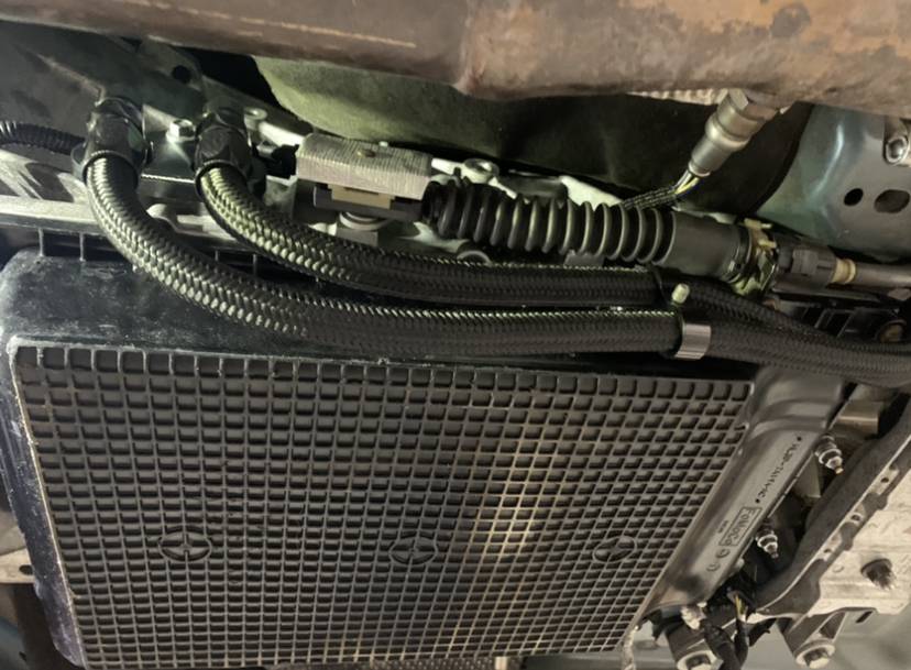

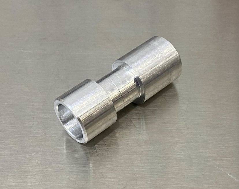

welcome to the world of destroying 10R80’s šŸ˜‚. I’ve been through several now. Probably $9000 worth. I keep a spare trans on the shelf along with a new valvebody at all times. I run extra clutchpacks and have still managed to chew them up. I now run a thermostat bypass in the valvebody and an external cooler out back and try and keep temps under 170. Ford likes them to run hotter, but the clutches under power like to stay cooler. So far this combo with the cooler has held up the best at 1000whp.
