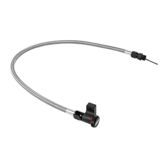

Well I ordered the B&M dipstick for my 2018 PP1, the real issue is that the hose/tube is to long and there is really no way to shorten it, so I returned it.
I built my own and it works great, the best part is that I can easily add fluid as needed, if needed.

There was no way to route the hose to make it work?

At this time here in Denver we have a stay at home order so pictures of my dipstick install will take a while as my car is at our shop.
But, I talked to a guy that used the B&M 10R80 dipstick on his mustang and he routed the tube/hose over the top of the trans to the driver side of the engine bay, I never thought of doing that, I tried mounting mine on the passenger side of the engine bay and the hose was way long for my liking. He told me that he made a bracket that mounted to the K arm on the drivers side. I have asked him to send me a picture so I can post it. Soon as I get any info I will pass it along. The B&M dipstick is a great item and made very well, I never thought to mount it on the drivers side.

You may want to check with Lokar as well. They have many transmissions to choose from if you know the I.D. of the 6r80 dipstick hole and can size up one of their offerings.
I've used these in the past and they work great and usually sit lower on the firewall

Don't know if anything will come from it, but i emailed them to inquire about one for us 18 plus Mustangs. Or if they have a suggested hose routing for us.
I will update if i hear anything back.

Did anyone try the b&m transmission dipstick kit yet?
A kit different from what is discussed above? It was tested and found to be too long when mounted on the correct side.
