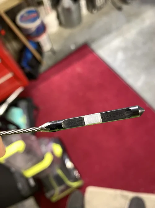

Thanks very helpful. I decided before I put my dipstick and plug back in my A10 i would take some measurements and make a quick rough shop drawing.... I am including it here, maybe it helps, but no harm in posting it.
Decided to run all dimensions off the seating flange where the sealing ring is on the factory aluminum cap/plug ...... The photo is sort of self explanatory with the plug and dipstick in the photo over the drawing....

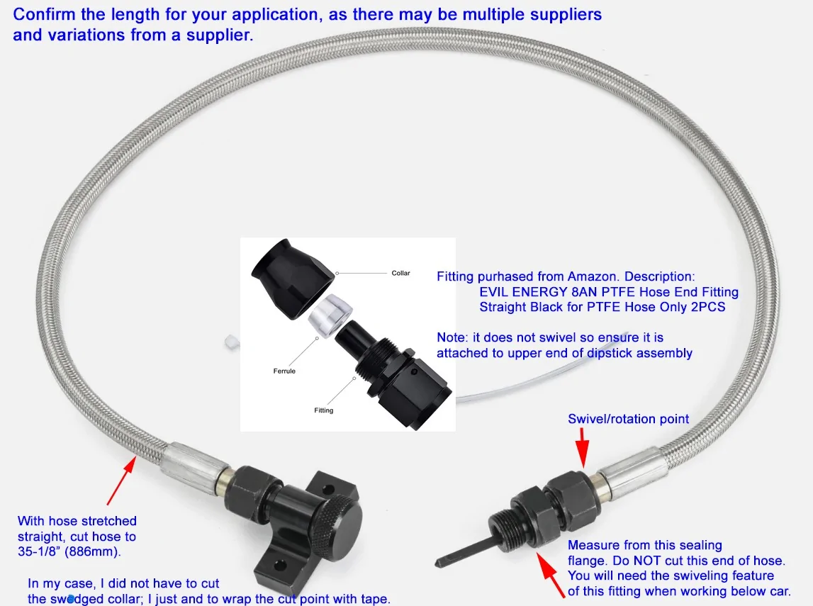

Good news! After removing my modified dipstick hose I learned that my main issues were related to the retrofit hose and fittings purchased off Amazon. The retrofit hose I purchased was much stiffer than the one supplied with the eBay dipstick. The second significant issue was that the retrofit fittings I purchase do not spin/swivel when tightening, therefore, the hose was spinning close to the transmission, but not up the firewall. As a result, there was non-visible internal twisting and collapsing of the PTFE tube. So after @cjatrains mention of modifying the eBay dipstick, I investigated. Wah Lah!!
There is enough length in the eBay dipstick to cut it shorter as needed, without having to cut into the swage collar. See pic.

VERY COOL, and that graphic you put together with Dimensions/Details is Awesome !!!
It's also good to know that the eBay knock off fitting at the transmission port does have the swivel feature. Reason I say that, at least I'll have the option of unscrewing it and going straight into that port with MV7300 evacuation pump and pumping the 7-8 quarts back in through that port if decide to.

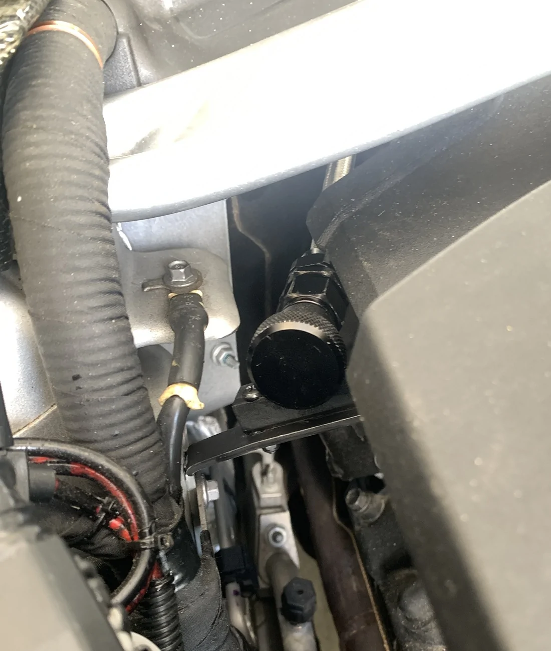

You can see below that I mounted my dipstick cap/access under the shock tower cross brace on the RH side near the fuse/battery boxes. It seems to be a good location for good access, yet somewhat hidden from a prominent view.
It is secured with a fabricated bracket that shares a harness standoff screw. The standoff bracket is made from 1/8" x 3/4" x 6" aluminum bar stock.

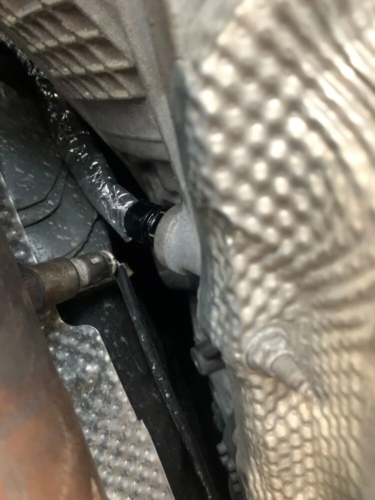

Here's a pic of the transmission-Catalytic Converter location. I had to be careful to not damage the converter wires with my wrenches. Note that I slipped heat shielding over the hose. It may or may not be necessary with the stainless braid hose because the PTFE tube inside can withstand 500 degrees F. If I had used the nylon braiding near the converter like I originally attempted, I suspected that shielding might be a good idea, as the nylon melting temp is 400. degrees.
