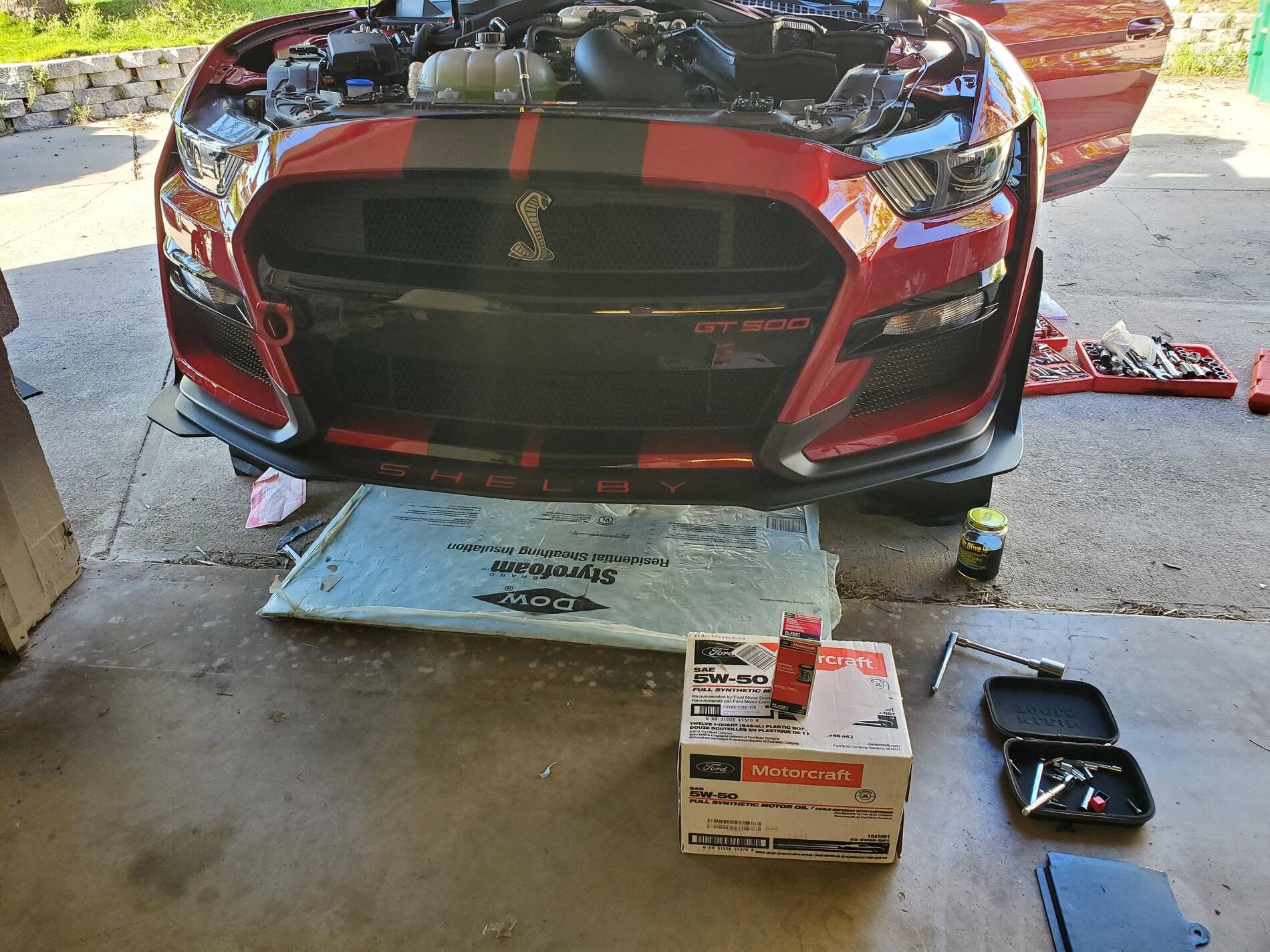

So today I changed my oil in my GT500. Typically what I do in my GT350Rs after an oil change or if the car sits for a while is to hold in the clutch and press the throttle all the way to the floor. This results in a failed start attempt. I do this twice and the oil pressure builds up substantially.
Today i tried this trick with the GT500 after an oil change. After 3 start attempts, the oil pressure got up to about 60 PSI. I then started the car normally. There was no delay in oil pressure like you would see after an oil change.
To me, it seems that turning the car over primes the oil system and the engine is not running without oil while the OPG primes and pumps.

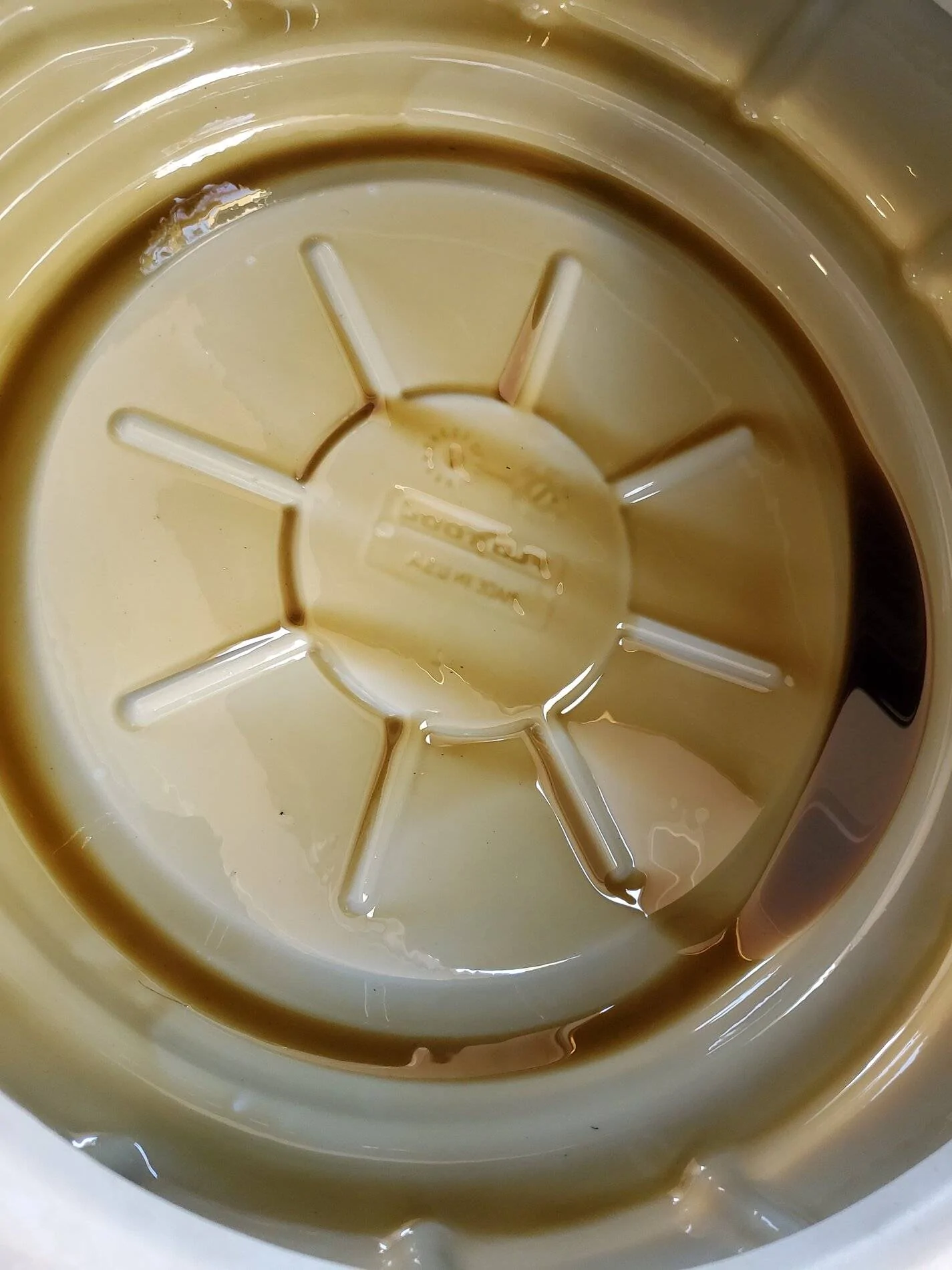

I have caught the oil coming out of the oil filter during a change. I poured it back into the he old filter and had about a 1/4 cup left over.
If the new filter is full the system is missing about a quarter cup on a gen 1 coyote.
I would lean towards just firing the car up because the question is longer slower rpm time without oil vs shorter higher rpm time without oil. I personally would lean on residual oil lasting a short time and just go with startup. Don’t know that it really matters either way.
Yes, I considered all that. There is residual oil all over the critical parts and wear isnt a huge concern, but as you mentioned, there is a lot of oil needed to fill the filter canister. The belly pan makes a canister prefil very dificult without making a horrible mess.
