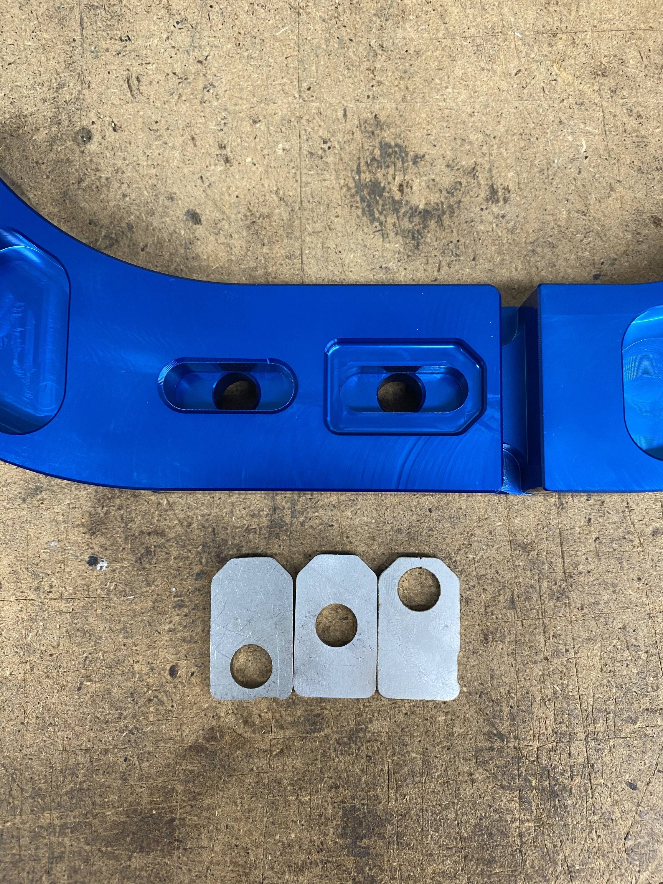

The tabs are how we change the length of the arm, they are laser cut from 11ga stainless steel.
The arm is a two piece design, the “arm” has two fixed transverse bolt holes, and the “end” has two slotted holes, one of which has a recess cut for the tombstone shaped tab. The arm and end mate together via a tongue and grove design, one bolt is used purely to apply clamping load to the two pieces, the other retains the tab. The bolt that retains the tab locks the arm in position.
To change alignment, street to track, all that needs to be done is loosen the rearward bolt, undo the tab retaining bolt, swap in a new tab, slide the arm into alignment with the hole in the tab, toss that bolt and nut back on and tighten them both up.
The tabs are all the same shape, they only go in one way, the only thing that changes is the bolt hole location along the length of the tab. I.e. increasing or decreasing the length of the arm.
As shown in the picture from left to right (-9mm,0,+9mm)
