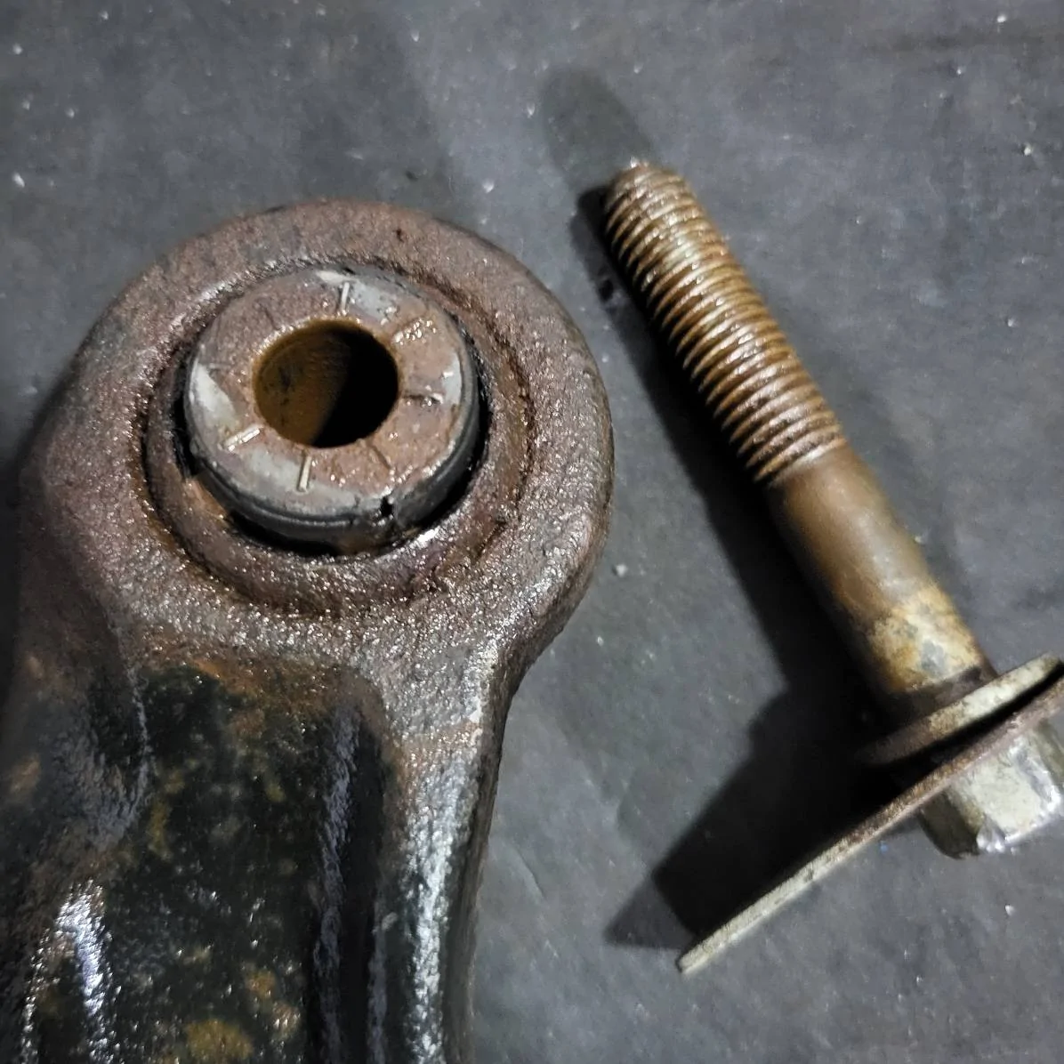

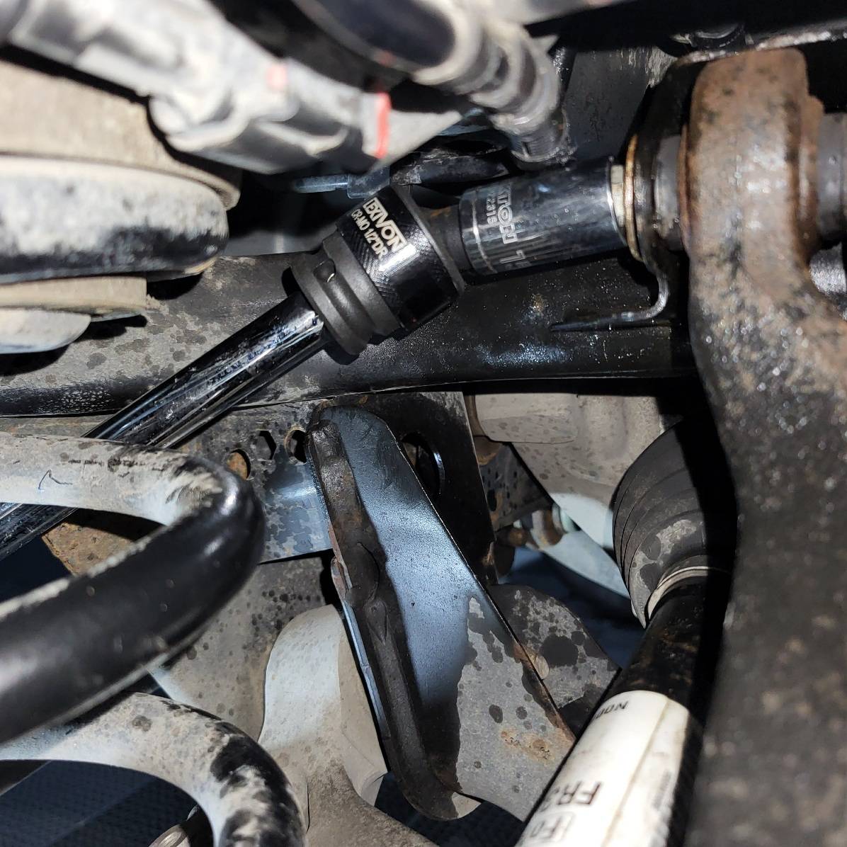

Hey!
Winter is here and so start the mods!
Starting with New camber arms (before lowering).
Outer screw caused no troubles then comes the inner bolt.
It's just not moving. At all.
Hammering it made it out from 1mm but it's clearly not turning. All rusted I guess (pic attached)
Any hints to get this bolt out?

The ears of the mount are spread a little bit and that's pinching the bolt in there. You need to put a small clamp on the outer portion of the mounting ears to get them back parallel and then you should be able to tap or thread the bolt out.

Was able to unlock the bolt using a 15mm socket, a rotating adapter, an extension, and a breaking bar....

After a lot of swearing, it's finally out!

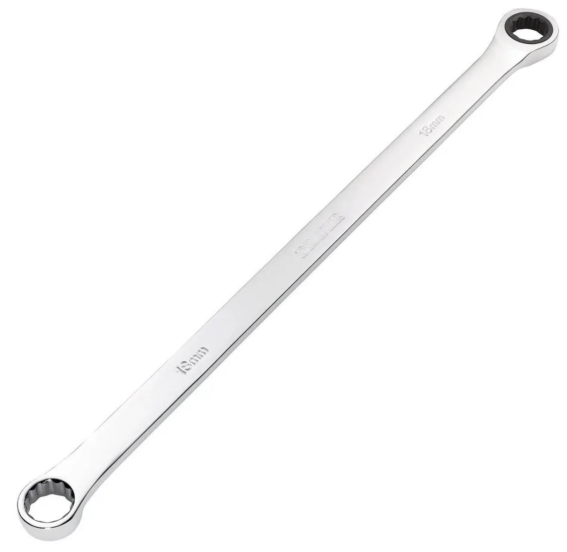

@TeeLew @WItoTX - any recommendations for tools for tightening that bolt ?
I need to hold one side in position whilst I tighten the other (I have camber bolts / J&M adjusters) and I was thinking of using a pair of long reach ring spanner’s :
Am I heading in the right direction, or would you recommend some other assembly of extensions and swivels etc ?

Exactly it. That's about as good as you're gonna get.

@WD Pro, you are on the right track with using the box wrench. In addition, a 1/2” drive ratchet and extension, coupled with an adapter and a long 3/8” extension will make the job go much more smoothly.
When I installed my new rear camber arms, I also installed the supplied bolts from the rear instead of from the front like they came from the factory. This made it much easier to get get the box wrench on the nut to hold it, while torquing it from the rear. I should also add that my replacement bolts were Allen bolts, so I used an Allen socket on the end of the extension.
