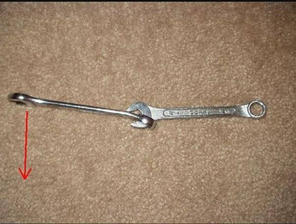

I just adjusted my camber and this is a PITA. Use a second wrench on the 18mm wrench that is on the bolt for additional leverage. Works well.

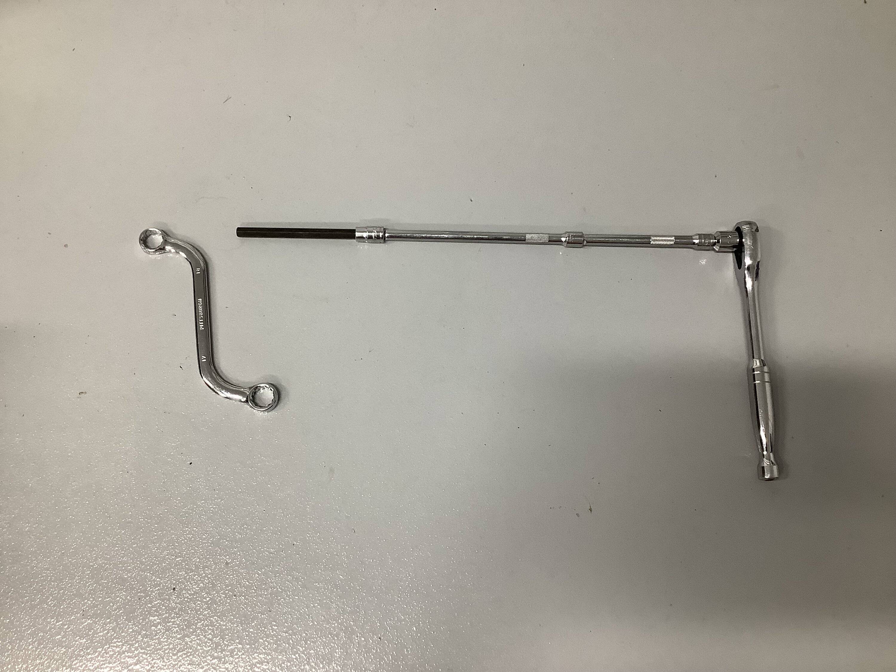

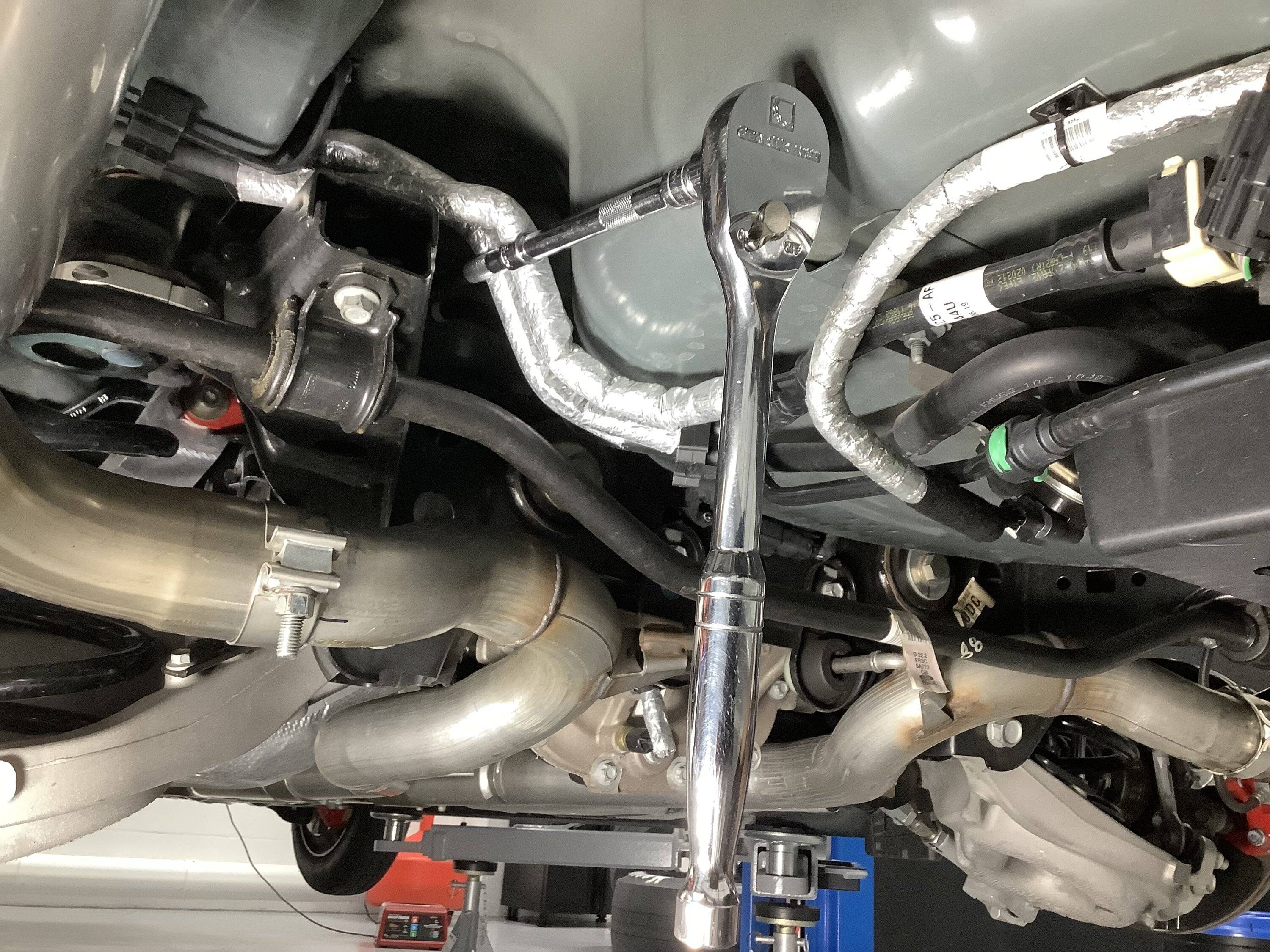

I have BMR supplied bolts in my rear camber arms because they came with the BMR camber lockout kit, but the method of install/removal is still the same. Here are the tools that I used on my car:
- 1/2” drive ratchet
- 1/2” to 3/8” adapter
- 3/8” straight extension
- 3/8” wobble extension
- 3/8” 10MM Allen socket (with My newly supplied bolts only)
I hope this makes sense and helps you to be able to get the job done with ease.
