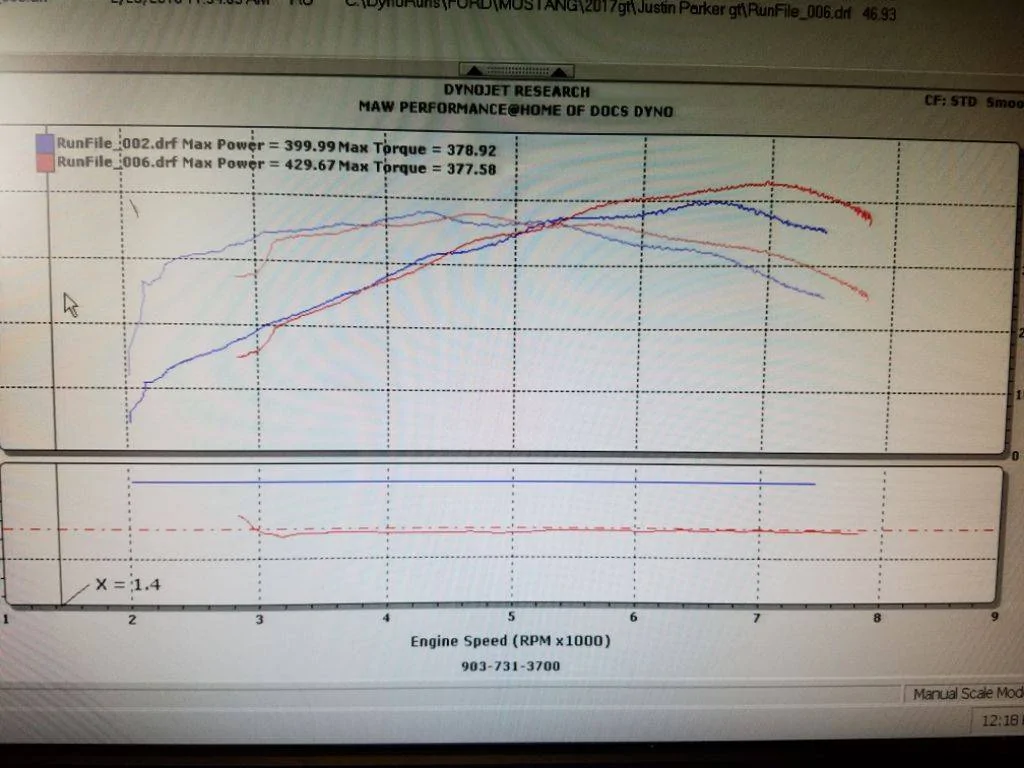

Truck manifold peak is 5500 on oem headers. With long tubes there are a few that dynoed at 5800-6000 for peak (pay attention to other mods listed when looking at dyno graphs). It drops like a rock above 6000. Stock 15-17 manifold has rated power peak at 6750, though some dynos show more like 6500, and the drop off is milder. Still a 1000 rpm difference. 18 GT manifold peaks at 7100-7200 and has very little drop off. There's a massive power difference above 7000.
Not my car, but 18GT vs 15 GT on same car, CAI being only mod besides 93 tune.
