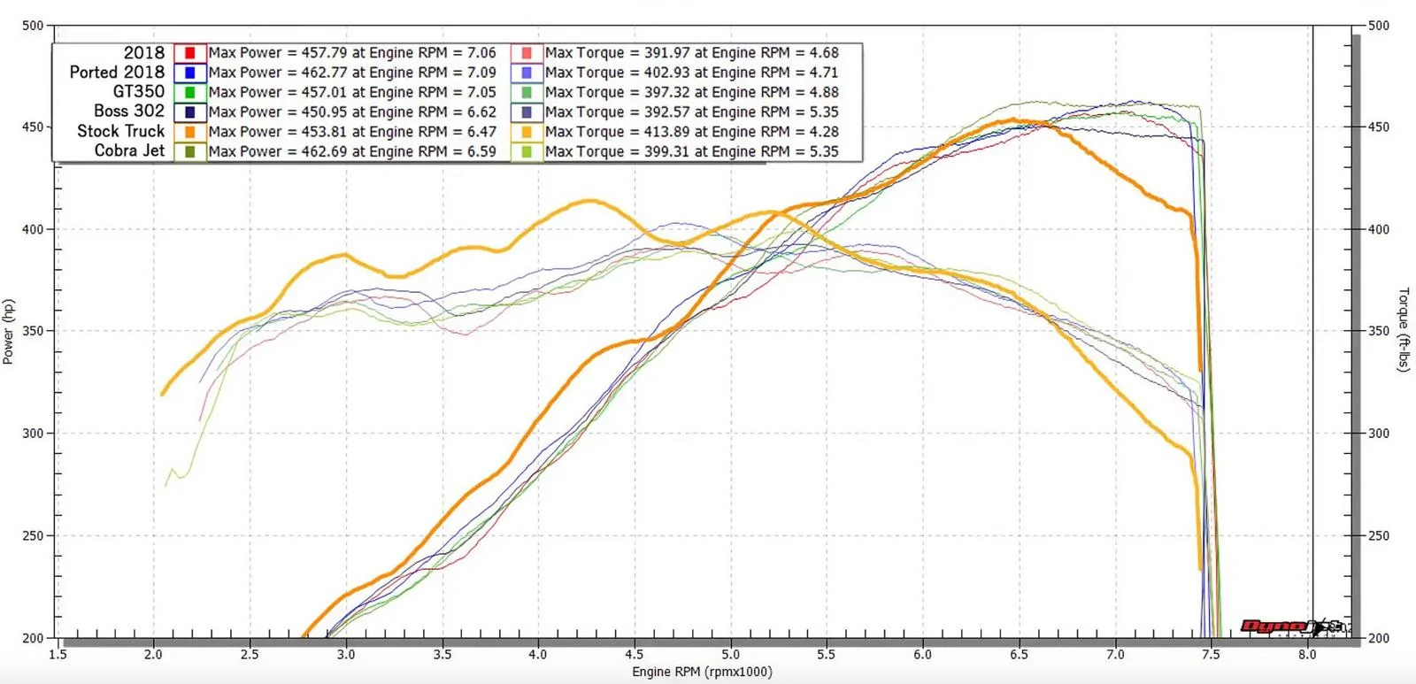

With the '18-'19 F-150 engines, was there a corresponding jump in compression/displacement or any improvements to the cylinder heads like with the Mustang GT 3rd gen Coyote?
If that jump in HP that the graph represents above is only down to an improved intake manifold, then I might have to go that route?

As with the 2015-2017 Mustangs, if you add a 2018 GT manifold, it's not going make the same power as a stock 2018 Mustang, but there will be a jump in power. Same holds true if a 2015-2017 F150 owner adds a 2018 F150 manifold. In other words, there should be a noticeable jump in horsepower and torque if you go from a 2015-2017 F150 manifold to a 2018 F150 manifold on your Mustang.
There are some 2018-2019 F150 owners who have swapped the 2018 GT manifold onto their vehicles and they have had no issues with functionality of the IMRC. Meaning a 2018 GT IMRC adapter/harness for gen 2 Coyotes would be plug and play with the 2018 F150 manifold.
Also, the graph above is a comparison between a 93 octane and E85 tune. Stock F150's dyno in the 345-360 horsepower range. From what I've read, the stock 2018 F150 tune is very conservative, reason being for such large gains when going from stock tune to a 93 octane tune to a E85 tune. But it gives you an idea of what kind of power you can get out of the 2018 F150 manifold. The torque curve is even more impressive than in the 2015-2017 F150.
A combination of porting the F150 manifold and E85 is your best bet at keeping the power respectably flat between 6,000-7,000rpms.
