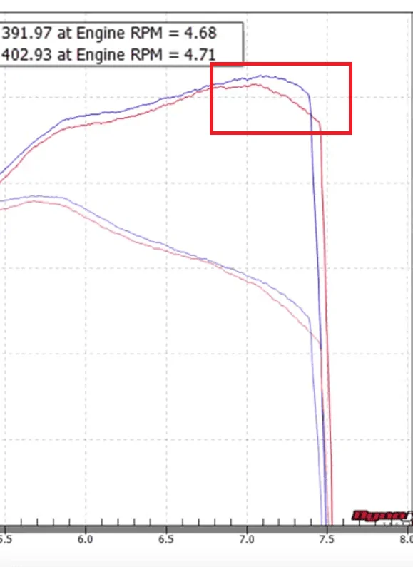

Really makes me wonder if there is a way to fix the 6-6.5k drop off. I feel like it has something to do with the IMRC chambers. =/
Simple...just port the F150 manifold. It should show similar gains that the '18 manifold saw.
In the picture below, you can see the ported manifold carries the power better and doesn't drop as quickly. It also makes the same power at 7300 as the non-ported makes at 7100.
IMHO the ported F150 manifold will carry the power the same as the stock GT manifold (to about 7000rpm) but make more of it and have huge gains down low. For those of us only revving to stock redline and those that live their lives more than 1/4 mile at a time that's the manifold to get. Sure in a pure out drag race the 18 or GT350 or CJ would pull it, but on a road course/autox type car the meaty bottom end torque will make for much more explosive corner exits and the only time the others will be better is on the straight away.
