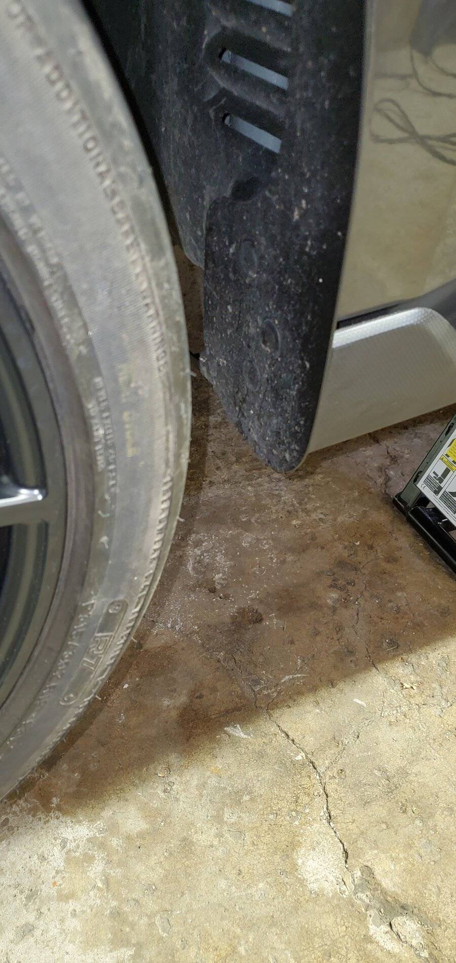

Yup. The ET56. The problem I had was purely because of the Pirelli Ferrari Challange tires I had mounted. Those tires are almost an inch and a half larger in overall diameter than most any other 315/19's. I really wanted to use them exclusively because I have a great local source to get them at a nice price, and they stick like velcro. Best R compound slick I've ever experienced, by a significant margin.
When I removed the Pirelli's and put on Hoosier 315/30/19's, I had no issues at all. I have the little rock guards mounted up front, which reduced clearance by maybe an additional 1/4 inch, but the set-up with Hoosiers doesn't rub.
So to confirm, if you run almost any 30 series tire on these rims, you're golden. Just no Pirelli race slicks from Ferrari World Challenge cars....
The rub issue was on the front of the car, on the back side of the wheel arch. closest to the door. It rubbed down on the bottom by where the side splitter tucks up under the car. Below is a pic. It was in this area, towrds the bottom. Was enough of a rub that it would have ripped stuff of at full steering lock...
Hope this helps
