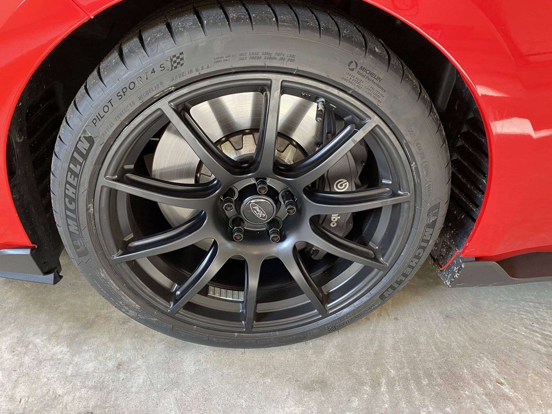

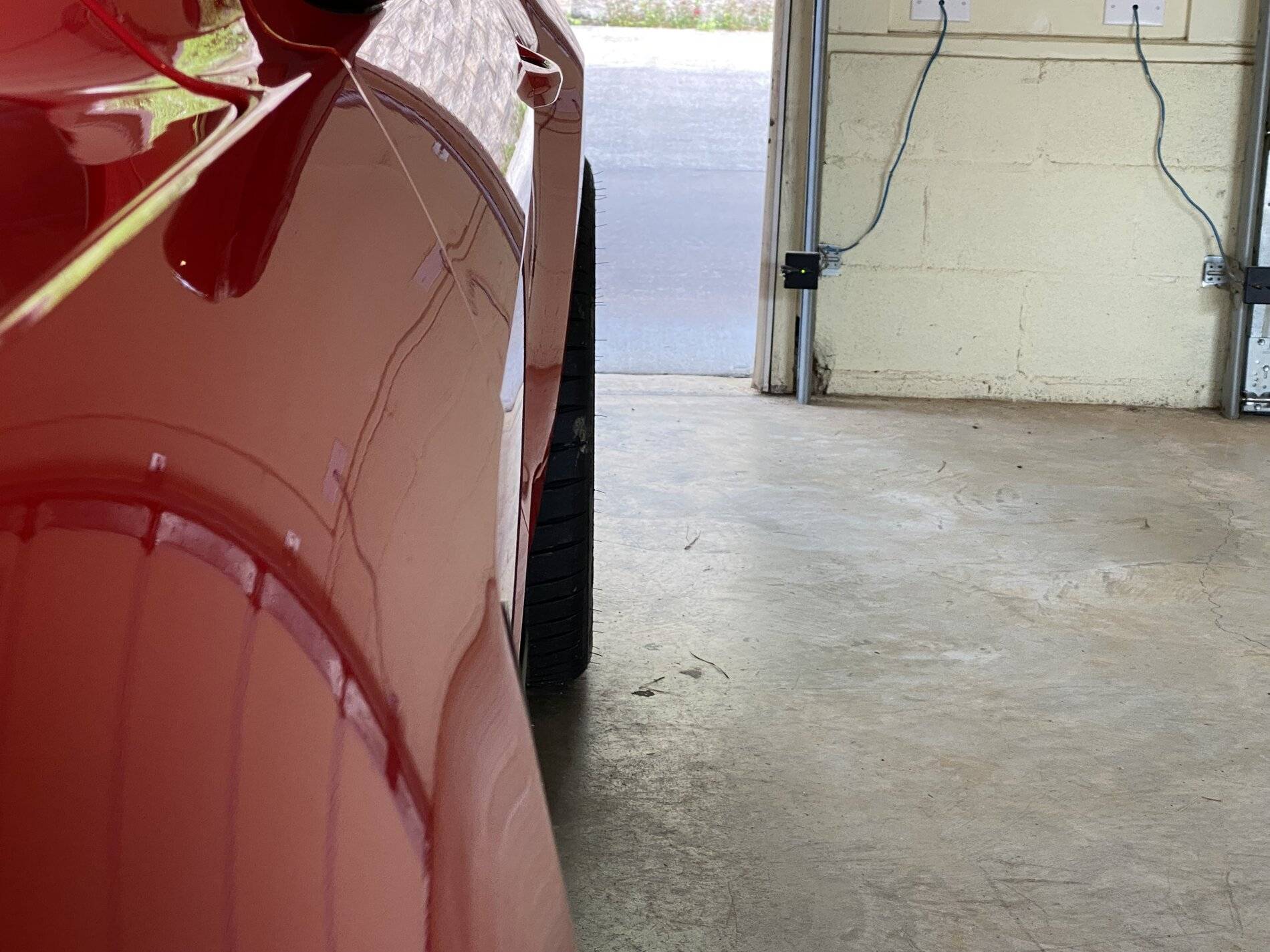

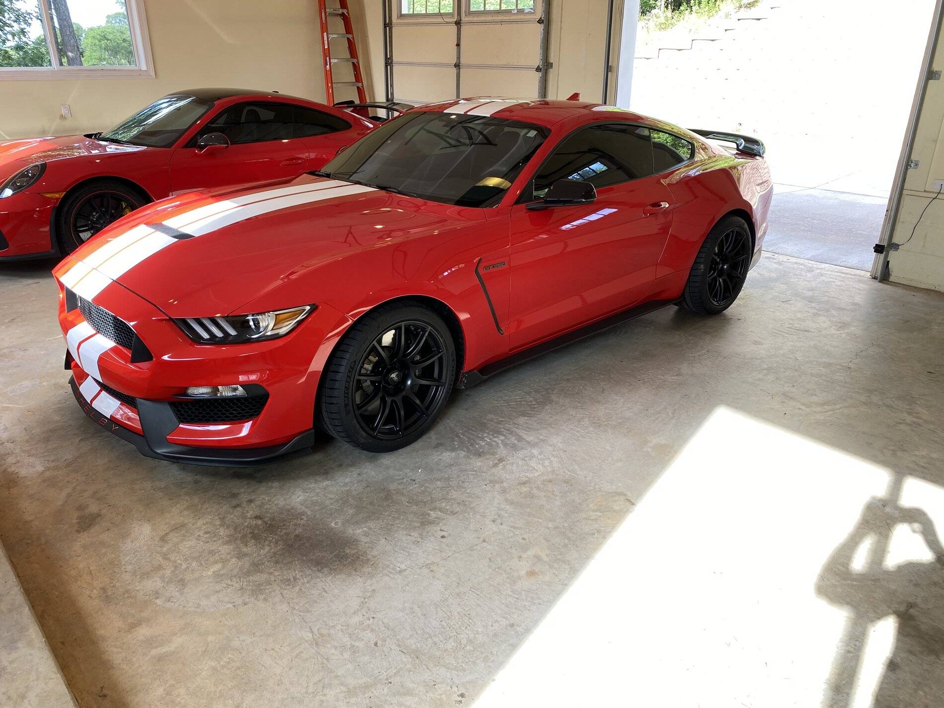

Photos below. Square setup with Apex wheels and 305-30-19 Michelin PS4S on all four corners. 25mm spacers in front, and the tires can be rotated. No rubbing noted so far. I wanted the look to be as stock as possible, and I worried that the 'hollow' lugs would look weird, but the studs are recessed far enough that you don't really see them (they're from ARP and are gold anodized). The rear tires poke out a bit, which I wasn't expecting, but I don't have 'before' pictures to compare to. Overall, I like the look, including the stock Ford center caps. The two biggest changes:
1) The car rides about 0.5 inches lower, because the diameter of the 30 series tires is smaller. I've scraped the front splitter a couple of times in places that weren't a problem in the past. Nothing major, but I have to be more careful with speed bumps and when leaving my steep driveway. Those smaller diameter tires also mean that the gaps in the wheel wells are 0.5 inches larger. I don't like that, but can live with it. To fix it I'd have to put lowering springs on the car, which would make the scraping problem even worse.
2) Tramlining is almost non-existent!!! I've read several posts about the difference between the original Cup 2 and the PS4S, but I was skeptical. I figured that when someone spends that much money on wheels and tires, they want to believe it was worth it. So, I was shocked (really) at the difference. I regularly travel two stretches of road where years of truck traffic have left deep depressions in the asphalt. In the past, I had to be ready, with both hands firmly on the wheel, when I hit those sections. Yesterday I floated right through them, with only very light tugging from the wheel. I could 'one-hand' it with ease. It was awesome. The tradeoff is that the steering has a bit of a numb spot on center. I'm fine with that compromise, but someone looking for 'max attack' on initial turn-in might not like it.
The only other negative was the installation of the ARP studs. They're great products, but the fit was extremely tight. They were a bear to install (so I'm glad I didn't do the work myself...)
Overall, it's a lot of money, but I'm happy with the outcome. The OEM Cup 2s lasted less than 5,000 miles and I hated the tramlining. It took too much joy out of the drive, and I won't miss it. Until Michelin comes out with a 305-35-19 in the PS4S, I will put up with the increased scraping risk and the tire gaps. Your opinion may differ.
