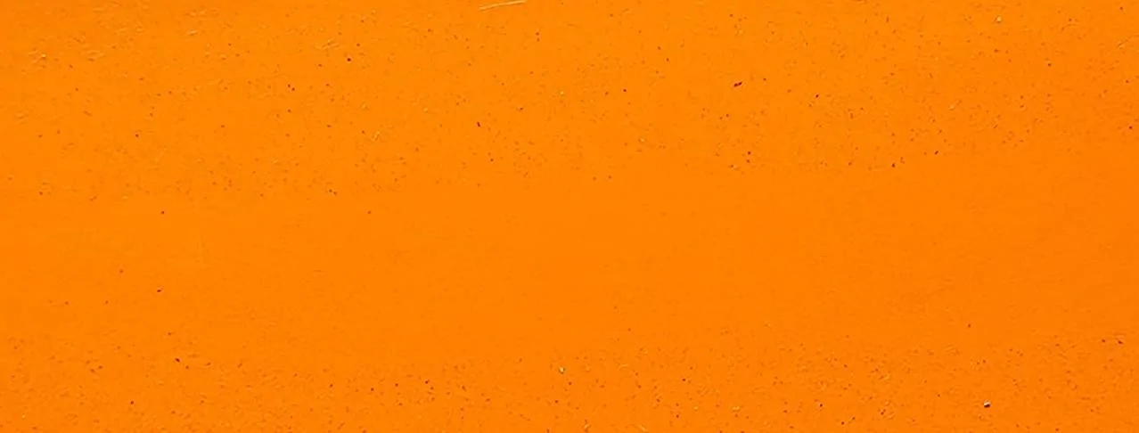

But I've noticed since I've had it, that after even a short drive of say 50 miles, the rear of the car is covered with lots of black dots, which is, for want of a better word, soot from the exhaust.
Attached is a pic of a small section of the rear showing the soot. I ran my finger through the middle to show what a cleaner part looks like.

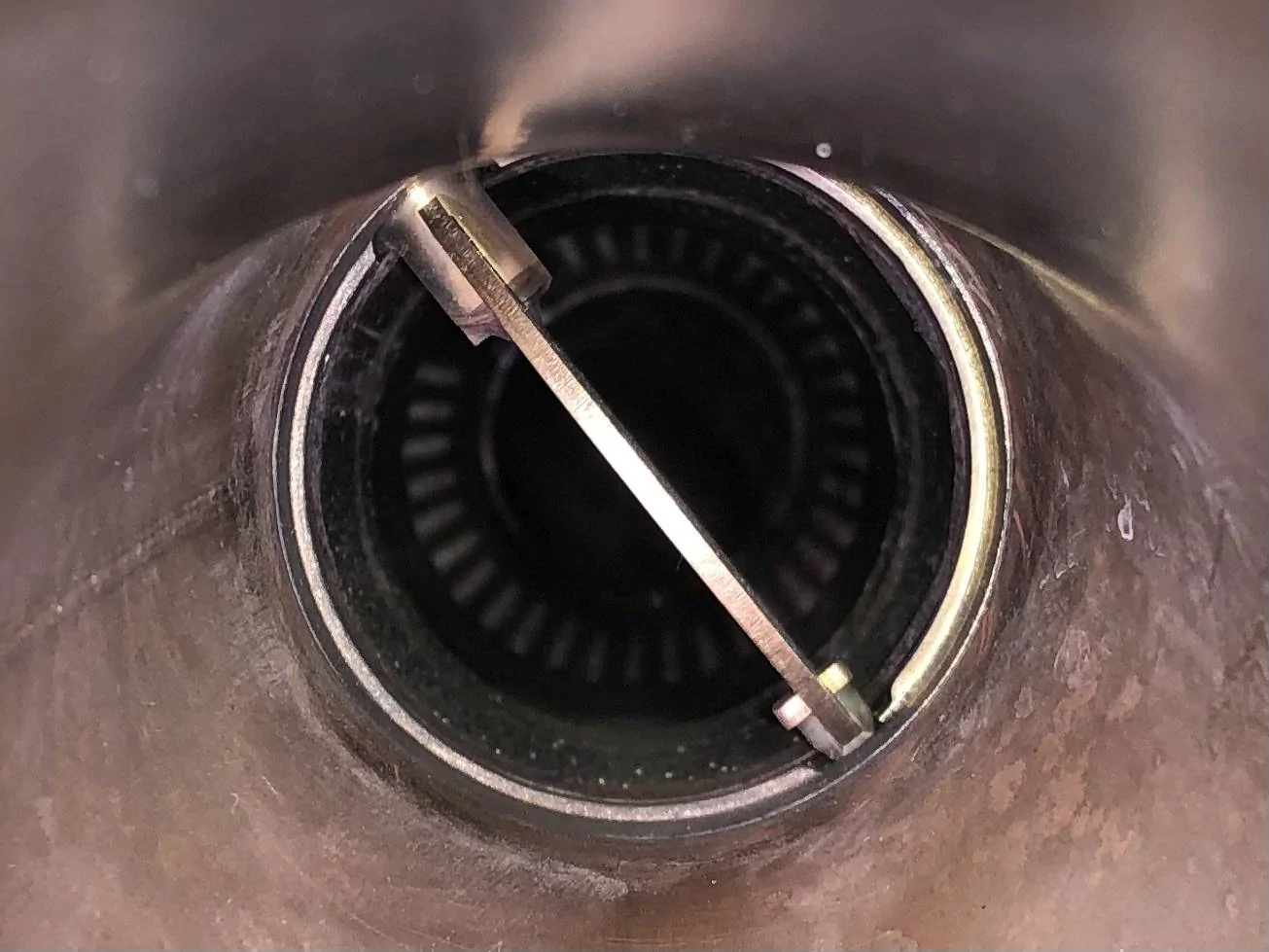

As a point reference, I'm a UK euro (with GPF's) and here's the inside of my mufflers at 2.5K :
